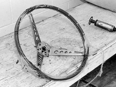

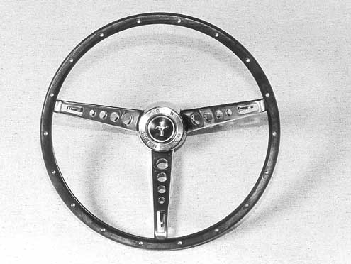

P45606_image_large
The Deluxe wheel that we found at Carlisle looked as though it had been sitting at the bottom of a lake, but the chrome was serviceable and the wheel wasn’t bent. The most important thing to look for in a good core is the condition of the center three spokes, as everything else is replaced.

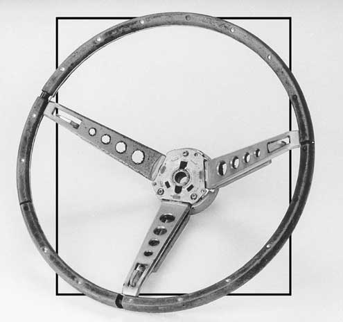

P45607_image_large
Another shot of our Deluxe wheel core shows the most common ailment of these wheels--cracking of the plastic rim. The rim usually will crack at the left spoke, according to Pete Geisler, as this is the path of direct sunlight from the driver-side window.

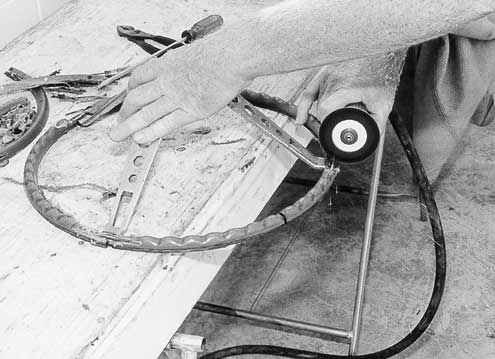

P45608_image_large
Geisler begins by cutting away the plastic rim facing at the three spokes, making it into three, more manageable pieces. The cobweb-looking stuff is what happens to the old plastic as it is cut.

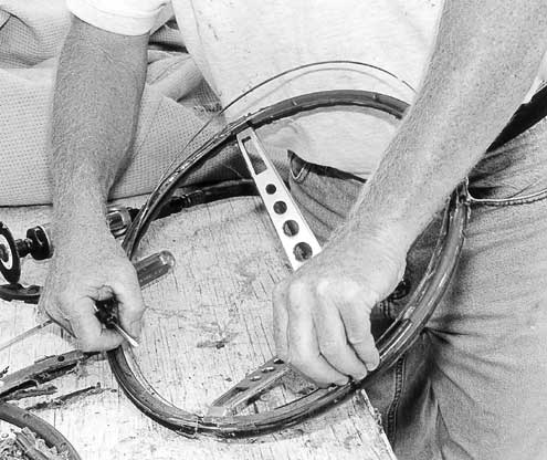

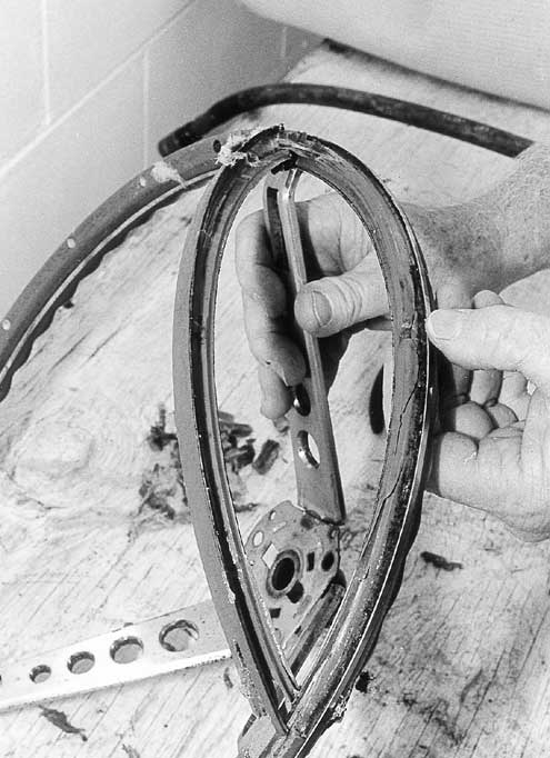

P45609_image_large
The top half of the plastic rim is now carefully pried apart from the main wheelbase plastic. These two items were bonded together at the factory, but have been known to separate after years of use. If your core is in this condition, then it won’t matter. Just make sure the spokes are in good condition.
P45610_image_large
The thin chrome bands on the inside and outside circumference of the plastic grip are carefully removed. These bands won’t be reused in the restoration of the 󈨆 wheel, but Orlando Mustang uses them for other model-year wheels it restores.
P45611_image_large
I had to turn away at this point! Even though the result is a beautiful wheel and Geisler has been restoring wheels for years, I couldn’t watch him take a cutoff wheel to this Deluxe wheel core and simply wack the rim from the spokes.

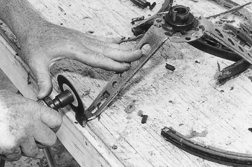

P45612_image_large
Once the rim is completely cut away from the spokes, the end of each spoke is dressed and cut to allow the fitment of the new stainless steel rim before plating.

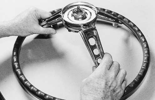

P45613_image_large
The Deluxe wheel is now sent out for chroming and some proprietary finishing processes. When the wheel came back, Geisler installed these beautiful, hand-rubbed, walnut wood rim faces to our Deluxe wheel.

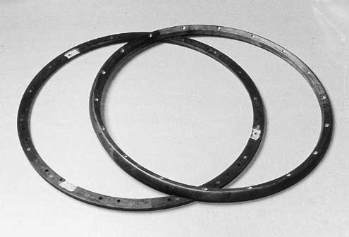

Until recently, these horn contact rings were hard-to-find N.O.S. or good used items. Orlando Classic Mustang has good used rings in stock, as well as rebuilt rings. We used the new reproduction rings from Perogie with zinc plating that Orlando Classic Mustang puts on all its horn rings. The small isolators being installed here are also from Perogie.

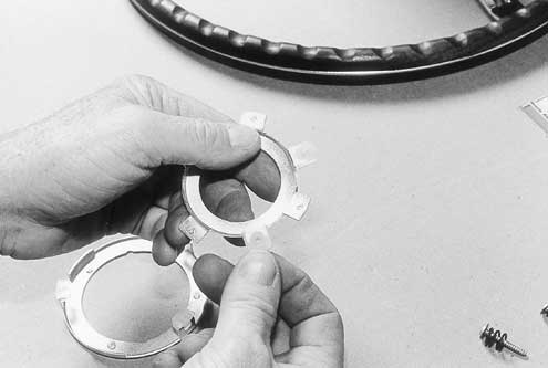

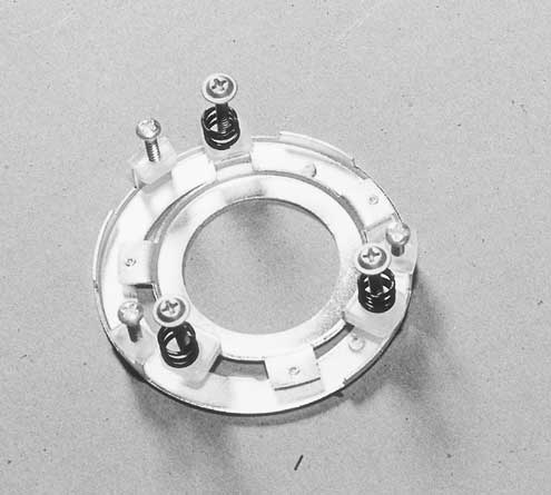

P45615_image_large
Here’s another shot of the two horn contact rings with the isolators and the screws (also from Perogie) in place, as they would be installed on our Deluxe wheel. The biggest problem with Deluxe wheels--besides the cracking rim--are poor horn contacts.

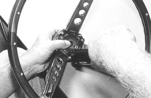

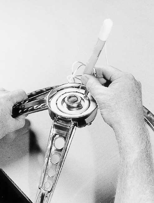

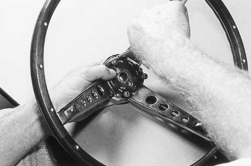

P45617_image_large
Using a continuity tester, Geisler tests for proper horn operation from all three horn spokes. Only one spoke lights up the tester when pushed. This is a common problem on most Deluxe wheels and can be easily fixed during the wheel restoration.
P45618_image_large
Since each wheel is slightly different, Geisler has to check each wheel with the actual horn ring that will be used for that wheel. Sometimes different contact rings will have to be used. Other times a special drill bit can be used to even-out the casting of the horn ring for better operation. Either way, the steering wheel will have to come apart several times to achieve the proper operation.

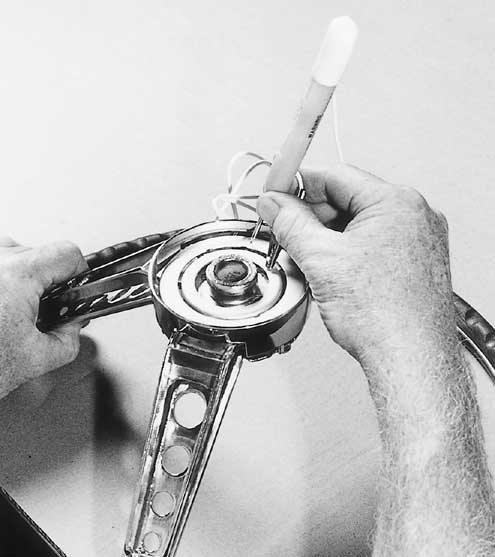

P45619_image_large
Again, the continuity tester is employed to check the horn contact rings. After three adjustments, the horn shows continuity whenever any of the three horn spokes are pushed on the horn ring.

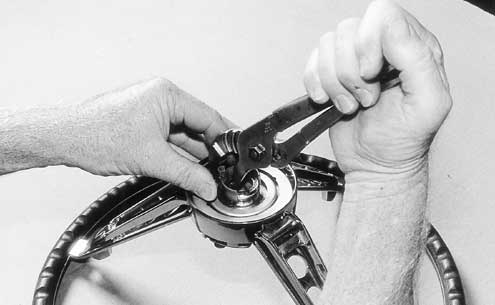

P45620_image_large
The last item to be installed on the back of the steering wheel is the turn-signal cancellation clip. This item is simply snapped on over the hub and positioned to properly cancel the turn-signal operation after a turn is completed.

Walking around the Carlisle All-Ford Nationals show grounds last year, I was giddy with excitement. I had bought a '66 hardtop just three weeks prior, and I knew there were going to be certain things that I had to find while I was at Carlisle to aid in the restoration project. Since we were going to replicate my old '66 hardtop with this new project car, I knew then that it had to have a Deluxe interior, which meant a total conversion. Getting the seats re-covered--which we accomplished in the Feb. 2000 issue--and other items would be no more difficult to find than opening your favorite catalog. But the Deluxe woodgrain wheel--oh, no--that would have to be used or new old stock (N.O.S.), and N.O.S. was completely out of the question. I wasn't about to pay $900 for a steering wheel (three times the price I paid for the entire car, I might add), and then have to explain that to my wife. No, it would have to be used. If I could find a good core wheel, most of the remaining items could be ordered from just about any vendor.
After scouring the aisles and looking at several different wheels, I spotted one in a box with several other '65-'66 woodgrain wheels for the wife-friendly price of only $5! The chrome was lightly pitted, but it would make for a good core wheel.
