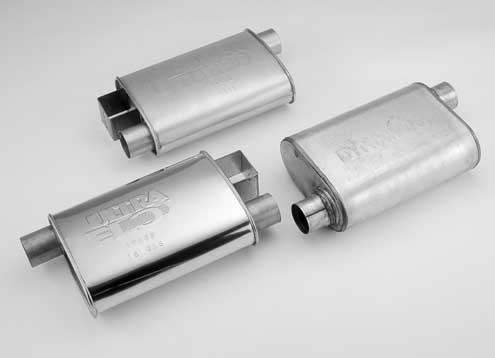

DynoMax's triumvirate of street mufflers includes the Super Turbo (top), the Ultra Flo SS (the pretty one), and the Ultra Flo Welded (far right). Each muffler fits into its own market segment and tax bracket. Prices range from the Super Turbo's $30-$40 entry fee all the way up to the Ultra Flo SS muffler's C-note-plus ticket price. The Ultra Flo Welded (at right) fits in between, at $60 apiece.

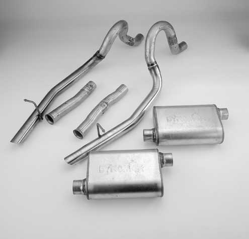

The Super Turbo after-cat in 2-1/2-inch form will provide performance without any additional sound, if every other exhaust component remains the same. Super Turbo systems range in price from $169.99 to $399.99 depending on your Mustang application. The Super Turbo's low price is what gets most people in the door.

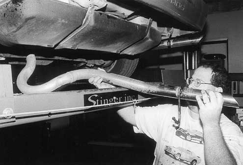

He's not just another pretty face, folks. He's Mark Houlahan, technical editor of 5.0 sister publication Mustang Monthly. Mark "helped" us extricate the stock after-cat and aftermarket mufflers while we held the camera and provided moral support. Actually, since DynoMax makes a lot of the factory exhaust components for Ford, the after-cats went on fairly easily, save for the issues we encountered with the Ultra Flo SS mufflers.

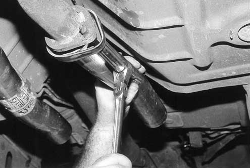

The flow tubes are side-specific so pay attention to which side goes where. Slide the attaching flange on the flow tube and use the factory hardware or new nuts and bolts if the factory stuff is long gone. The factory hardware is much easier to use since you only have to use one hand to tighten things up.

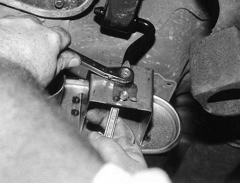

For the Super Turbo and Ultra Flo SS mufflers you can use small nuts and bolts to attach them to the factory hangers.

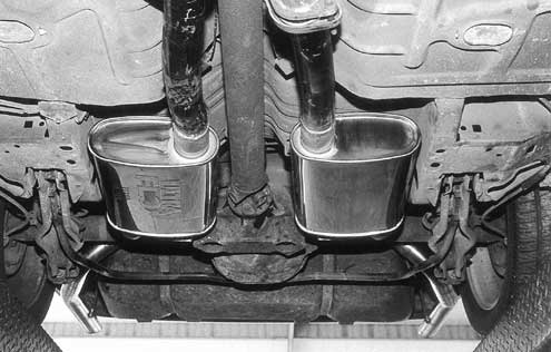

Our DynoMax 2-1/2-inch after-cat with Ultra Flo SS mufflers fit perfectly on our '91 LX coupe and rewarded us with a more authoritative sound and a larger pipe diameter to help prepare it for future engine mods.
