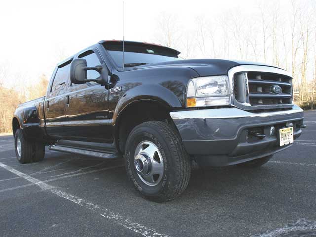

Our '02 F-350 dualie is used mainly for towing our Motorsport 45-foot, fifth-wheel trailer. The chipped-up 7.3 Power Stroke provides plenty of pulling power, but for quicker, safer stops, we decided to upgrade the brakes with Stainless Steel Brakes Corporation's Quick Change Force 10 V-8 braking kit.

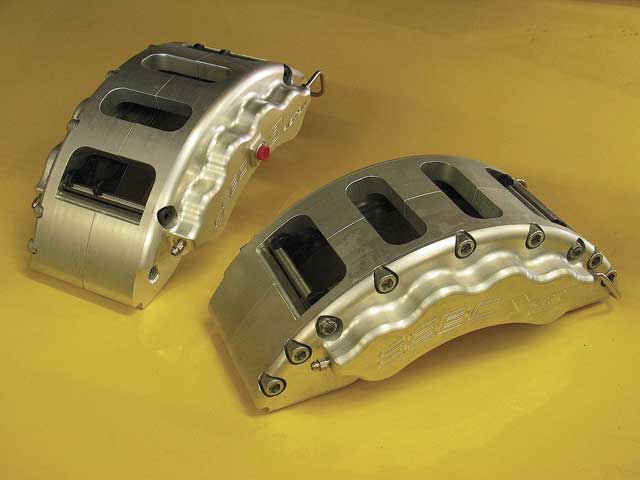

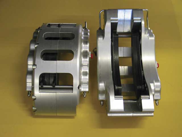

The SSBC V-8 kit (PN A193-1) includes two eight-piston aluminum calipers that bolt directly to the stock location. The retail price is $1,695 for the clear anodized finish (shown), but polished or powdercoating is offered for a few extra bucks.

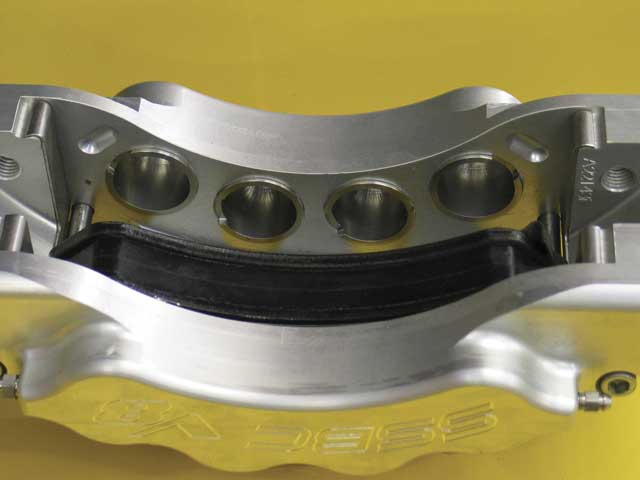

With a pad slid out of the way, you can see the four stainless pistons (there are also four on the other side). Having four pistons per side allows for an even distribution of pressure to the pads. The extra length of the pads provides more contact area and better overall braking power.
