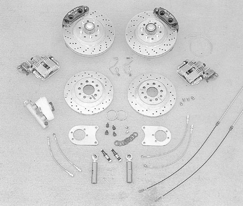

This is the Baer Claw front disc brake kit. Everything necessary to complete the mission is here.

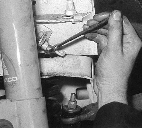

P79324_image_large
First, disconnect the brake line. Cap off the line to keep brake fluid off your paint.

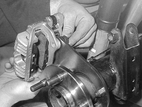

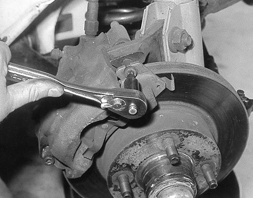

P79326_image_large

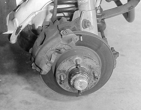

Two Torx fasteners get the brake caliper. Remove these and lift off the caliper.

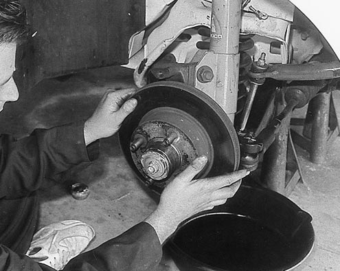

P79327_image_large
Steve Wolcott has removed the cotter pin and the wheel bearings. The stock rotor pulls straight off.

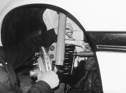

P79328_image_large
Support the coil spring with a spring compressor or floor jack before doing any of this. An uncontained coil spring can maim or kill you. The stock spindle has to go. Remove the tie-rod end.

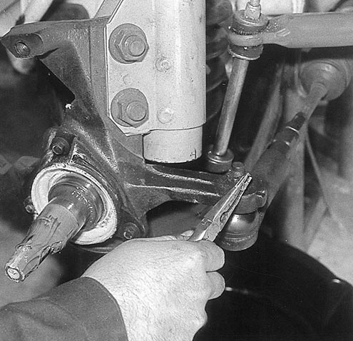

P79329_image_large
Disconnect the lower ball joint and the McPherson strut.

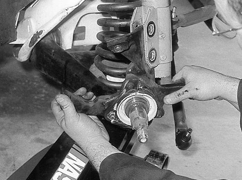

P79330_image_large
Remove the spindle.

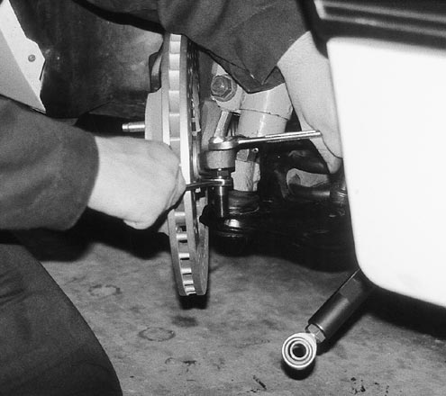

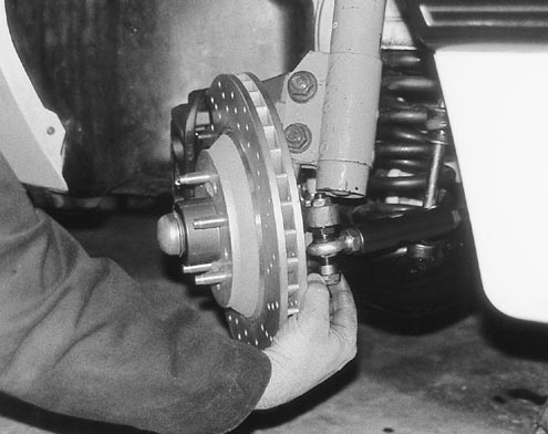

P79331_image_large
The new spindle/Baer Claw combo installs with ease. Connect the lower ball joint, tie in the strut, and install the new tie-rod end. Torque the fasteners and cotter-key them for safety.

P79335_image_large
Connect the tie-rod end to the Baer adapter.

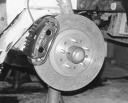

P79336_image_large
Big Baer Claw disc brakes provide unequalled stopping power.

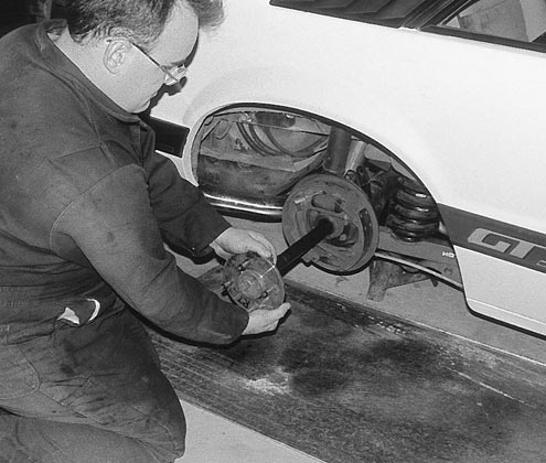

P79337_image_large
The rear disc brake conversion begins with pulling the differential cover and removing the rear axle C-clips that retain the axles. Pull each axle.

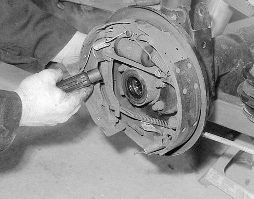

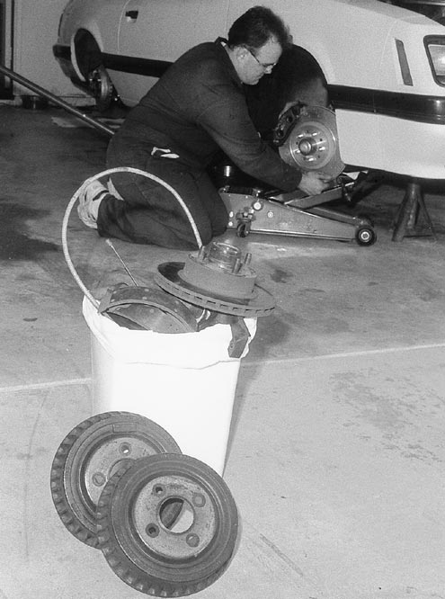

You can disassemble the stock rear drum brake, or it can be removed as an assembly.
P79339_image_large
Disconnect the brake line at the wheel cylinder, and then remove the backing plate bolts. The backing plate is removed next.

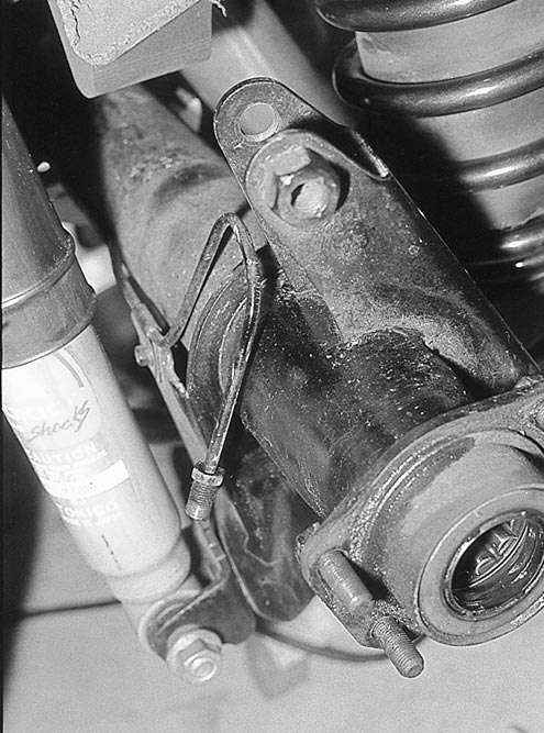

P79340_image_large
The drum brake steel line should be adjusted for connection to the Baer Claw disc brake.

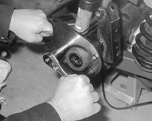

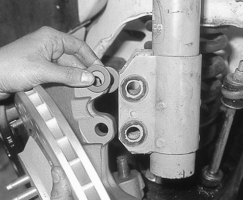

The Baer Claw caliper bracket installs using the drum brake backing plate bolts.

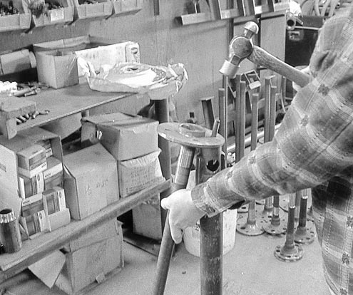

P79356_image_large

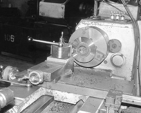

In the case of our five-lug brake kit, each axle shaft has to be modified for five-lug operation and Baer discs. Knock out the old lug studs first.
P79357_image_large
A machine shop can machine the axle flange and drill for five-lug use. Go extra-long on the studs.

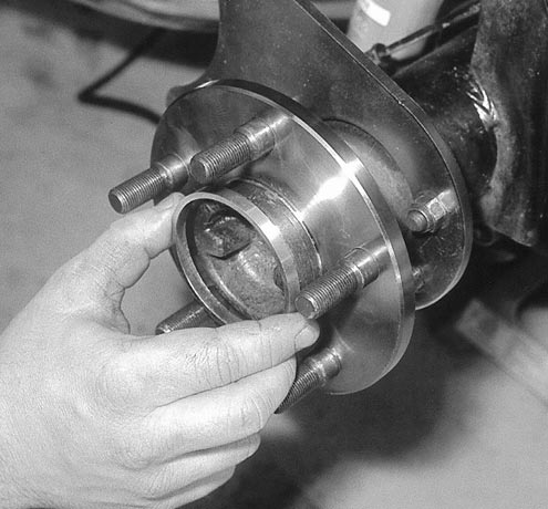

With the axle shaft reinstalled, fit the disc spacer in place.

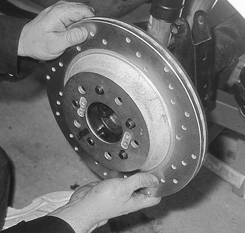

P79360_image_large
Wolcott installs the Baer rotor, and then checks the clearances.

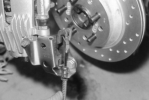

The brake hose...

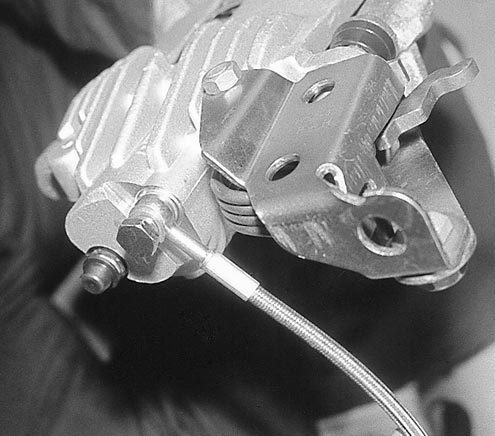

P79362_image_large
...and parking brake cable attach to each caliper.

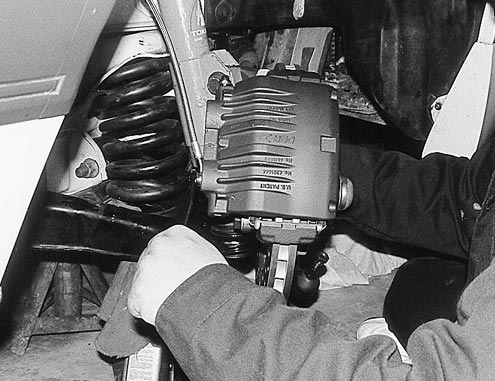

P79363_image_large

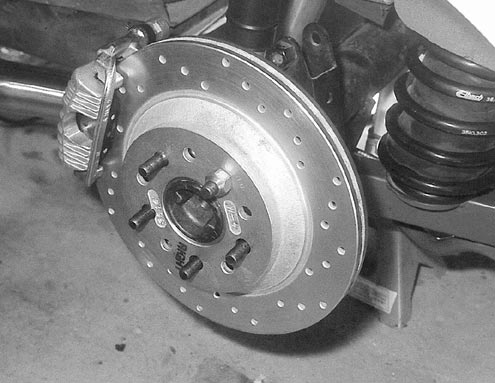

We have removed the brake rotor to show you how the caliper attaches. The rotor, of course, goes on first.
P79367_image_large
Don’t forget to bleed your Baer Claws for maximum stopping power. The completed Baer Claw rear disc brake looks sharp and vastly improves stopping power.
