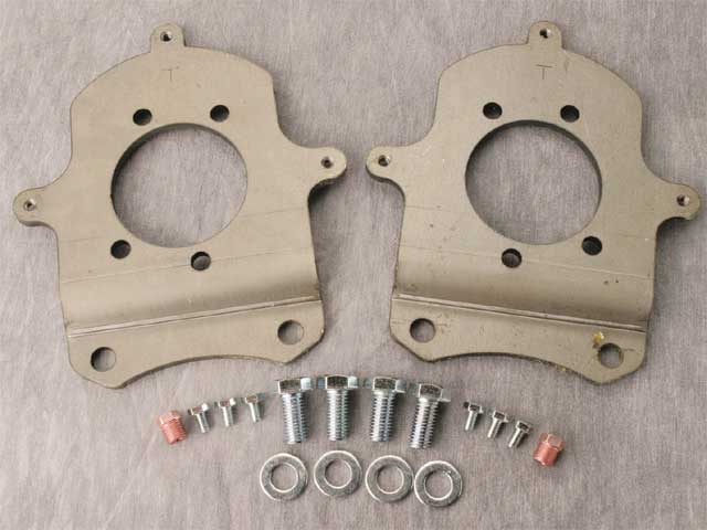

This is the same package Gene installed on his coupe, but he used a'94-'95 Mustang rear axle, which made it that much easier to adapt therear system to his car. We didn't have the luxury of using a '94-'95rear, so we had to come up with plan B. This led us to North Racecars,which we stumbled upon while checking out Matt Bobbitt's Mustang brakeWeb site. Using the information gathered from Matt's site, we decided touse SSBC's '94-'95 Mustang GT upgrade kit, which includes 12-inch rotorsand single- piston calipers (also powdercoated red). As with both thefront and rear, the rotors were treated to SSBC's directional vaneventing and Xtra Life plating.
In order to use this '94-'95 Mustang rear upgrade kit, we used NorthRacecars' caliper brackets, which North owner Richard Oben designed andimplemented on many of his customers' Cobra kit cars. Richard's FactoryFive Racing customers who had used a Fox Mustang donor car to buildtheir Cobra needed larger brakes out back as the stock binders weremerely adequate. He designed brackets to convert both '94-'98 GT andCobra Mustang brakes to a Fox 8.8. We obtained a pair of the GT bracketssince the SSBC kit uses an adapter to fit the larger rotor and caliperonto the stock '94-'98 rear axle. Basically, when all is said and done,we'll have a Fox-length rear axle with SN-95-style disc brakes, thanksto the North Racecars brackets.

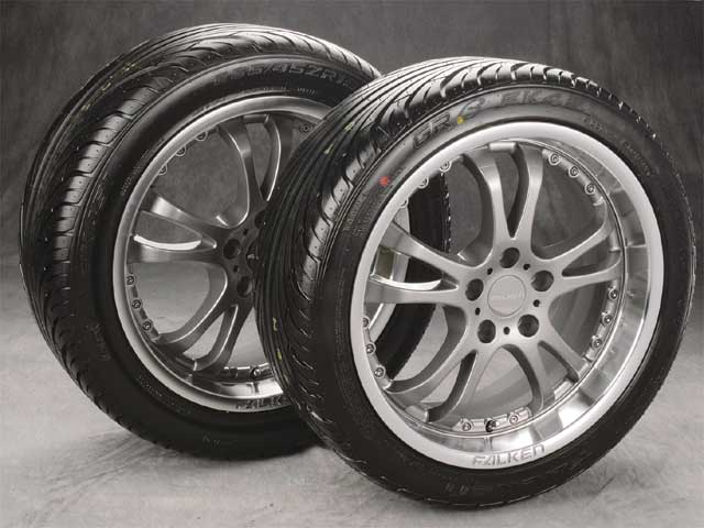

The reason we went after such big brakes was because we wanted to dosomething different with the car's tire and wheel package--and thatwould involve Falken Tire Corporation. For an easy one-stop shoppingexperience, we got Falken's new Torque 5 18x8 wheels with its FK-451tires in 245/40 up front and 255/45 out back. Going to a five-lug brakesetup opened up our coupe to so many wheel choices, we couldn't make upour minds. Believe it or not, 5.0&SF feature car owner and SuperStallionof the Net Photoshop legend Julian Moore took a profile photograph thatwe had of the car and electronically installed several wheels on the carto help us decide. Out of all the Photoshop jobs, the Falkens looked thebest, so that's whose phone rang with us on the other end. We're sureyou'll agree with our choice as you look at the finished photos.

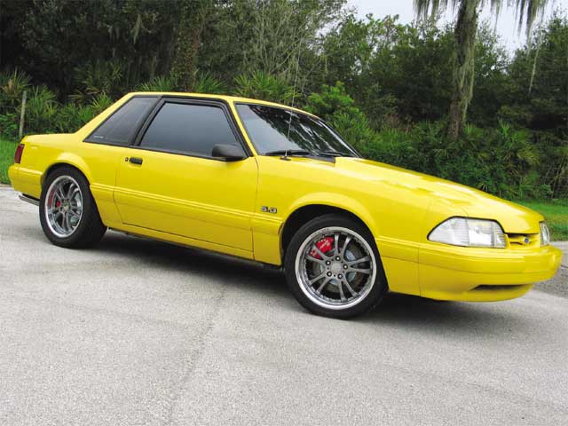

138_0501_z Ford_mustang_coupe Right_front_view
It's hard to believe this used to be a lowly four-cylinder coupe. Fromevery direction, the car's looks have improved tenfold with the additionof the bigger Stainless Steel Brakes Corp.'s brakes and the Falkenshoes. We think the red SSBC calipers and the Falken Torque 5 wheelswith their anthracite centers and polished lips provide just the rightamount of contrast to make a nice street car out of our coupe. Now wejust need to make it fast to match the exterior.

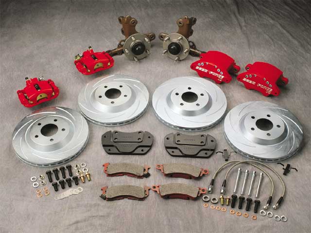

138_0501_brake_1_z
We've had luck with Stainless Steel Brakes Corp. on past Mustangs, sowhen we decided to upgrade the brakes on our current Fox coupe, we againchose SSBC, but this time we stepped up to the Super Twin front brakekit (PN A112-9; $1,220). This kit includes new spindles, rotors,calipers, and all mounting hardware. Be aware that the Super Twin kit isdesigned for use with 18-inch wheels. The SSBC rear kit we chose isactually a '94-'95 Mustang GT upgrade kit (PN A112-4; $740) designed toenable SN-95 owners to run a larger rotor for increased braking power.It includes new rotors, calipers, and mounting hardware. SSBCpowdercoated the calipers red to give the coupe a nice color contrast.We thought Gene Wilson's coupe ("Screaming Banana," June '04, p. 44)looked wicked with the red calipers, so we decided to copy our boy.

Converting the car to five-lug opened us up to a million wheel designs.OK, maybe not that many, but you get the idea. Still, we lost sleepdeciding which wheels to use. We wanted something different but cool. Wealso wanted something to contrast with our coupe's yellow paint and thered calipers from SSBC. Thanks to a little Photoshop work by our buddyJulian Moore, we chose Falken Tire Corporation's Torque 5 wheels in size18x8. We also had Falken mount the wheels with its FK-451 treads. Weordered 245/40 treads up front and 255/45 for the back. If we had to doit over, we would've used 245/40 shoes all the way around because the255/45-series tire sidewall looks really big when compared to the 245/40up front. Nonetheless, the FK-451 is an all-season performance tire thathooks on the street but still provides excellent road manners and littleroad noise.
138_0501_brake_3_z
We wanted to use larger rear rotors than what SSBC listed for '87-'93Mustangs (10.25 inches), so we had to become crea-tive. While checkingout Matt Bobbitt's Mustang brake Web site (mjbobbitt.home.comcast.net/mustang/5lug.html), we found a link to North Racecars,which specializes in building kit cars, especially those from FactoryFive Racing. North Racecars' Richard Oben found that many of hiscustomers wanted more braking performance from their cars and that thestock Fox 8.8 binders weren't cutting it. So he designed and madebrackets that allow you to add SN-95 GT or Cobra brakes to an 8.8 rear.Since the SSBC rear kit was an SN-95 GT upgrade, we surmised North's GTbrackets would make everything work together and give us the largerrotors and increased braking power we needed.

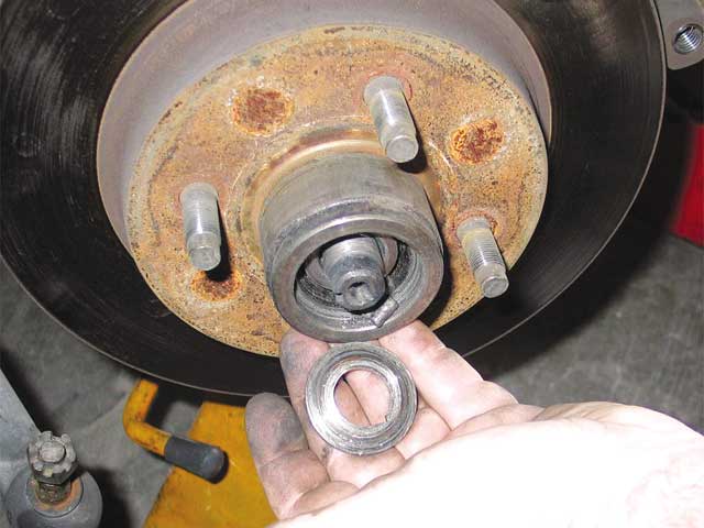

We were hoping to upgrade all the brakes at the same time, but prior tothe swap, our front wheel bearings began making noise. Well, wouldn'tyou know the noise progressively became worse, until it felt as if thefront wheel was going to come off. Checking out the spindle showed thething was toasted--literally. We limped the car back to our tech shop,and Tech Editor--sorry, Senior Tech Editor--Mark Houlahan swapped outthe fronts with the SSBC front kit. We were lucky the SSBC parts werealready in our possession because the spindle definitely neededreplacing. Even with just the SSBC brakes up front and the stock drumsout back, braking power was greatly improved. But with the Falken18-inch wheels up front and 15-inch Weld Draglites out back, we weren'texactly pimpin' it--more like bulldoggin' it, as we say in the South.
138_0501_brake_5_z

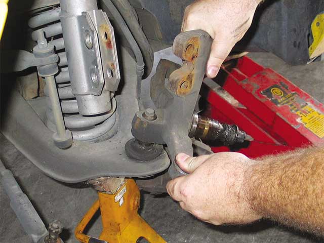

Mark removes the stock spindle from the front strut and the lowercontrol arm. The SSBC front kit includes new spindles.
