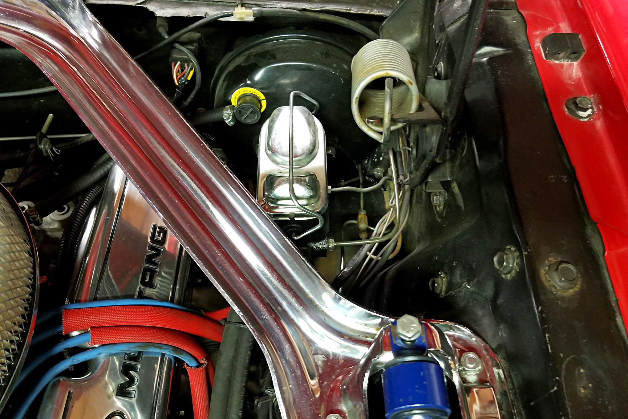

As for the power brake setup, I am currently in the process of converting yet another undersized Chinese brand-X brake booster over to the Mustang Steve booster conversion (mustangsteve.com). The off-brand booster setup was wrong from the start—not enough booster (8-inch dual diaphragm) and the ratio to the pedal was all wrong. The original Ford booster had a bellcrank behind the dash to help with the pedal ratio—so running the booster pushrod direct to the original pedal mount position just doesn’t work. The brakes don’t engage until the pedal is almost to the floor.
Mustang Steve’s kit is engineered using a properly sized 9-inch booster and relocated pedal pin position. The result is brakes that actually work and fit without hitting the shock tower for the dual bowl conversion. I’ve done a half dozen conversions from a bad booster to the Mustang Steve setup and I highly recommend it. And you can buy the whole setup from them or they will sell you the modification plans to do it all yourself.
