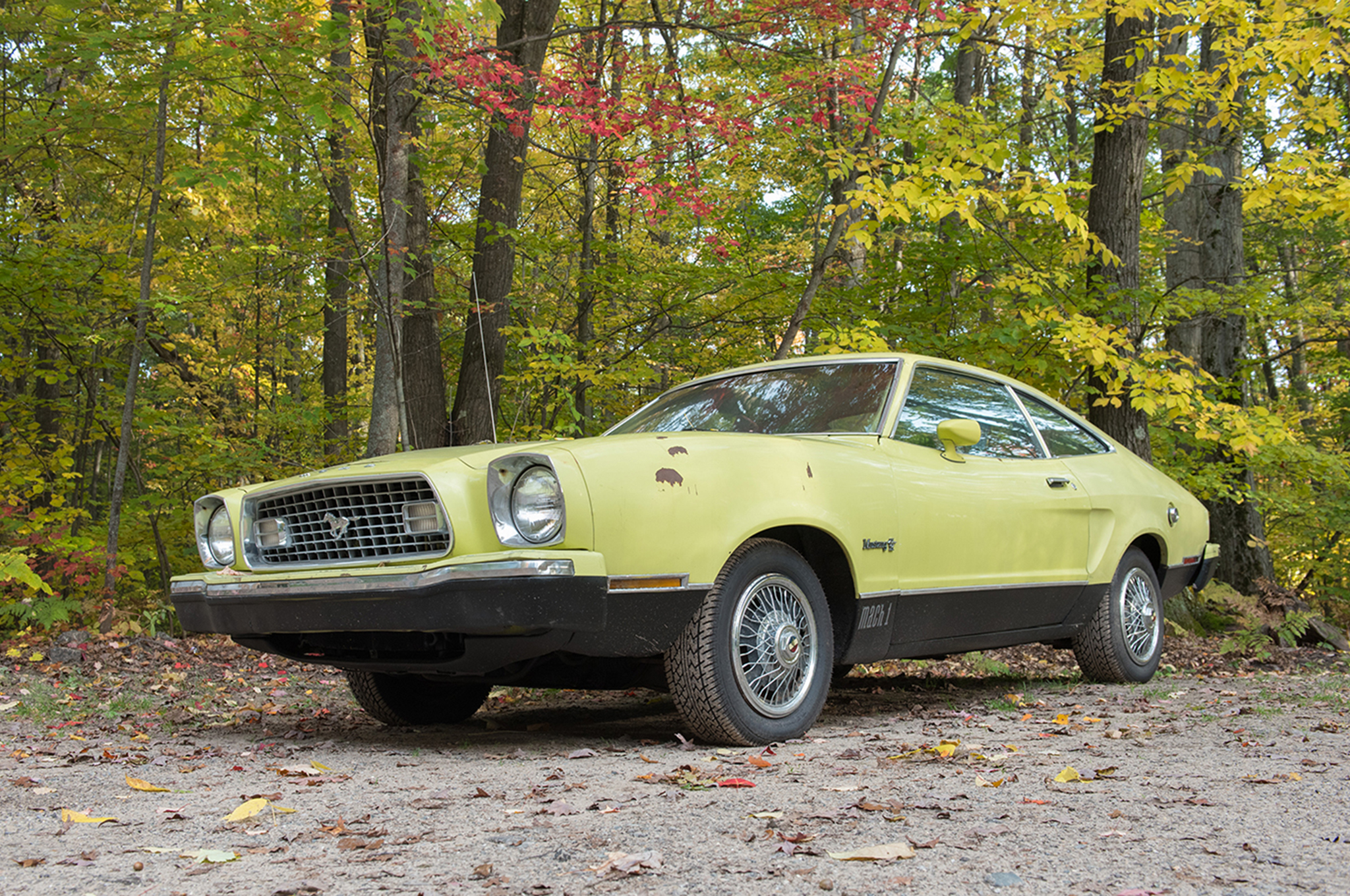

Mustang II Parts
I really enjoyed reading Rob Kinnan’s story about the road trip in Rodney, the under-appreciated Mustang II. I know first-hand how hard it is to find parts for my 1976 hatchback (302 with a four-speed). I can’t seem to locate motor mounts or clutch assemblies for it. Any help would certainly be appreciated.
Dave Hogan
Via the Internet
The clutch, motor mounts, oil pan, radiator, and a slew of other items are unique to the V-8 Mustang IIs. Unfortunately, the platform just wasn’t strong enough to get the aftermarket parts rolling and have any legs to hang around. I did a heavy search and checked with my II gurus and came up empty. For the motor mounts, the best option out there right now is to rebuild the originals that you have. (If you don’t have them, you’re going to pay dearly for replacements, so originals seem to be the best option.) You can rebuild the original mounts using a urethane insert designed by Brett McHugh and marketed through SSC Enterprises in the United States (sscenterprises.net). SSC also has an eBay store where you can purchase the inserts. Just reuse your original upper and lower metal parts with the inserts.
There are a couple of popular options for the clutch. It’s a smaller 10-inch clutch, similar to the Fox body setup. If you still have your old clutch or want to keep it all original, you can get it rebuilt as long as it is not too bad. Fort Wayne Clutch and Driveline (fortwayneclutch.com; (800) 258-8243) can rebuild your original clutch if the pressure plate is not too far gone. Rarely do they have one in stock, so plan on getting yours rebuilt. If you are not too worried about originality, the current popular option is to machine your flywheel to the Fox body bolt pattern. Any competent machine shop can do this for you, and after it’s in, you can choose from a variety of clutches.
