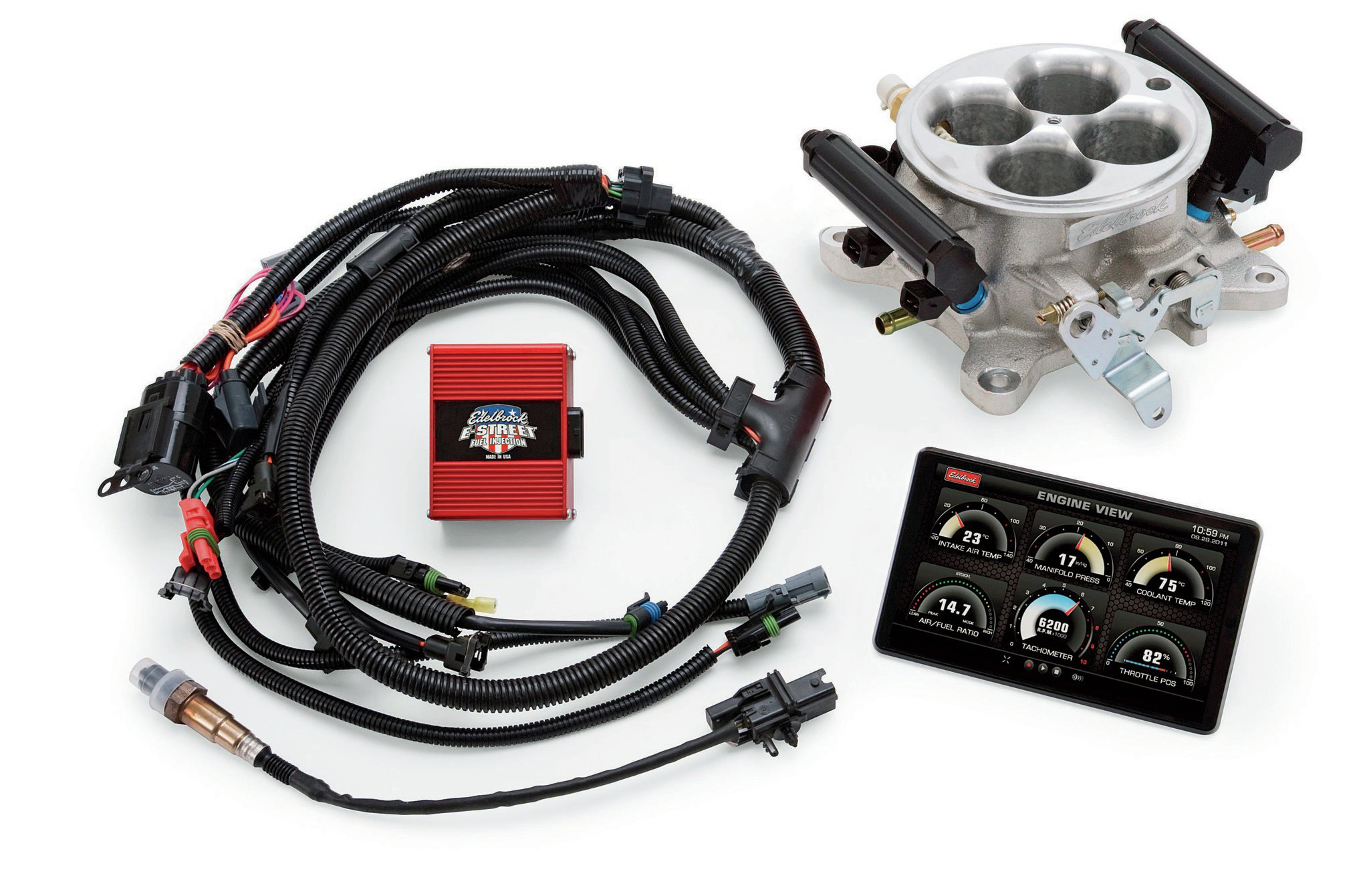

Robert, you’re my kind of guy. Did you take the southern route or Route 66? We need to chat. Most of what you have described above is pretty straightforward and doable. And 460 hp in a 408 stroker is very realistic, and most reputable builders can set you up no problem. My advice on this engine build is fuel injection. If you want to match the late-models, you want to run EFI; preferably one with mass air capabilities. Just because you’re running a pushrod engine doesn’t mean you can’t take advantage of modern controls and modern ignition. Check out Pro-M Racing (www.promracing.com/pro-m-efi-engine-management-systems/ford-complete-efi-systems.html) or Edelbrock (www.edelbrock.com/automotive/mc/efi) for their systems.
