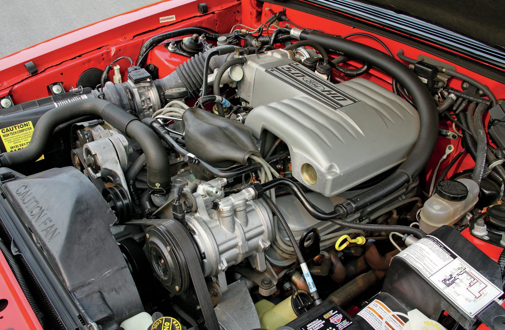

Fox Four Swap
I have a ’91 Mustang notch, but it is just the four-cylinder model. I am thinking about converting it to a 5.0L drivetrain. I have a line on a wrecked ’92 GT convertible I could get for cheap. Can I just swap over the complete drivetrain from the GT to the four-cylinder and not have any issues? The GT is also an AOD car and I really would like to have a manual trans with my swap. I’d appreciate any help you can offer. Thanks!
Dave Milliken
Via the Internet
Swapping the drivetrain from the GT into your four-cylinder notch is truly a bolt-in swap, but we must caution you, it’s not just about the mighty 5.0L engine here. We recommend buying the donor car outright so you have everything you need. Once you get the cars side-by-side you’ll start to see more differences, such as fuel and brake line routing, suspension, brake booster, rear axle, and more that are different between the four-cylinder and the V-8 models. The convertible also differs slightly in spring rates, but should work on the coupe fine. We’d recommend swapping over the complete ’92 drivetrain (engine, trans, rear) along with ALL of the V-8’s wiring (not just the engine management) so that the ’92 “thinks” it is all still there wiring wise. Tape flag or tag ALL wiring as you remove it so you remember what the connectors are for. Once you have your ’91 coupe up and running with the conversion THEN swap your five-speed in. This way you’ll know going in that the car runs and drives fine before doing the trans swap. You can get a complete five-speed Fox conversion kit from numerous sources, including Modern Driveline (www.moderndriveline.com).
