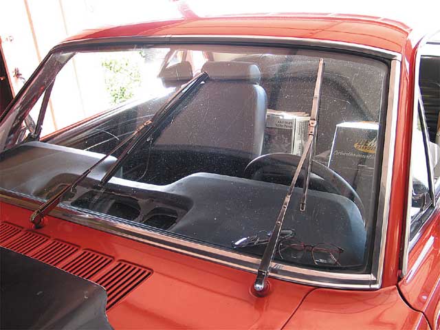

If you never drive your classic steed in the rain, it might not make adifference to you if the wiper motor works or not. But this daily-driven'65 coupe is a car that won't melt in the raindrops, so when the motorgave up and left the wipers like this, it was time to crawl underneaththe dash to replace it.

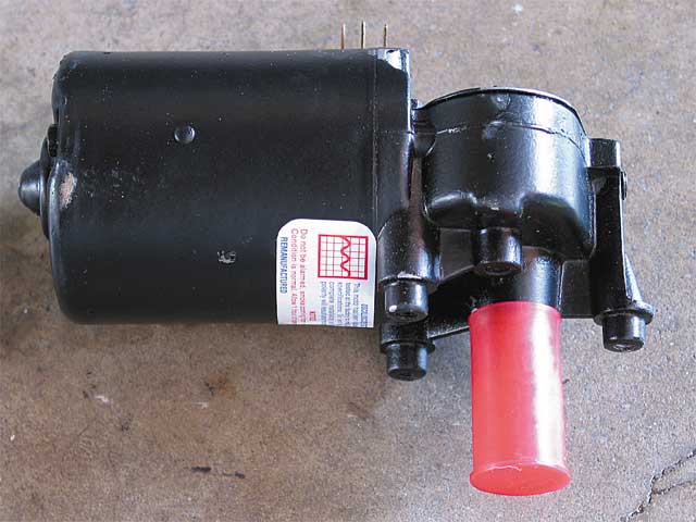

1. Need a new wiper motor? Get it from Mustangs Plus, a shopwhere you could probably build a brand-new '65 Mustang from thecompany's 290-page catalog. A rebuilt single-speed motor for '65-'66s,as shown here, carries PN 02910. A new two-speed motor for '67-'68scarries PN 02914, while a rebuilt two-speed unit for '67-'73s isavailable under PN 02913.

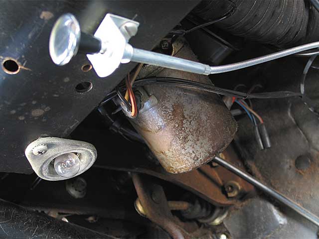

2. On an early car like this '65, the motor is accessibledirectly underneath the dash to the left of the radio. While it's easyto see, getting to it is a little tougher. Removing the driver seat inyour car--like we did--will make it easier on your back while you're lyingdown inside the car looking up under the dash.
