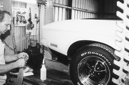

Make sure the entire body (inside both the fender edges and the door areas) has been degreased prior to applying the stripes. If you don’t, your stripes will blow off at speed. Pretty cool the first time but, on the whole, a bit expensive.

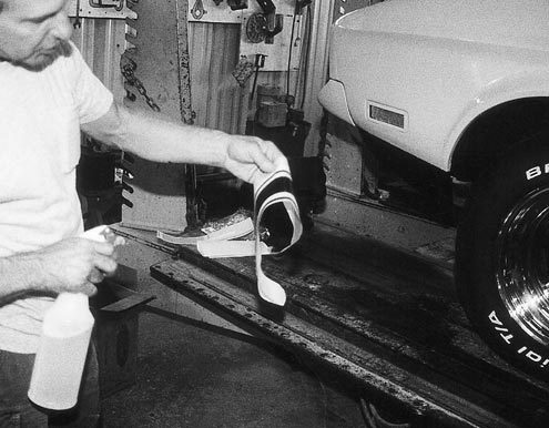

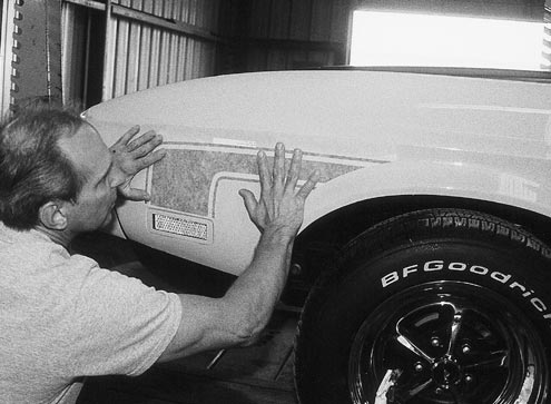

Mike Paremsky uses a mix of soap (about 20 percent soap) and water to spray the panel. This mixture will keep the stripe fluid for positioning.
P98318_image_large

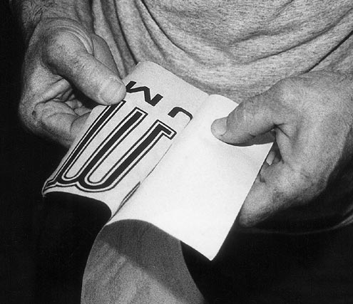

Paremsky also sprays the appliqué after he removes the protective backing. This assures that he will be able to move the stripe into the correct position without it adhering to the panel before he’s ready for it to permanently adhere.
P98319_image_large
Paremsky begins by positioning the front upper and lower stripes, then stepping back. He prefers to apply the stripe at eye level to ensure it is applied correctly.

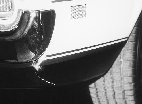

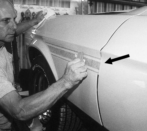

We looked at an all-original ’71 Mach 1 for the stripe’s position behind the fender opening. This stripe should be placed in the curve as shown with a 1/4-inch overlap on the end (arrow). Once again, Paremsky steps back to make sure the stripe follows the center of the beauty line.
P98321_image_large

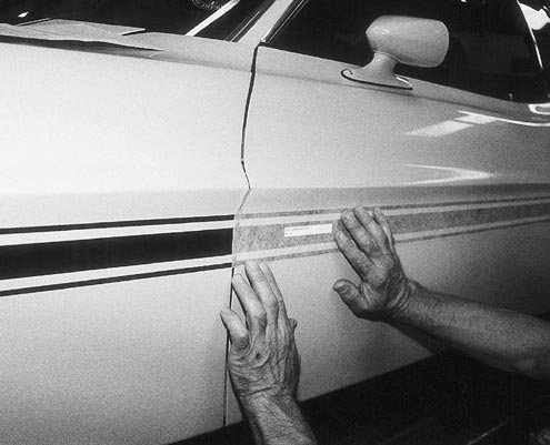

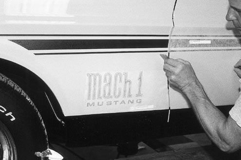

After allowing the stripe to dry for several minutes, Paremsky uses a squeegee to burnish down the fender stripe. Make sure you hold the stripe as you squeegee to prevent it from moving, because it will take awhile for the water to evaporate. He then folds the edge over to the inside of the panel. Next, the door stripe is applied using the same methods previously shown.
P98322_image_large

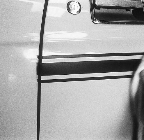

The tail that should hang off the door (and fenders) should be folded over to the inside of the panel. After the paper is pulled, use a clean cloth to wipe the stripe down. If you have bubbles, you can use an X-Acto knife to prick the bubble to release the air. Of course, the goal is to not get any bubbles.

Placement is quite simple with regards to the Mach 1 portion of our kit. The paper follows the trailing edge of the fender and the lower beauty line of the car. Note, the door stripe is still covered in paper. If you attempt to pull the top paper off and the stripe still wants to stick to it, you’ll need to squeegee some more water out and let it sit for a while.

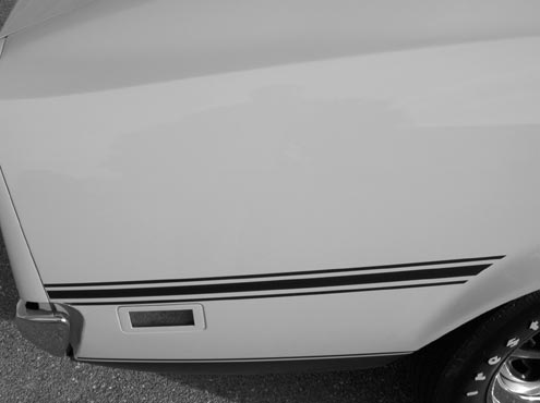

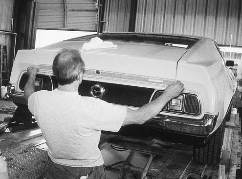

The decklids on the ’71-’73 cars are hard-fit items; most of them just plain don’t line up. Here’s where a stripe can come in handy. The decklid on this Mach does not match the extensions, so we used the stripe kit to line them up. Paremsky applies the center first.
P98329_image_large
Next, Paremsky adjusts the end cap stripes to match the center. This way, the illusion shows that the end caps are lined up with the decklid.
P98330_image_large

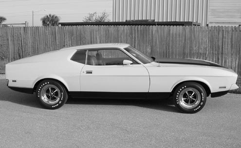

The lower stripe is unavailable in low-gloss black, so we had to buy a 150-foot roll of 2-inch-wide 3M® striping tape (PN 77193) and have the pattern cut. The $54 cutting cost—particularly on a concours car, such as this one—is worth it. The stripe on top is 1/4 inch, the space is 1/2 inch, and the body stripe is 3/4 inch.
P98331_image_large
The actual treatment on the rear of the car probably isn’t this neat on an original car, but we couldn’t resist a nice, even, clean cut. Now the car is ready to show.
