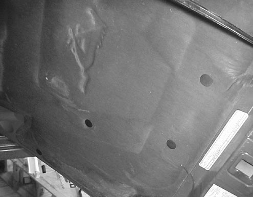

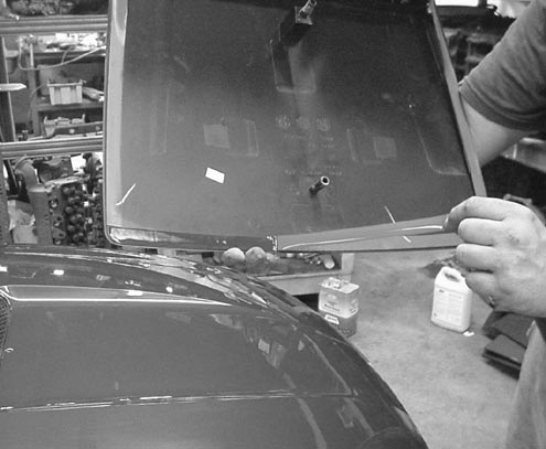

The hood pad will have to be removed. The factory 35th Anniversary cars have holes in the pad for the studs. The nonscoop hood pad does not have the holes, nor do we recommend you putting them in.
P89778_image_large

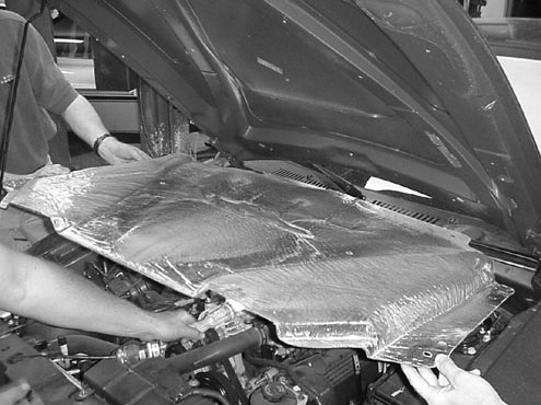

The pad should be removed from the hood.

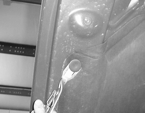

Allen Shepley uses these neat pliers to remove the plugs. It’s also a good idea to hit the Ford dealership for some new plugs. Sometimes removal will strip the teeth off of the plug.

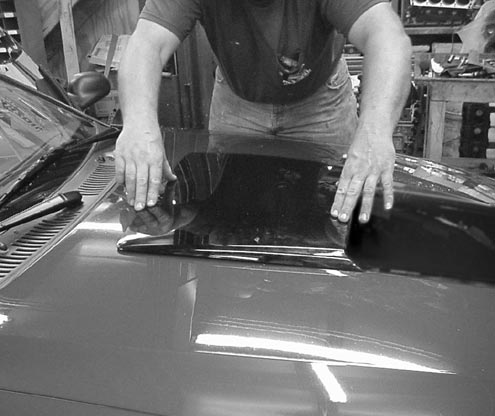

Shepley places the hoodscoop on the hood for position. This process would be easier had we ordered the scoop kit from Kar Kraft Engineering. Kar Kraft’s scoop, available in factory blems for roughly $129 or as a “matte black, open Anniversary Scoop” for $199 comes with a pattern. When you buy the scoop from Ford, you get just that—the scoop.

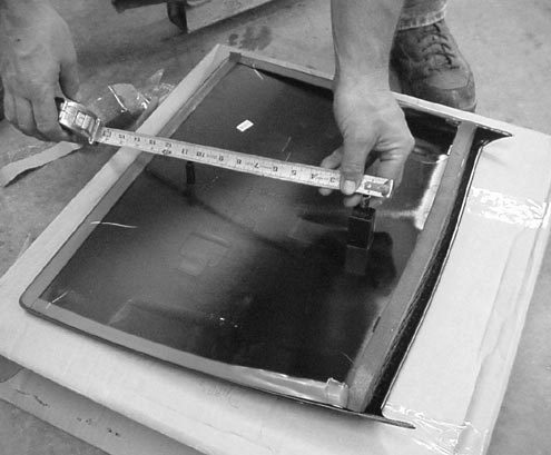

Since our scoop was a Ford part, we had to measure the entire setup. Shepley is seen here measuring from the front locator stud to the rear locator stud.

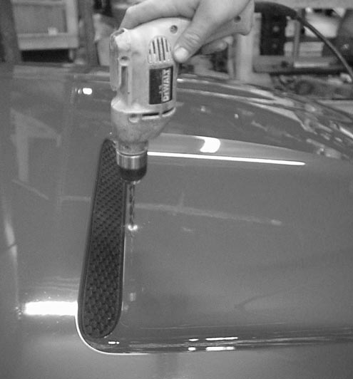

Now the drilling begins. The folks at Kar Kraft Engineering told us that the 35th Anniversary scoop is KISS principle, compared to the ’01 scoop. From what they told us, the new car scoop requires 11 holes to be drilled, while the Anniversary scoop has only two.

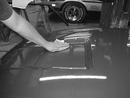

After we drilled the holes, all the debris from the hood was cleaned off and the scoop’s fit was checked. Satisfied, Shepley moved on to the next step—the hood stripe.
P89786_image_large

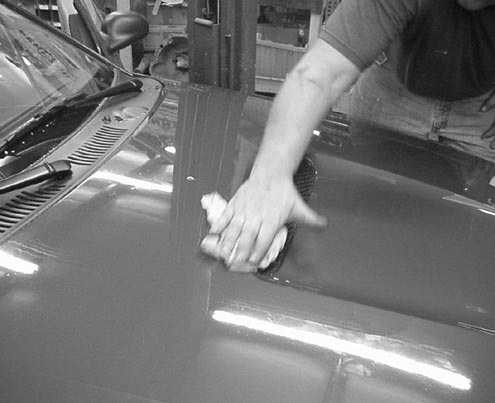

A precleaner was used to degrease the hood. This will promote good adhesion.

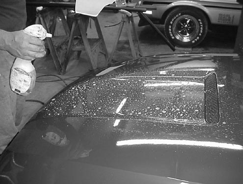

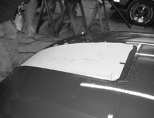

Just as in our story on the Mach 1 stripes in the June ’01 issue (“How To Stripe Your Steed,” page 72), Shepley lays down an ample coat of soapy water to aid in the stripe positioning.
P89788_image_large

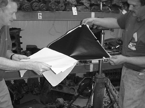

This is where it becomes a two-man job. Kevin Coleman just happened to be around to help Shepley pull apart the decal. Be careful that the decal does not stick to itself—a real danger on one this size.

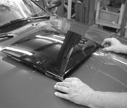

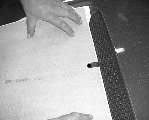

We won’t lie to you: this stripe can be a real bear to apply, because it’s big and bulky. We recommend that you wet an area larger than the stripe just in case you lay it “out of bounds.”
P89790_image_large

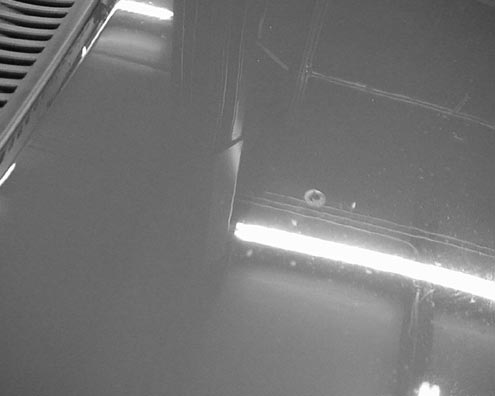

The only indication we saw where the front locator hole goes is here. Though, to be honest, it does seem to be a bit ambiguous. Other than that, the stripes are pretty self-explanatory.

Out comes the squeegee. We spent quite awhile removing all the bubbles from the stripe. This can be time-consuming, but patience will be rewarded. Work from the center of the stripe out to the edges. Any bubbles you find can be removed by pricking them with an X-Acto No. 11 blade.
