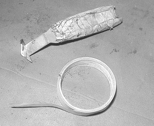

A windshield professional’s tools of the trade are quite simple in scope. The trim removal tool on top pops the retainer clips. A special kind of masking tape protects the paint. Two types of sealers are used (not shown here).

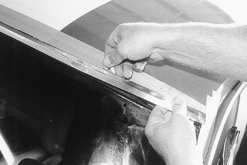

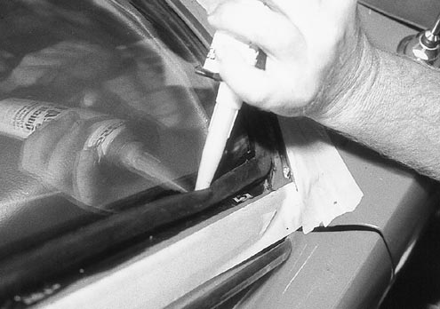

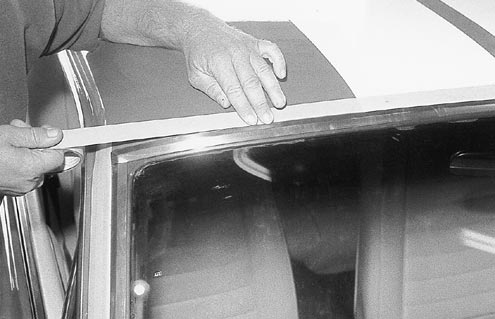

Painted surfaces must be protected. Autoglas 1 lays down a special blue masking tape designed to protect, then lift off with ease. Never pop a windshield without some form of paint protection.

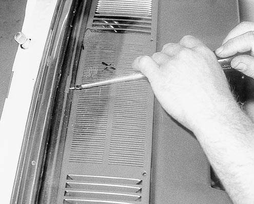

P86394_image_large
On a ’65-’66 Mustang, the dashpad trim inside must be removed to access the rubber gasket inside.

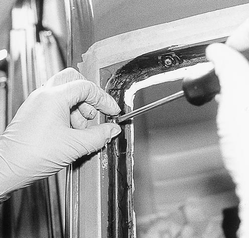

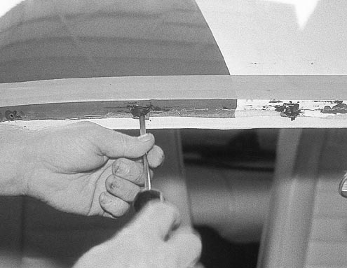

Removing windshield trim involves lifting the retainers behind the trim. Autoglas 1 uses the tool mentioned earlier, along with a screwdriver or razor blade to separate the trim. The clip (not visible) is lifted inside, which frees the trim.

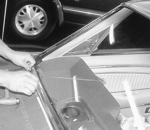

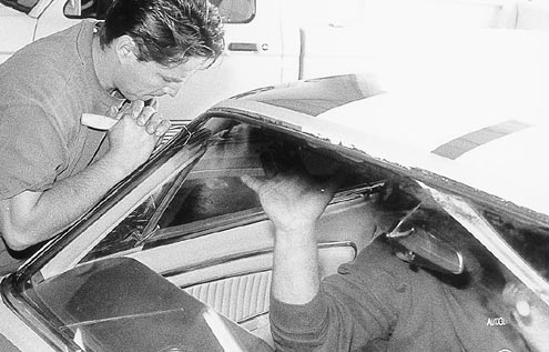

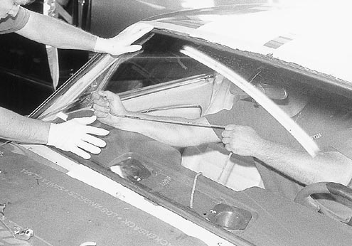

Autoglas 1 suggests removing the windshield independently of the rubber gasket. Here, the windshield is worked outside of the rubber lip. One person works inside pushing gently on the glass while another outside carefully works the glass out of the gasket.

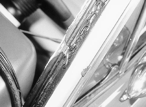

It’s easy to understand why our windshield leaked. Gaps like this in the sealer create avenues for leakage.

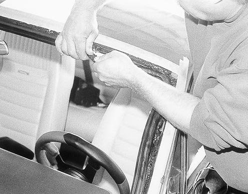

To prepare the windshield channel for the new rubber gasket, Autoglas 1 removes the old gasket and cleans out all of the sealer.

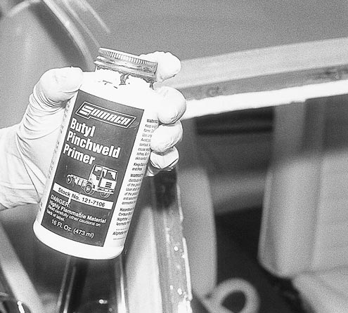

P86400_image_large
Somaca Butyl Pinchweld Primer is a brush-on primer designed to help the rubber gasket stick to the painted surfaces. Run a solid bead of this stuff around the perimeter.

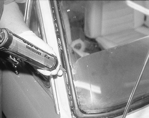

The U-418 sealer, available at most windshield shops, is injected into the gap between the windshield and body. You need a solid bead to keep water out. Use this stuff carefully because it does not wash off easily.
