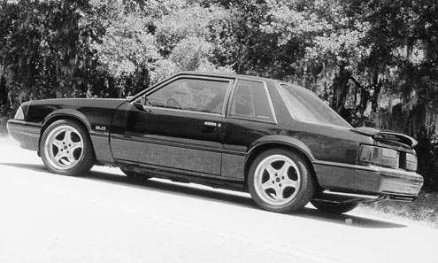

August 1, 2000
Photos By: Mike Johnson
P79750_image_large
Before...
P79751_image_large
...and After
P79752_image_large

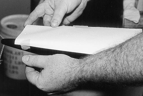

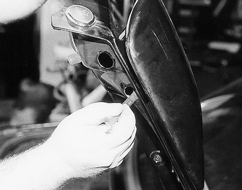

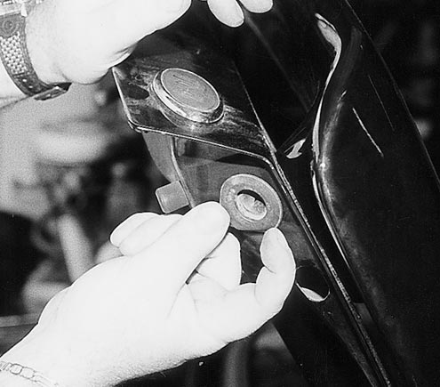

After having our wing painted to match our ’93 sedan, the first step was devising a template or an alignment tool for the mounting holes. Paper was gently taped down to the backside of the wing pedestals.
P79753_image_large

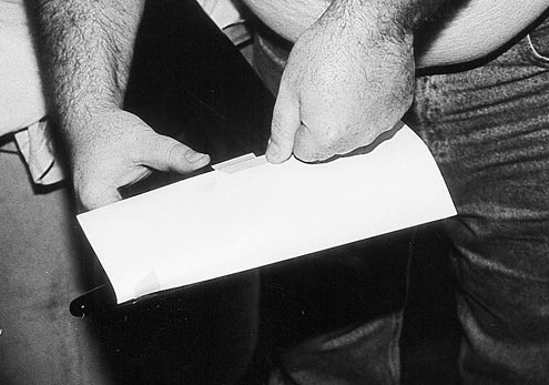

The four mounting holes were located by using thumb pressure over the holes to make a preliminary indication of them.
P79754_image_large

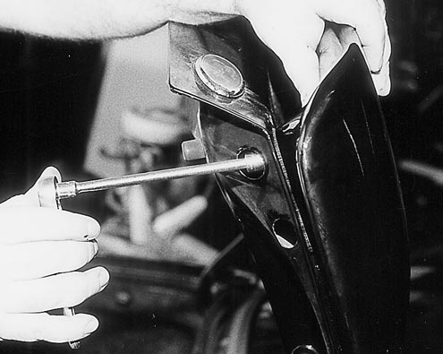

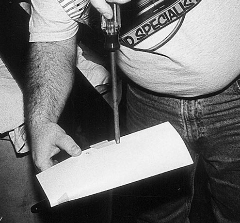

Using a large, blunt-tipped object, such as a Phillips screwdriver, holes were carefully made in the paper template by applying downward pressure and rotating the tool.

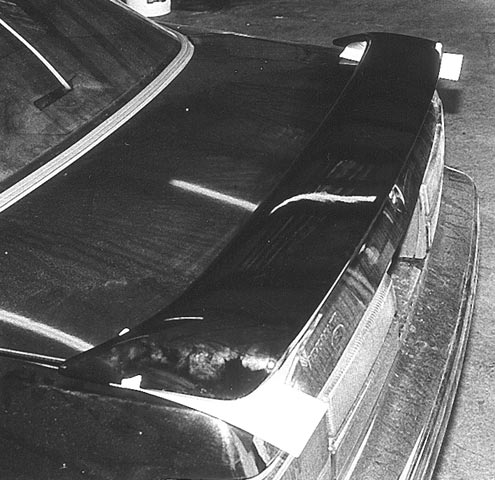

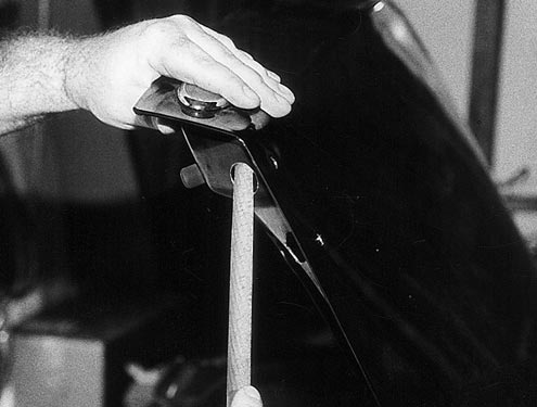

The wing is now laid in place on the decklid for measurements. If your convertible has a decklid-mounted luggage rack, then you will have to remove the rack and repaint the decklid, or you can install a sedan decklid.
P79756_image_large

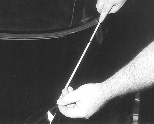

Measure from the wing to a fixed body point to get the wing to sit square.

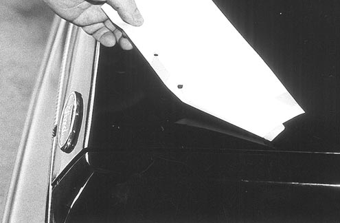

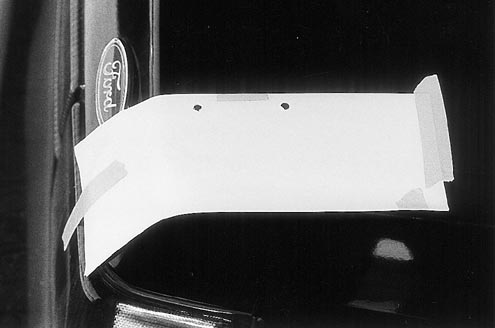

Once the wing is sitting in the desired location and is square to the body, the templates we made can be carefully taped to the decklid area.
P79758_image_large
Make sure the templates are secure so they will stay on the car when the wing is removed.
P79759_image_large

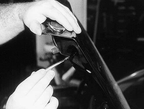

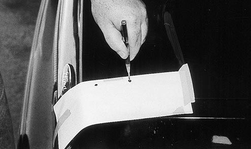

With the templates now on the decklid, it’s simply a matter of transferring the mounting hole locations to the decklid. You can use a scratch awl to circle the openings or you can use a punch to make a center punch mark. We prefer the center punch, as it aids in preventing your drill bit from walking when it comes time to drill the holes.
P79760_image_large
Once the mounting holes have been marked on the decklid, the templates can be removed and discarded.

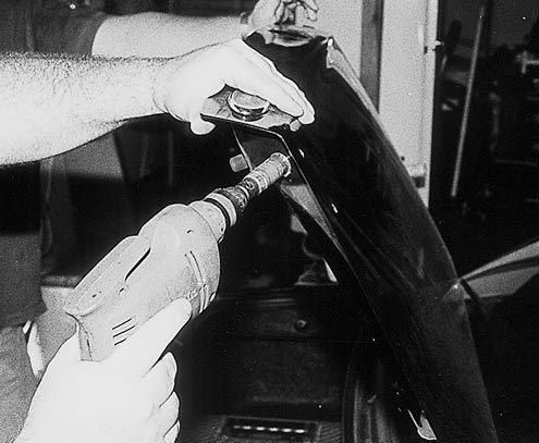

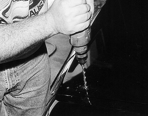

Using a 5/16-inch drill bit, the mounting holes were quickly drilled out of the decklid. Drill through only the top skin at this time. The bottom skin has too much curvature to it and will only make the drill bit walk.
P79762_image_large

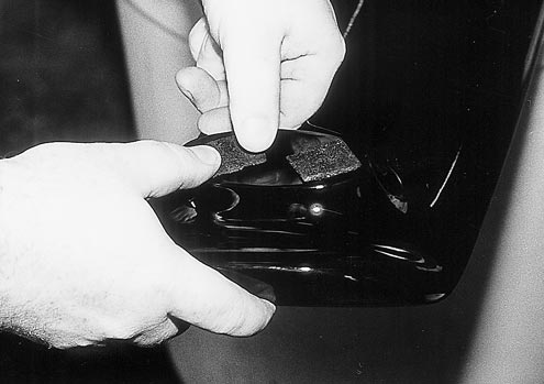

Apply waterproof sealer to the base of the wing to prevent water intrusion and any future rust problems. Sealer for taillights, window glass, or firewall openings works well. Clear the openings for the mounting bolts.

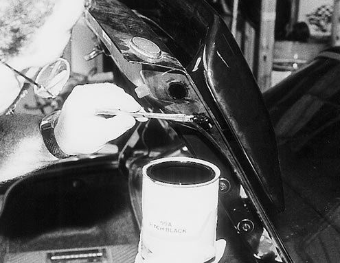

Before mounting the wing, use some touch-up paint to cover up the bare metal edges of the mounting holes. You will more than likely have to repeat this after the wing is installed to touch up any areas that you rub off.

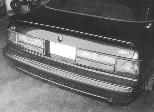

The final product.
