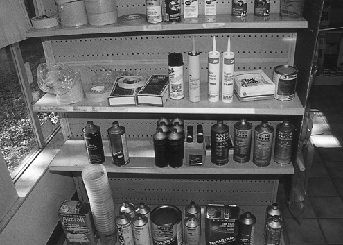

We didn’t deal with PPG corporate and neither will you. PPG’s jobber network is where people like you and I go for paint and supplies. Our local jobber, C.A.R.S., helped us immensely during our project. Here, C.A.R.S. Technical Advisor Keith Anger inputs our color formulas into C.A.R.S.’ computer for custom mixing. C.A.R.S. will mix and ship custom paints, but please don’t call them with technical questions.
P69780_image_large

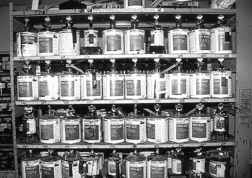

All custom paint colors are mixed from these base colors. This mixing rack ensures that the paints are mixed daily to prevent settling and separation.

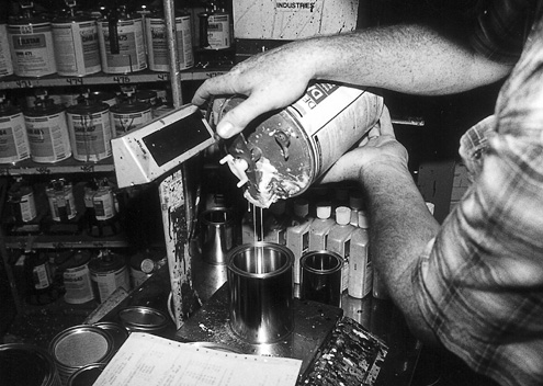

P69781_image_large
When a custom mix order is filled, the mix formula states (in order) how many parts of each color to add. Here Anger mixes up a small sample of one of the two Anniversary Gold formulas (for us to determine which one we will use). The scale will show “100” when the cumulative parts have been added.
P69782_image_large
C.A.R.S., like most any jobber, has a complete line of automotive paint refinishing supplies on its shelves. From masking tape (don’t use the cheap stuff from an office supply store) to HVLP spray systems, you can purchase everything you need.

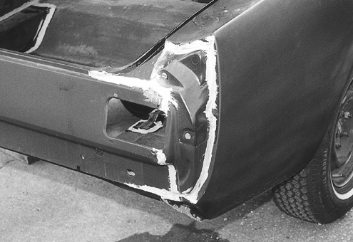

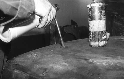

P69784_image_large
Using a high-quality seam sealer from 3M or Wurth, brush the sealer into any panel joints that require it, such as where panels were replaced. Notice the inside of the trunk is sealed as well.

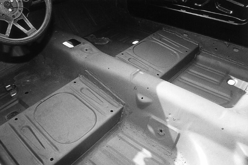

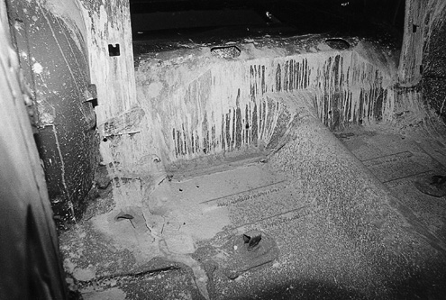

P69785_image_large
The floorpans are completely seam-sealed too. We laid down a couple of coats of rattle can primer to clean up the floor.

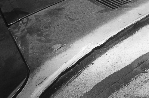

P69786_image_large
Here’s a great tip while you still have the seam sealer out. Carefully brush seam sealer between the dashpanel and the cowl top until the gap is closed with the seam sealer to prevent hidden water leaks that may mimic a leaking cowl.

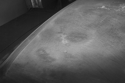

On to the body prep! Since we had so many new panels installed, most of our bodywork is a matter of taking care of a few shipping dings. But our roof panel had some major problems. There were dents, rust, old bodywork, and “oil canning” problems. To locate our problem areas, we began sanding the roof with 180-grit sandpaper on a sanding board. The dark spots you see here are the low areas that need to be repaired. Make sure you have quality shop lighting for all areas of your project.

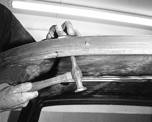

P69788_image_large
One way to bring these low areas back into place is with normal body hammer work. Notice the body dolly in the left hand while the right hand carefully works the metal back into place.

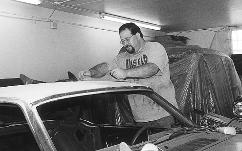

P69789_image_large
Taking care of high spots can be accomplished with a hammer and a dolly too, but a slapper can work wonders on high spots with just a few quick slaps of the tool. Many of these tools can be found at Sears, in catalogs, and through paint jobbers, such as C.A.R.S.

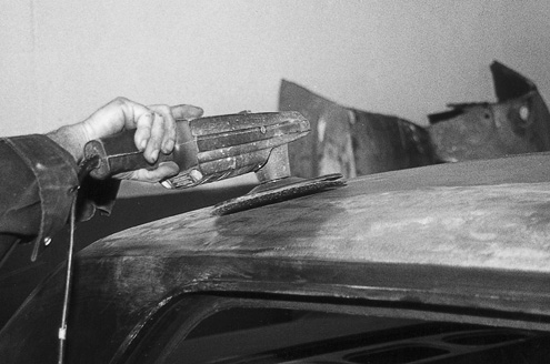

P69790_image_large
A large 40-grit sanding disc is utilized—once the major high and low spots are taken care of—to remove all surface rust and paint from the hardtop’s roof panel.

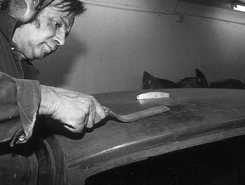

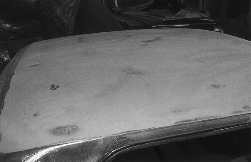

P69793_image_large
As we stated earlier, our roof panel looked as though Steve Saleen had performed a victory dance on it and therefore required some extensive repairs. With the major dents, dings, and pinholes tapped out or welded closed, we used a small amount of body filler to fill in any minor low spots that remained. While the amount looks excessive in this application shot, approximately 80 percent will be sanded off.

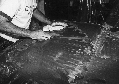

P69794_image_large

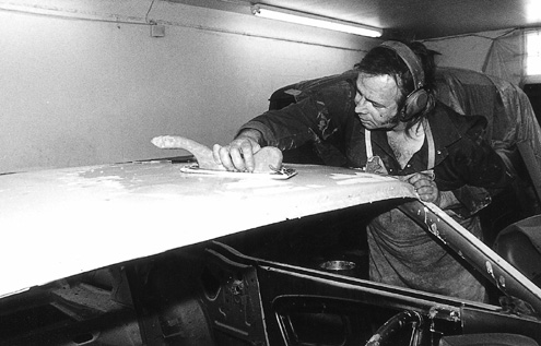

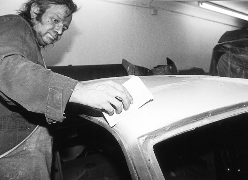

Once the plastic body filler has had sufficient time to set, yours truly is handed the sanding board and 80-grit paper to start knocking down the filler. Note, you should be wearing a mask and protective eye covering during all sanding and paint applications. Stupid me didn’t wear one for the first couple of days, so all I could smell was filler and primer for the next week.
P69795_image_large
No, I’m not this good—but the crew at Classic Creations did the final sanding work. Again, this may look like a lot of filler, but it’s thin enough to see through to the metal in most places.

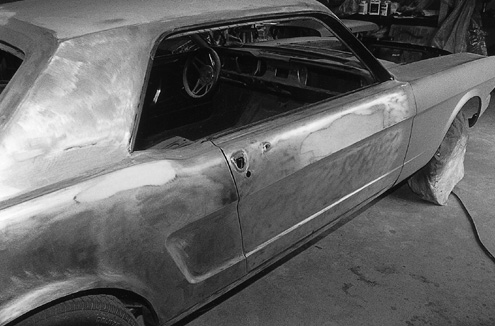

P69796_image_large

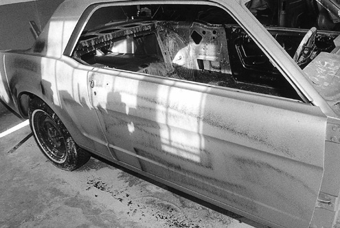

The rest of the body, being about 90 percent new, simply required some machine sanding with 180-grit paper to remove the old DP-90 primer (applied several months ago for protection). Shipping damage occurred to our right door (shown here repaired), and the top of the right rear full quarter got kissed by the garage door rail while pushing the car into the garage one night (better now than after it was painted).

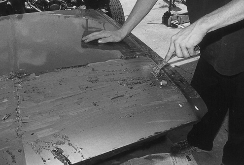

P69797_image_large
For those of you following along who wish to repaint your car and are working with old panels and old paint, you also have the option of stripping your old paint (never paint over an old paint job if you can) using paint stripper instead of sandpaper. The aircraft paint stripper being used here allows old paint to simply scrape right off.

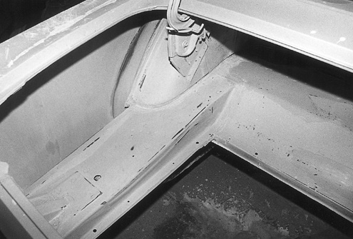

P69798_image_large

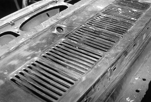

Another potential problem lies in the Mustang’s cowl vent design. Layers of old paint and rust on the vent grille will prove that there isn’t a worse job out there. Have patience and take your time for quality results.

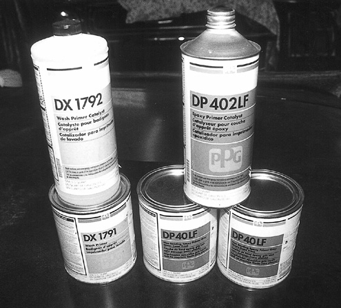

Anger suggested using PPG’s DX 1792 Wash Primer and K38 High Build Primer/Surfacer as the base for our paint application. The DX 1792 offers excellent adhesion for the remaining products and the K38 quickly fills minor imperfections and dries quickly. Wet-sanding is accomplished with 400-grit paper.
P69800_image_large
The K38 makes quite a mess as it is being sanded, so be prepared. You should take the time to completely disassemble your project for painting, but if you’re simply repainting your project, make sure glass and rubber items are properly masked off.
P69801_image_large
Shown here next to our previously used DX 1792 Wash Primer is PPG’s DP40LF epoxy primer, which is used as a primer/sealer. The DP line of PPG primers is available in five colors and the DPLF is available in six: DP40 is gray/green, DP48 is white, DP50 is gray, DP74 is red, and DP90 is black. You can obtain identical colors in DPLF as well as DP60LF, which is blue. These colors help brighten or subdue the color of the topcoat, so choose accordingly or get samples and spray test cards to determine the proper shade you desire.

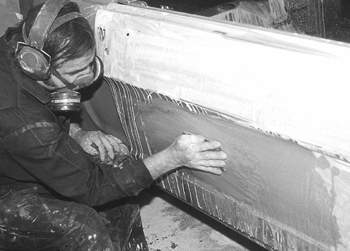

P69803_image_large
Once the DP40 has dried, we can begin wet-sanding the primer/sealer in anticipation of our upcoming topcoat. Using 400-grit paper and a rubber sanding block, the complete body is sanded. Watch out for sharp corners so that you don’t break through the primer coat. Wash the panel down and look for any traces of the black guide paint. If you see any, the panel will need additional sanding or filler.
P69804_image_large

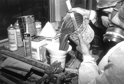

Yes, that is a coffee can. What’s important though is that a paint strainer is being utilized. Mixing the topcoat correctly is important because there are different reducers for different temperatures during application. We used PPG DT885 for the hot weather here in Florida at the time of painting.

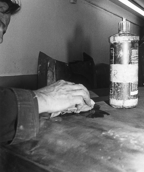

P69806_image_large

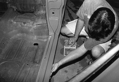

We began our final prep for the Anniversary Gold topcoat by cleaning the complete body inside and out (and all of our loose panels) with PPG’s DX330 ACRYLI-CLEAN Wax and Grease Remover. This step was taken before each layer of product (DX1792, K38, and DP40) was sprayed, but it is critical for the topcoat adhesion to be cleaned this last time very carefully.

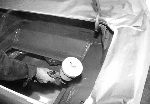

P69807_image_large
The underside of the decklid (removed), the underside of the hood (removed), and the trunk are all taken care of first because these areas will need to be completely dry to allow the decklid and the hood to rest in place during the exterior topcoat application. The rear of the body is masked off to prevent any overspray that will affect the exterior topcoat’s appearance.

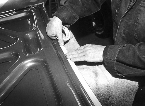

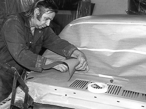

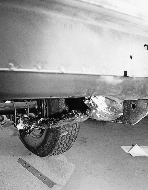

P69809_image_large
Depending upon how much you’ve disassembled your Mustang will determine how much time you will spend masking off areas to prevent overspray. Since our Mustang was a bare shell, we simply masked off the window openings to prevent overspray on our primed dash area.

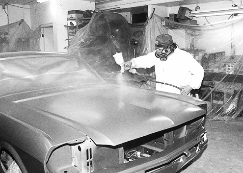

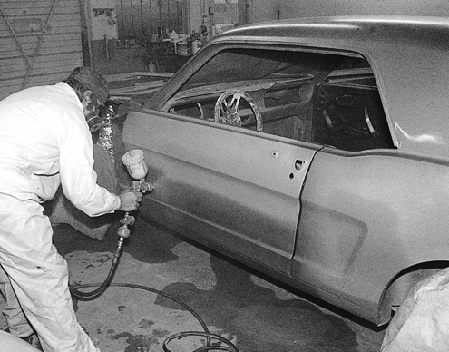

P69810_image_large
Now it’s time for the first coat of paint. After proper mixing and preparations, the first coat of Anniversary Gold is applied. Every painter has a different method for application, so use what’s best for you to ensure uniform coverage. Some paints fill better than others and require fewer coats. You want a wet coat but not so thick that it runs.

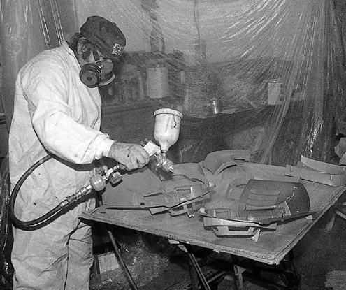

P69812_image_large
Apply the first few coats of your top color to loose items, such as headlight trim and valances, on spray stands. When it comes time for the final coat of color, bolt the items loosely to the body so that the flow of the paint from the gun will match from one panel to the next; this is especially important for metallic paints.

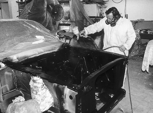

After allowing sufficient time to dry (at least 16 hours), the front of the hardtop was carefully disassembled so that we could paint the engine compartment. Using PPG DCC 9300 Concept Black with PPG DX685 Flattening Agent (you’ll have to see the product bulletin to determine the amount to mix for the gloss you desire), we achieved the perfect eggshell gloss finish we desired for our engine compartment.

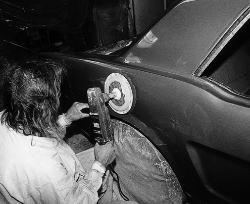

P69817_image_large

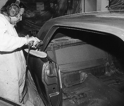

After the clearcoat has been wet-sanded, the next phase to bringing out our show-winning finish is applying a buffing compound. Using a high-speed machine buffer is the only way to accomplish this. Watch the corners and sharp edges to prevent burning through the clearcoat. You want the pad spinning away from the edge, not toward it.
P69818_image_large

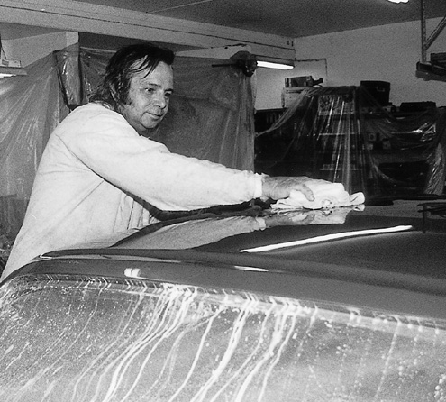

A coat of high-quality paste wax that is clearcoat compatible is applied to give us the final sunglasses-required, stop-and-stare shine. Make sure the wax contains no silicone. We’ve now reached the top of Mustang Mountain, and the rest is all downhill from here! MCA 25th Anniversary, here we come!

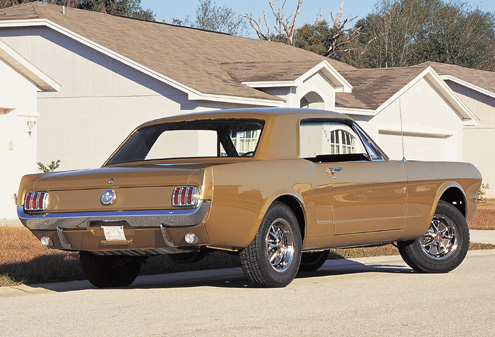

P69845_image_large
Our ’66 hardtop is shown here (about three months after painting) with the interior completed and all the glass installed. We ordered a set of Styled Steel wheels from Specialty Wheels and new Hoosier RS Radials to wrap around them. Nothing sets off a ’65-’66 like a set of Styled Steels and these are perfect!
