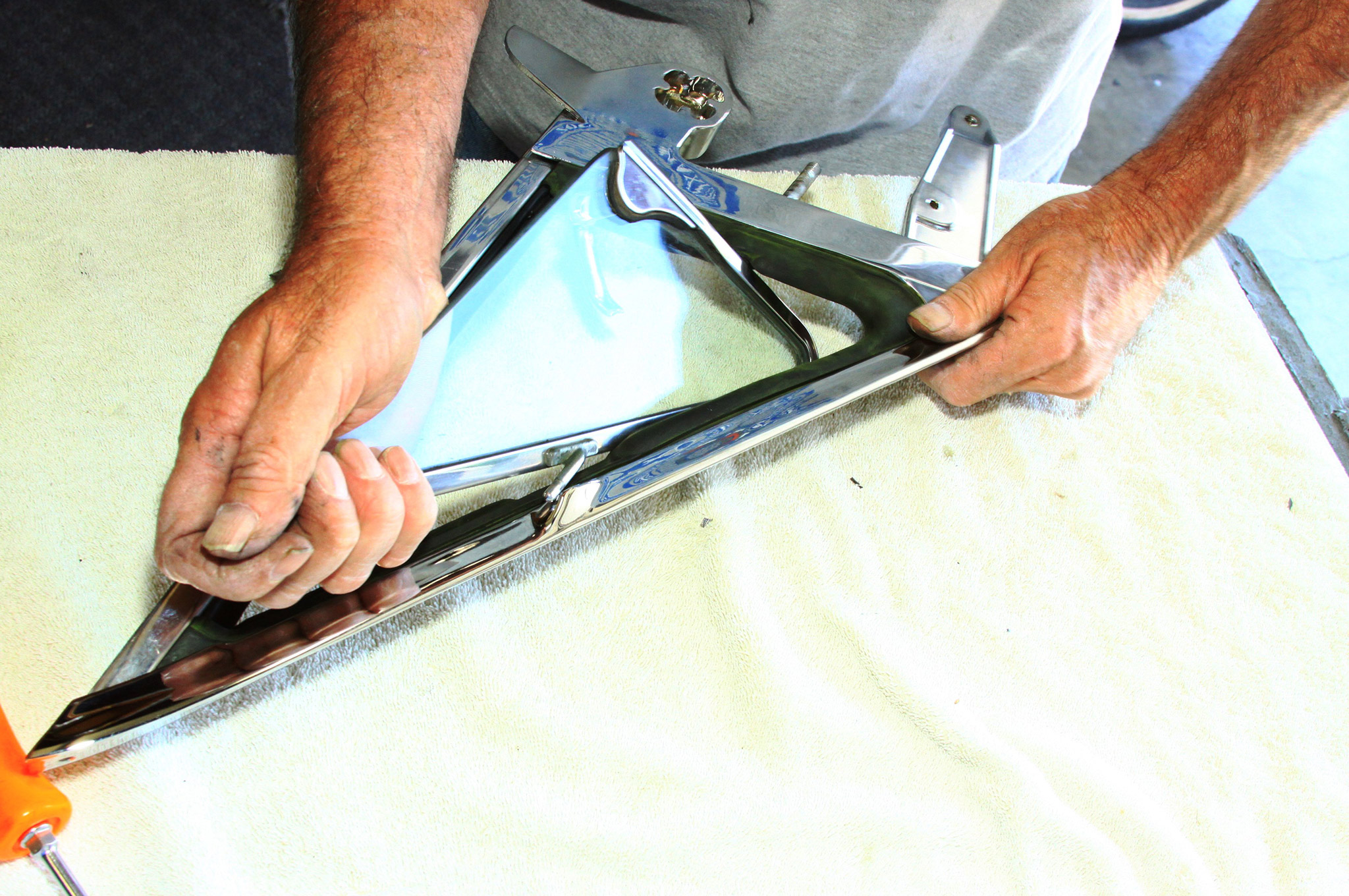

On the other hand don’t take a severely pitted piece of die-cast such as a quarter window or wing window frame and expect a chrome shop to work miracles. Junk is junk and there are plenty of restorable examples out there that a chrome shop doesn’t have to spend days preparing for the plating process. The more time they spend doing prep work the more they’re going to charge you.
Definition gets lost when a plating shop has to grind away pitting. What’s more, new chrome will pit in time due to contamination. Pitting is mostly the result of die-cast contamination when the part was new. Add a damp environment and corrosive materials like road salt and you have a formula for pitting.
Now that’s a hard shine…
