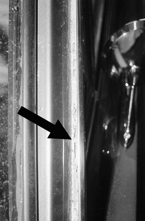

Besides replacement, there are several good reasons for removing the driprail mouldings. This Mustang was recently repainted, and if the mouldings had been removed before the paint job, the driprail could have been better cleaned and prepped for painting. Instead, old seam sealer and other “nasties” remain (arrow) with fresh paint over them.

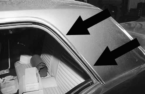

After 30-plus years of washings, exposure, repainting, and other atrocities, the driprail mouldings are usually quite banged up. The most common eyesores are dents in the mouldings (arrows) and scrapes and scratches.

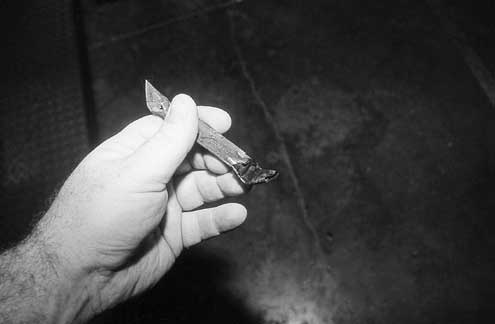

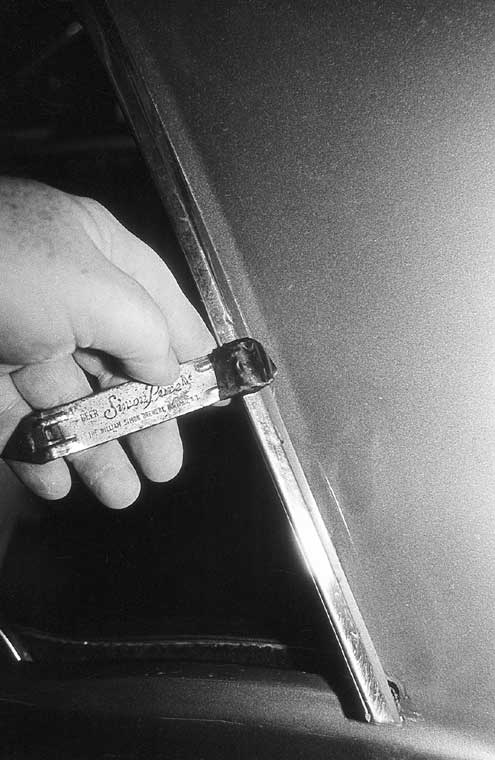

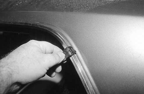

Our first trick is using the proper tool. Believe it or not, you probably already have one (or more) of these handy: an old-fashioned bottle opener. As you can see here, we’ve wrapped the bottle-cap end (NOT the can-puncture end) with several protective layers of electrical tape. Violà, a custom tool for driprail moulding removal.
P60474_image_large

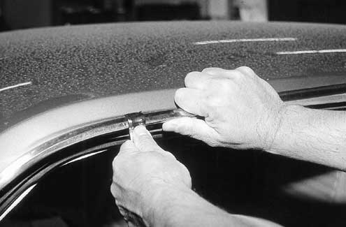

Using the bottle-cap lifting tab, carefully lock the tab under the moulding lip at the rear of the moulding and pry upward. This takes a little practice and some finesse. Don’t try to pry up the actual driprail; you want to catch only the edge of the moulding itself.
P60475_image_large

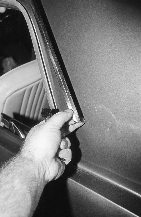

Slowly work your way up to the first corner. Corners are difficult and take even more patience, so take your time. Of course, if your mouldings are not worth saving and you have replacements, then feel free to rip away with reckless abandon!
P60476_image_large
Using a two-handed approach, work your way across the long top edge of the moulding. Use your left hand to pry up the moulding with your tool and your right hand to guide the moulding over the driprail. Work in short 1- or 2-inch segments. If you attempt to pry up 6 or so inches at a time, you will bend the moulding.
P60477_image_large
While you’re prying and twisting your way toward the front half of the driprail moulding, the rear half will start “flopping” around. So make sure an assistant holds the rear half to prevent scratching your paint on the roof sides.

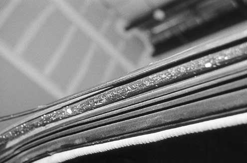

Though a bit difficult to determine in this photo, the original mouldings showed evidence of at least two different color paint jobs, something that can seriously detract from a car’s appearance but that can be easily improved with new mouldings.

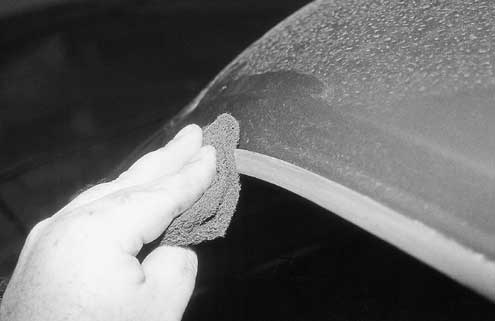

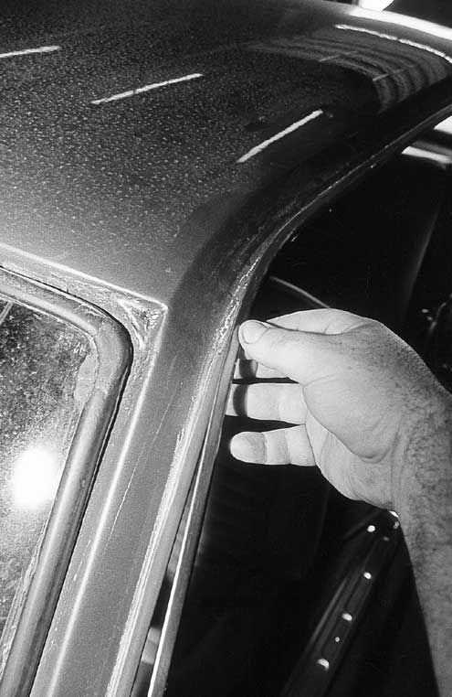

The driprails usually have light surface rust or a buildup of old paint jobs, which makes installing the new mouldings more difficult. A Scotch-Brite pad will help clean the driprails and prepare them for the new mouldings.

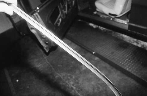

Position the new driprail moulding along the long, straight top part of the rail. Make sure the corners are correctly positioned. If one end appears to be too short, you’ll have to reposition the moulding. Again, make sure an assistant holds the ends of the moulding to prevent paint damage.

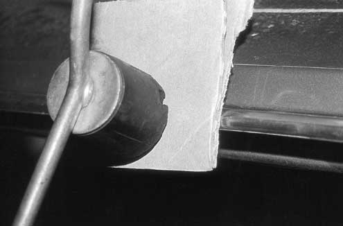

At left, the moulding needs to be coaxed over the lip of the driprail to allow a secure fit. Depending upon your comfort level, you can use the palm of your hand, a soft rubber mallet, or some other means to ensure a secure fit. We used a rubber mallet and a double-folded piece of cardboard for extra cushioning. Make sure you give the moulding a glancing downward blow to snap the moulding onto the driprail. Do not hit the moulding square or you will distort it.

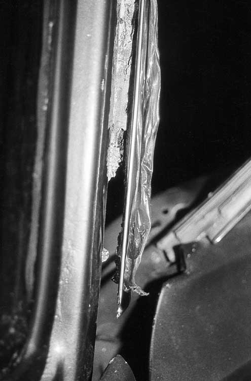

Some of you might encounter rusted driprails. In fact, some driprail problems don’t rear their ugly heads until you attempt to put on the mouldings. This gaping rust hole at the base of the driver-side rail gave us some problems. We didn’t have any “backbone” to hammer upon, thus we had to support the driprail so that we could secure the moulding over it. Look for these problems before you start. If your driprails are in poor condition, have them replaced by a competent body shop.

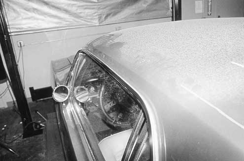

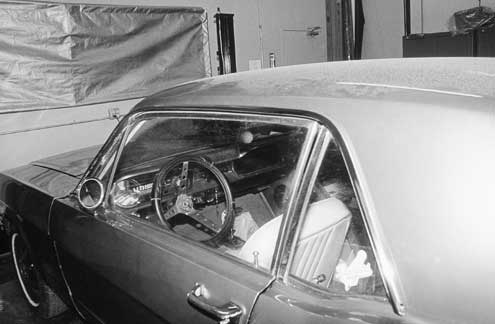

Our new driprails from Virginia Classic Mustang are now installed. They make our new paint job look great, just as any new exterior chrome would. So don’t overlook these important items when you’re refinishing or freshening your ’65-’68 Mustang.
