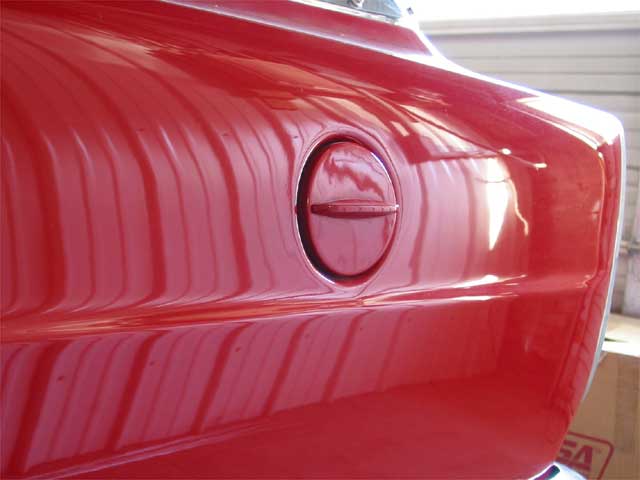

The original fuel door on Editor Ford's '66 Ranchero looks like this--notunattractive, just messy. Gas will spill onto the quarter-panel ifyou're not careful when refueling, and you can even get that slosheffect in hard cornering. Through some investigative junkyard crawling,we found that a late-model Probe fuel door has a nice shape and almostthe same crown as the upper quarter--making it a fine candidate for atransplant.

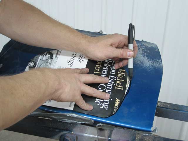

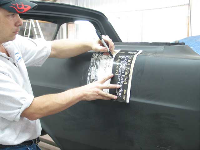

Using light-weight cardboard or construction paper, we make a templatethat will cover the original fuel port location and sit in proportionwith the style lines of the car or truck.

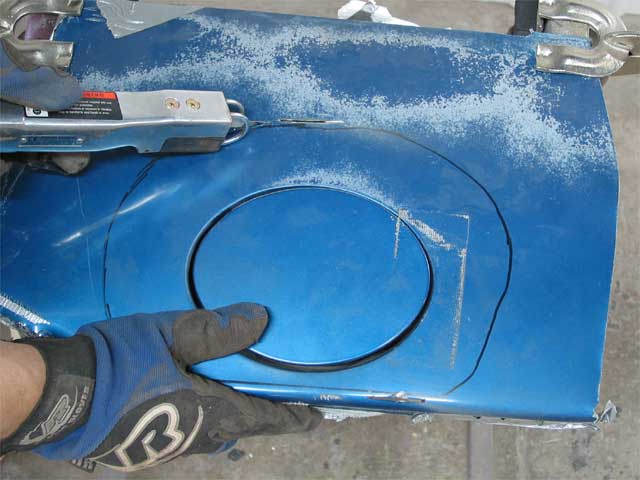

Using a Sharpie we trace out the same template to the Probe fuel doorfor our cut lines.
127_0404_skin_4_z
A saber saw is great for cutting corners and slices through thesheetmetal like butter.
