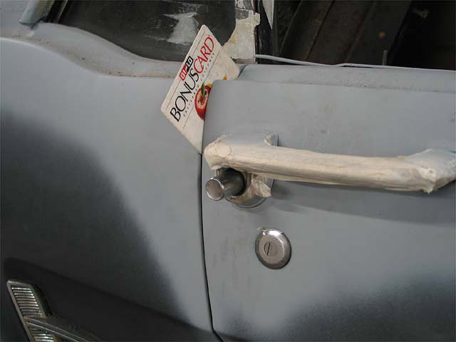

Here's a clear sign: This door gap on the Crustang is so tight itpinches a credit card between the door and quarter! That kind of slopcan't be adjusted, and the hinges will definitely have to be rebuilt.

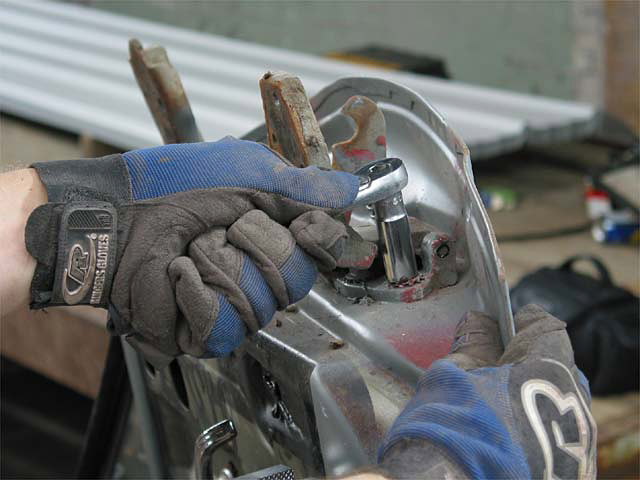

127_0402_hinge_1_z
1 The first step is door removal, followed by the hinge itself. Ifyou're not repainting the jambs at this time, use masking tape and markthe location of the hinge to the door to save time duringreinstallation.

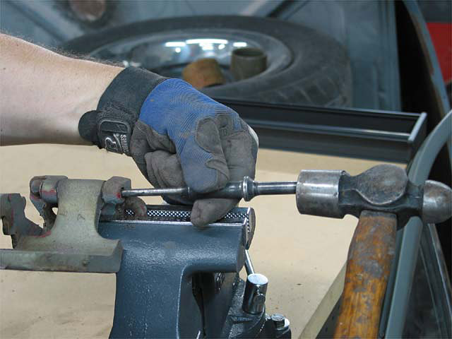

127_0402_hinge_2_z
2 A bench vise is a necessity in any shop. Without one, you'll probablyinvent some new words trying to "MacGyver" everything into shape. Usinga vise, a hammer, and a flat-faced punch, drive the hinge pin from theswing joint to replace the bushings.

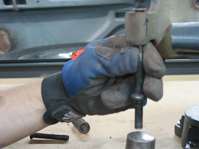

127_0402_hinge_3_z
3 Using the same punch, drive each bushing up from its seat and removeboth bushings.
