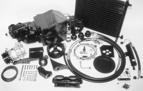

P136530_image_large
All the essentials are here—even in this preproduction kit. Classic Auto Air used Computer-Aided Design (CAD) software to design the all-new case. Note the use of the factory filter drier and condenser.
