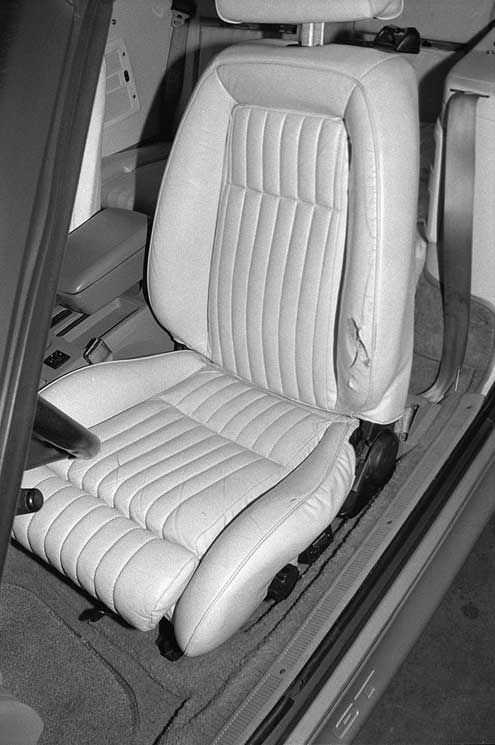

The owner had used cloth seat covers to hide the unsightly factory leather, but the covers couldn't hide the faded and stained carpet, seat belts, and trim items.

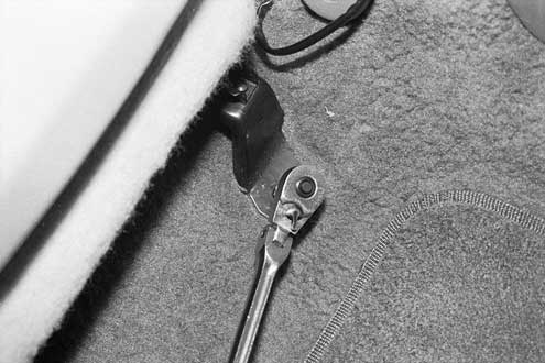

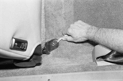

Removal of the front seats is accomplished by removing two bolts at the rear of the seat tracks and two nuts from the front of the seat tracks. If you have a power lumbar adjustment, disconnect the wiring plug before lifting the seats out the car. The rear seats come out by pulling up on the seat cushion and then unbolting the rear seat back or fold down assemblies.

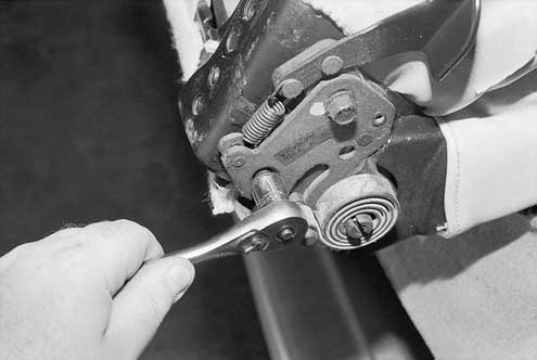

Once the tracks are removed you will need to separate the seat back from the seat bottom. This is accomplished by removing the plastic trim cover to access these two bolts on the seat back adjuster side, and then remove the pivot bolt on the opposite side.

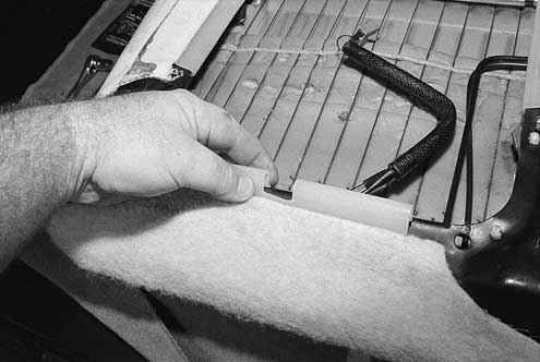

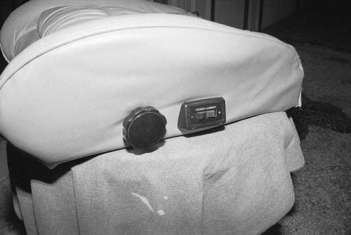

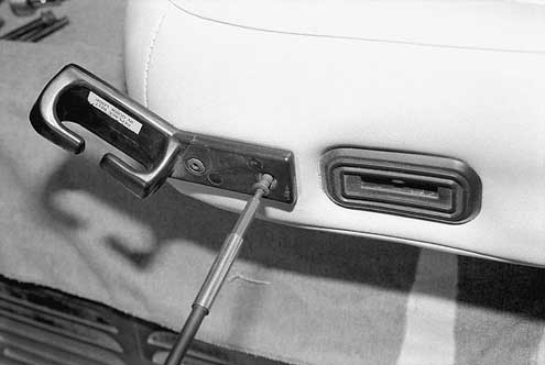

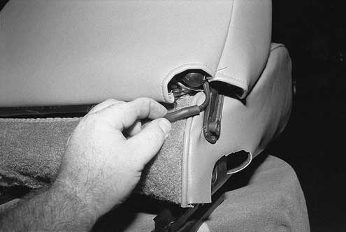

Remove any knobs or switches from the sides of your seat and then unhook the plastic retainers around the edge of the frame. Pull the material inside out so that it sits like a bowl on top of the cushion.
P45643_image_large

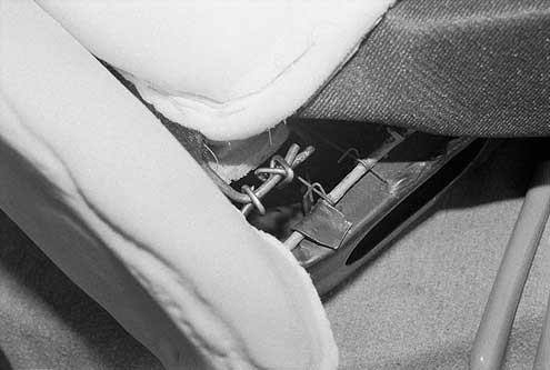

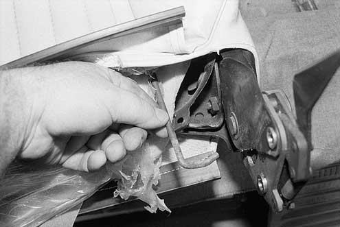

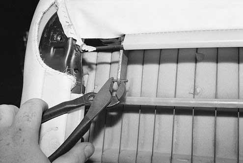

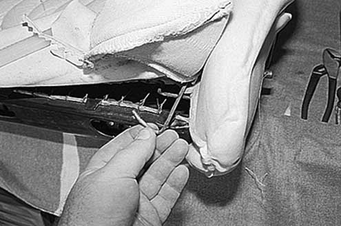

Remove these two wire stays (one on each side) and roll the material back to locate the third wire stay towards the back and remove the three hog rings found there to remove the material from the cushion. Tape the wire stays together and mark them for locations in order to prevent mixing them up with the seat back or back seat stays.

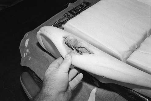

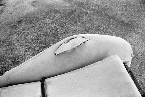

We found some damage to the foam base underneath. New seat foam was ordered.

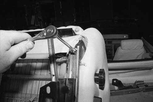

With the head rest removed pull the plastic liner up and out of the seat back. If it is a convertible seat, also remove the seat belt guide at this time.
P45648_image_large
The seat back uses a larger stay to form the tucks in the material. Remove the metal retainer and pull the wire out from each side.

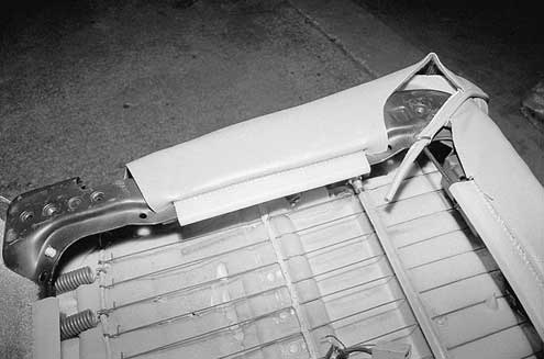

Roll the material up the seat and remove the three hog rings holding the material to the front of the upper seat cushion. Remove the material from the head rest by prying the fiber board off and rolling the material backwards off the headrest. Follow all the previous steps as a guideline for the removal of the upholstery on the rear seat assembly.

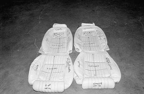

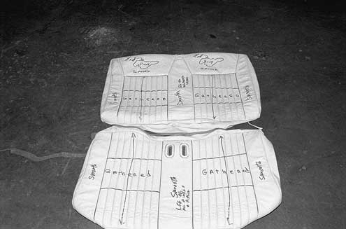

Since E&G offers several services, including emblem stitching, smooth and gathered looks, as well as multi-colored seat covers (for example a gray seat with black piping), we wanted to spell it out for their trim department. We grabbed a permanent laundry marker and labeled our seat covers according to what we wanted smooth and gathered, and where we wanted the optional running horse logo.
P45652_image_large
We repeated the operation on the rear seat covers and then carefully packed them up for shipping. One word of caution here: If you are changing seat colors, make sure you get a section of carpeting for the back of the front seat lower cover that will match. We had extra carpet sent to us from Auto Custom Carpets and forwarded two sections to E&G just for this.

When our new covers came in we began with the seat base cushion first. Our new cushion from our local Ford dealer came in wrong and we ended up having to patch our original like you see here.

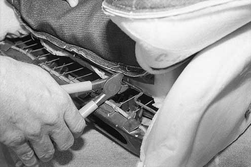

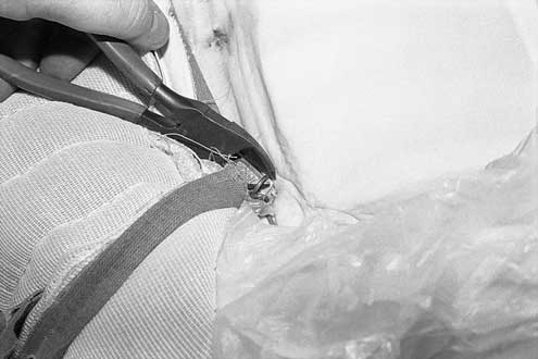

After inserting the original stay wires into the new material the seat base cover is installed with new hog rings using a pair of hog ring pliers.

Install the side stays and hog ring them to the seat frame like shown. The original wire clamps usually break when they are reused, so just toss them in the trash and use hog rings.

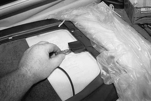

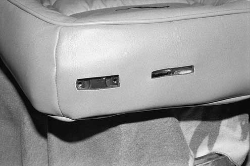

Carefully find the original openings and cut the leather carefully with a hobby knife or single edge razor blade just enough for the shaft or switches to come through.

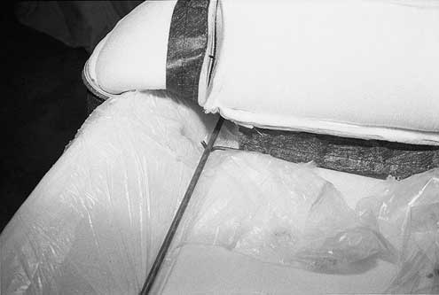

For the seat back cover, first hog ring the stay wire at the upper front of the cushion. Proceed to roll the cover down the cushion (plastic will help here, so throw a garbage bag over the cushion first if the original plastic is missing) and insert the large stay wires into the sleeves (arrow). The large stay wire will hook under the edge of the frame and then hold down the cross wire as shown here in this picture with the material still rolled up.

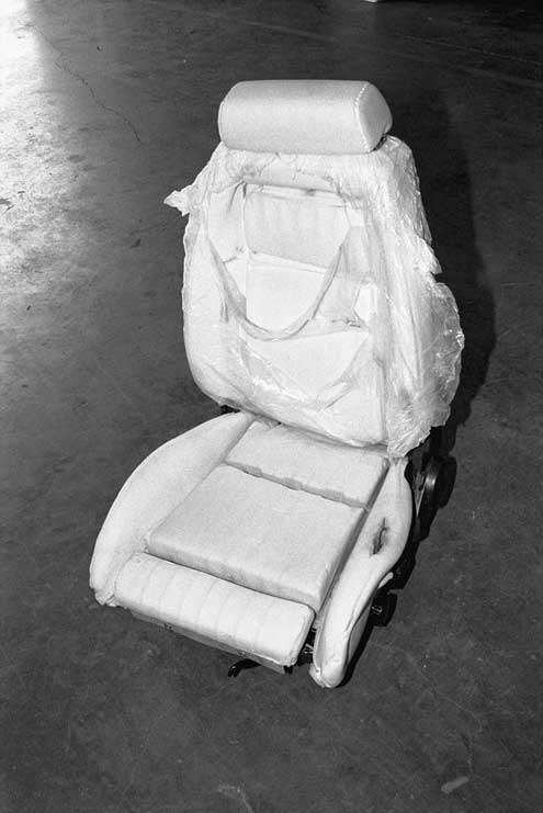

A completed front seat awaits installation into our Mustang. The head rest assembly will give you the most diffuculty, so use lots of patience during the head rest assembly. A plastic bag will also help with the head rest cover. Complete the remaining front seat and rear seats with the new covers.

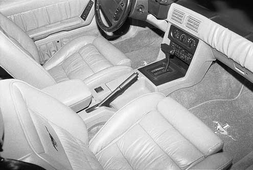

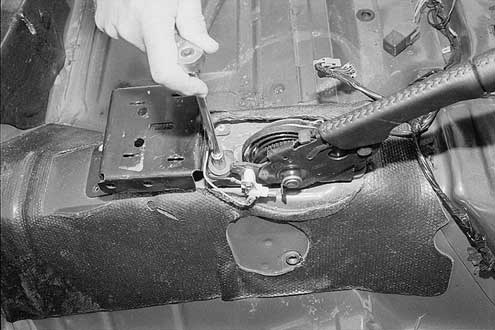

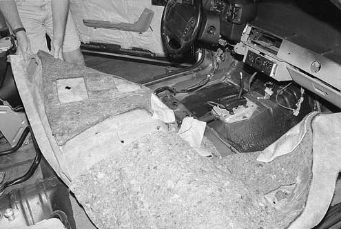

To remove the carpet, the complete console assembly will have to be removed, as well as the kick panels, door scuff plates, and the rear quarter trim panels on convertibles. Start at one corner and roll the carpet back, being careful to not get stuck on the shifter or parking brake handle.
P45663_image_large

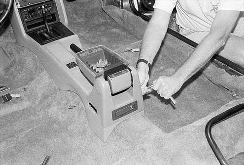

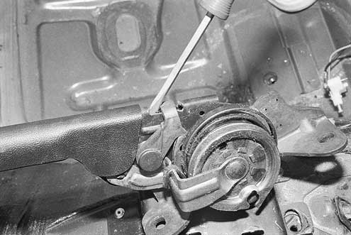

Speaking of parking brake handles, we opted to trash the stock plastic Pinto job and upgrade to a fine leather version from the Mustang Cobra, available through Performance Parts Inc. With the console removed, simply insert a small screwdriver like shown, or a nail through the retaining hole found on the passenger side of the handle. This will lock the handle and allow you to unhook the parking brake cable.
P45664_image_large
Unbolt the parking brake handle and install the new leather Cobra unit. Don't forget to swap the parking brake switch and wiring to the new handle assembly and remove the retaining pin.

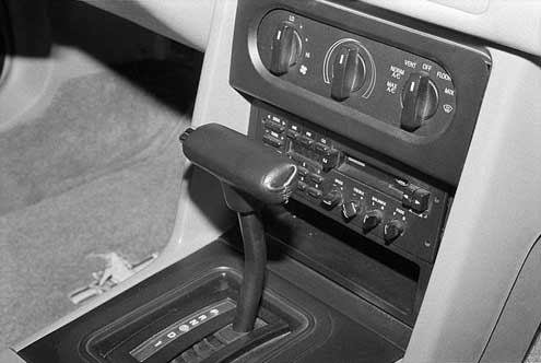

To compliment our parking brake handle, we had the stock shifter recovered in black leather (which was supplied by E&G Classics) by Mr. Autocraft in Bartow, Florida.

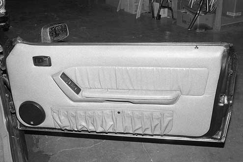

Mr. Autocraft also recovered our door panels in gray leather, as well as adding the gathered look to our door inserts, and covering our door arm rest pads in leather, with off-the-bolt leather supplied by E&G Classics. We used aftermarket speaker grilles to give the door a custom look and get rid of the stock grilles that detract from the door so much.

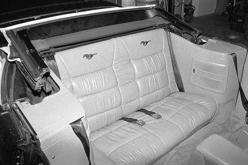

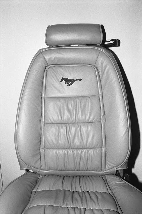

The running pony stitching was also added to our rear seat covers. The new rewebbed black seat belts from Ssnake Oyl add just the right amount of contrast while giving us renewed trust in our seat belts. We decided not to cut the seat belt openings in the lower cushion, but to extend the belt material during the rewebbing process to have the buckles come out between the seat back and bottom cushions.
