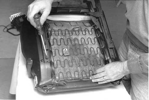

P40428_image_large
Seat-track mechanisms are next. Four Phillips-head machine screws hold the tracks in place.

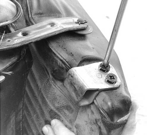

P40430_image_large
The seat-back latch is anchored with two large countersink Phillips-head screws, as shown. A #3 Phillips has the bite necessary to loosen these.

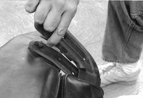

P40432_image_large
A large common screwdriver is used to pry the seat-back pivot arm away from the pivot pin. Lift the seat back from the seat base.

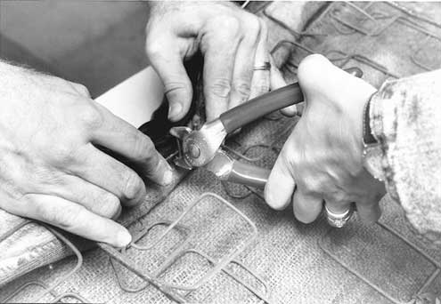

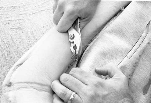

P40433_image_large

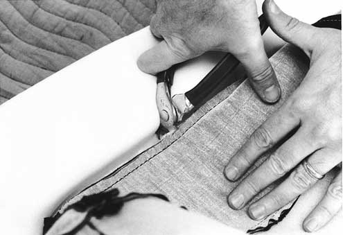

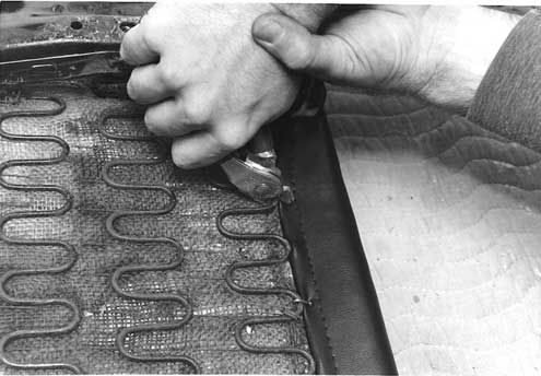

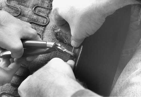

Hog rings are removed around the perimeter with diagonal cutting pliers or standard pliers, as shown. In this photo, we're removing the hog rings that retain the wire listing inside the upholstery around the inside of the seat base.

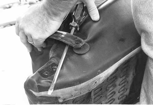

P40434_image_large

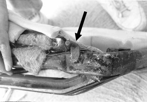

This is the seat-back pivot pin (arrow). A noteworthy suggestion is to closely inspect this pin during reupholstering because it was the topic of a Ford recall in 1978. It can shear, causing the occupant to fall into the rear seat and lose control of the vehicle. If in doubt, visit a fabrication or welding shop that can replace the pin.

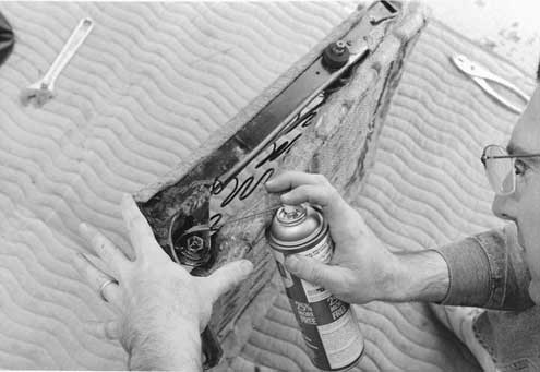

The seat-back latch mechanism gets a few shots of WD-40 to improve function. White grease is also a good lubricant to use here if WD-40 isn't available.

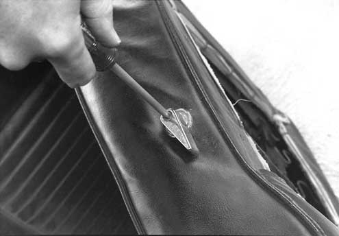

P40438_image_large

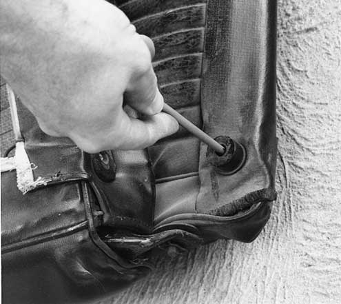

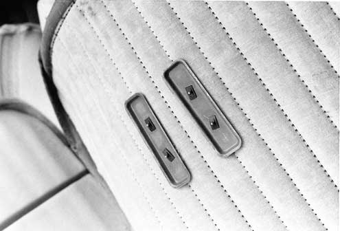

Both 1967 and 1968 Interior Decor Group (Deluxe) seat backs employ medallions, which are held in place with backing plates that are retained with tinnerman’s nuts. Simply measure the braking plates’ location on the original upholstery...
P40439_image_large
...then apply these measurements to the new upholstery.

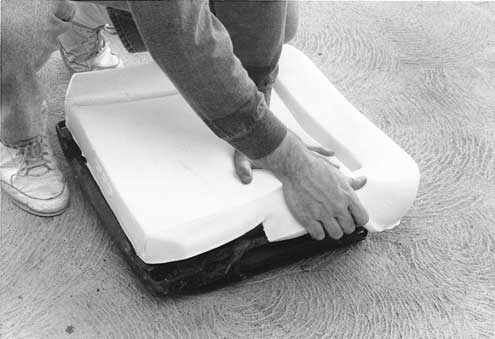

Virginia Classic Mustang supplied us with new seat buns that will give the seat bottoms a firm support.

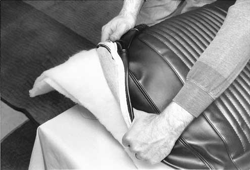

P40441_image_large
Find the upholstery's center, then mark the center, as shown. This is a very important step and is critical to the proper centering of the upholstery.

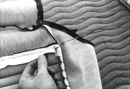

P40442_image_large

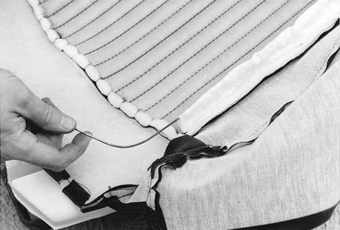

Feed the new listing wire into the new upholstery, as shown. Coat-hanger wire is an excellent substitute if you're caught on a Sunday without a source for new listing.
P40443_image_large

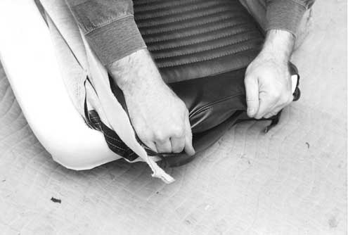

After we have hogringed the perimeter of the seat center in place, it's time to pull the outboard segments over the edges for hogringing.
P40444_image_large
Now that we have pulled the outer segment tight, it's time to hogring from the center outward.

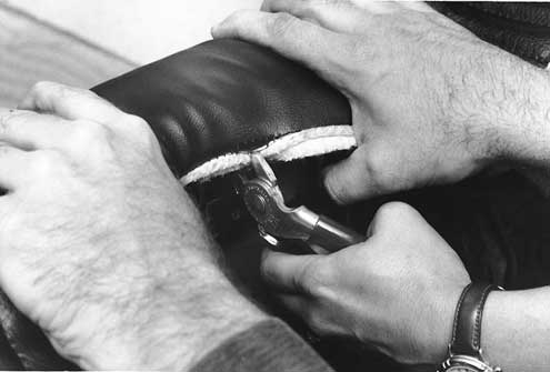

Inboard segments are hogringed, as shown. Note the use of hogring pliers, available from any upholstery supply shop.
P40447_image_large
Perimeter listings are hogringed once the upholstery is pulled tight.

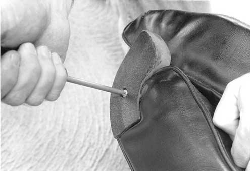

P40448_image_large

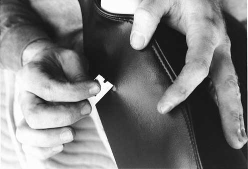

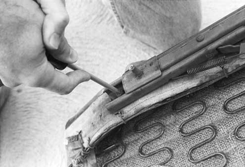

The seat-back pivot pin is carefully exposed with a razor blade. Carefully split the vinyl around the pin.

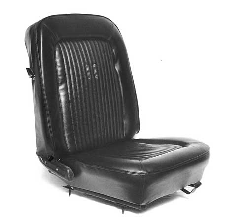

With the seat pivot covers installed along with the seat-back release latch and seat-back cover, our Shelby bucket seat is ready for installation.

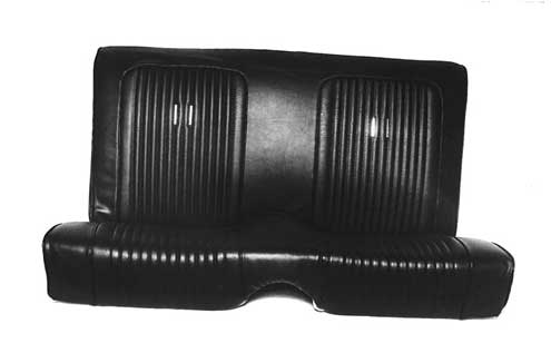

Rear-seat upholstery installation is easy. Slip the listing into the new upholstery, as shown.
P40453_image_large
With our center listings hogringed, we're ready to pull the outboard upholstery over the edges for the remainder of the hogrings.
P40454_image_large
Pull the edges underneath, as shown, and hogring in place.
P40455_image_large
A good practice is to hogring from the center outward. Pull each segment underneath, and hogring from the inside out.
P40456_image_large
Our completed rear seat looks terrific, thanks to Virginia Classic Mustang. Now we're ready for installation.
