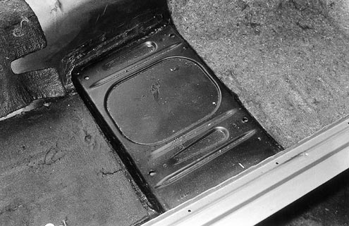

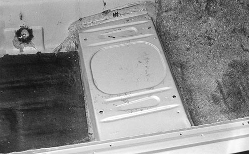

Classic Mustang seat pans are simple in scope. Each is a separate stamping that is spot-welded to the main floorpan as shown. The seat pan is not only for the seat but also for floorpan stiffening and support.

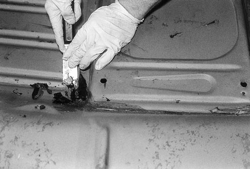

First, remove the petroleum-based factory seam sealer at the seams as shown. A putty knife and lacquer thinner works well for this purpose.

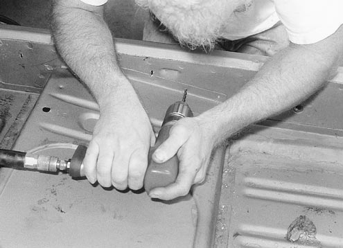

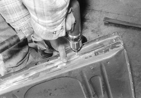

Jerry Choate tells us he has used spot-weld cutters to cut through factory spot welds; however, cutting tips are expensive, brittle, and tend to break. Jerry suggests using a 1/4-inch drill bit first, drilling down through the first layer of steel as a pilot hole. Do not drill through the second layer.
P98271_image_large

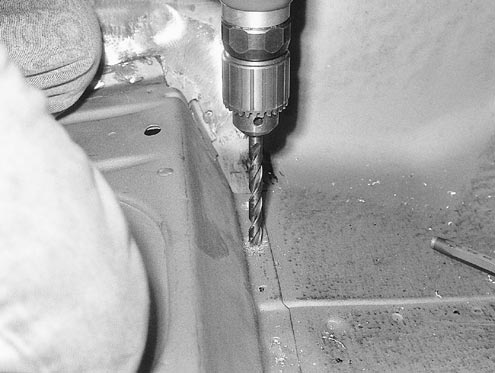

Next, take a 1/2-inch bit and drill down through the first layer only. This weakens the spot weld.

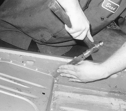

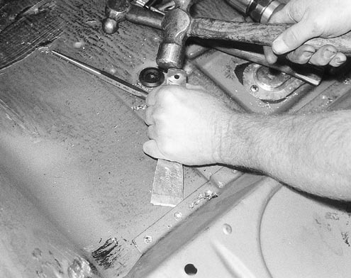

Using a chisel, separate the seat pan from the floorpan as shown.
P98273_image_large
If the pan won’t separate, drill at the spot weld, work the edges, then hammer again.

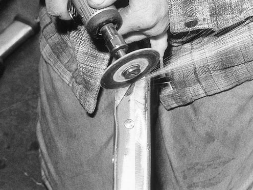

The seat pan is stick-welded along the drive- line tunnel. Cut the stick weld as shown with a grinder to separate the seat pan from the tunnel. Eliminate the stubborn spots with a chisel.

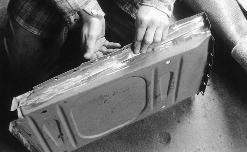

Lift the pan out and get to work.

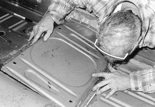

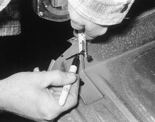

The folks at West Coast Classic Mustang measure the pan up 1 inch from the stock lip as shown, then mark the pan.
P98277_image_large
Once the pan is marked, we run masking tape along a 1-inch line above the lip, where we will cut the pan. A good rule is to keep your cut below the seat attachment points. These attachment points offer needed strength. Do not cut these reinforcements because this will weaken the pan.

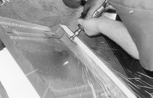

A die grinder buzzes through the pan, which will leave a clean edge. You can either bend in a new lip here with a sheetmetal brake or follow the approach you’re about to see used by West Coast Classic Mustang.
P98279_image_large
Clean up the sharp edges with a grinder as shown. Watch your hands!

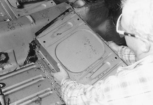

Choate fit-checks the modified seat pan. Some areas, including the inside attachment point, must be trimmed.
P98287_image_large
With the seat pan properly trimmed for a near-perfect fit, Choate checks the floorpan seat attachment holes and the seat pan holes for proper alignment. Make sure you can get a socket wrench up through the pan to install and tighten the seat attachment nuts.

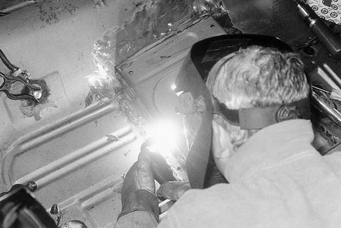

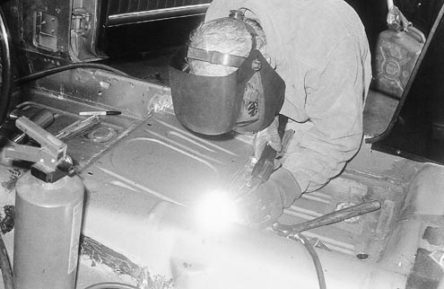

Choate begins the installation with a series of tack-welds, then he checks the fit again.
P98289_image_large
The seat pan is welded at the spot welds and along the new seams.
