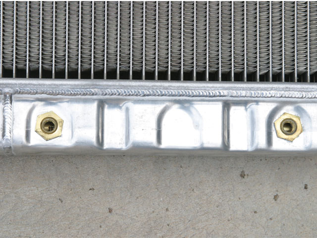

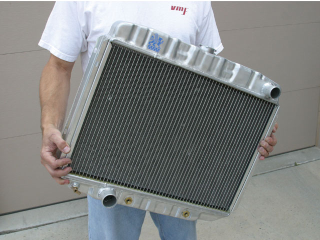

This is the 24-inch Griffin aluminum radiator for '67-'70 Mustangs with FE big-block power.The radiator provides unequalled capacity, pulling more heat out of your engine than a stock 2-3-row copper/brass radiator. You still need a fan shroud for proper cooling with the fan positioned so half of it shows.
0610_mump_03z Classic_ford_mustang Aluminum_radiator_close0610_mump_04z Classic_ford_mustang Aluminum_radiator_drain

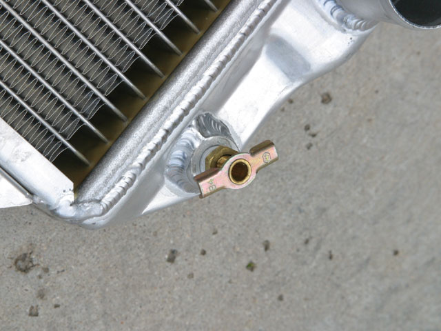

Griffin delivers all the things you expect and need from a Mustang radiator, including an automatic-transmission cooler and drain petcock. All you have to do is transfer automatic-transmission-cooler line fittings.

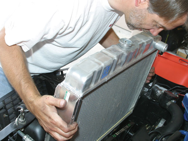

We're installing a Griffin aluminum radiator in a '69 Mustang GT convertible with a 390 High Performance V-8. The car is in Tucson, Arizona, a place legendary for its searing heat and summertime monsoons that bring unbearable humidity. It's not uncommon for the mercury to reach 120 degrees F with a blazing sun unmatched anywhere short of the Middle East.
