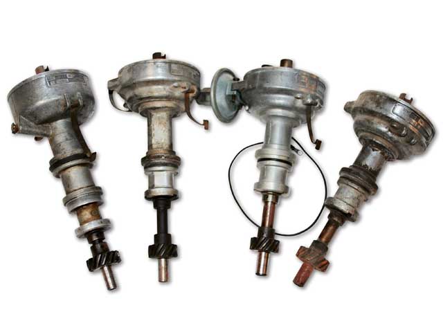

Here are the four most common types of vintage Mustang distributors. From left to right, '641/2 FoMoCo with oil access--this particular unit is for a 427, but it's similar to the small-block versions used in Mustangs, '65-early '67 FoMoCo, late '67-'71 Autolite, and '72-'73 Motorcraft.

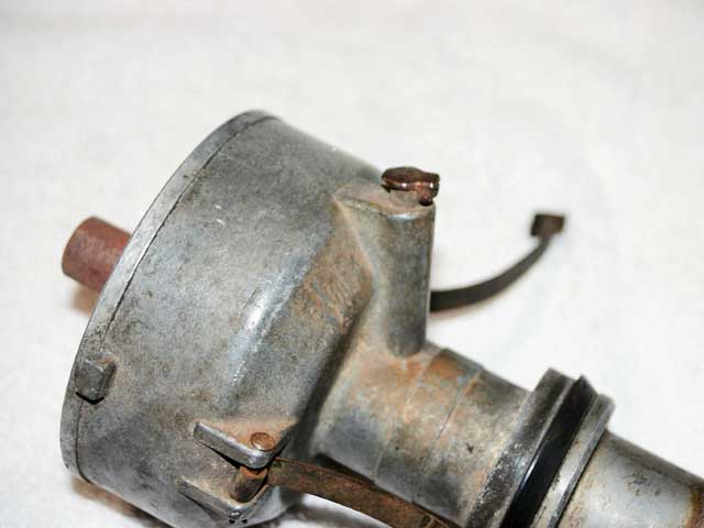

Distributors used in '641/2 Mustangs, those built prior to Ford's 1965 production change-over, included this oil access hole and cap for lubricating the distributor shaft. Later distributors do not have this hole.

Basically, there were four different types of distributors from '64 1/2 to '73. In '641/2, the distributors were marked FoMoCo and are easily recognized by the capped oil hole for lubricating the distributor shaft. In '65 through most of '67, Mustang distributors were also FoMoCo, followed by a switch to Autolite later in the '67 model year. The Autolite distributors were used through the '71 model year until they were replaced by Motorcraft versions, which were used in '72-'73 and for a number of years after as service replacements.
