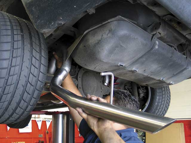

The installation of a DynoMax after-cat exhaust system was only part of our complete exhaust-system upgrade. The shop techs at X2C Motorsports also installed BBK headers and a BBK X-pipe. The entire package is available straight from California Mustang's warehouse.

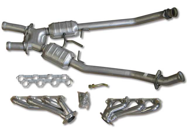

BBK's 1 5/8-inch shorty headers come complete with new gaskets and header bolts. They're available ceramic-coated, as shown here. The X-pipe includes related hardware and is ready to install. Be sure to specify what year car you have, since there are differences in the pipes for '86-'93 and '94-'95 5.0s.

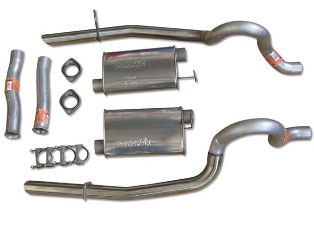

DynoMax's after-cat exhaust systems for Mustangs are staples in the exhaust aftermarket. We've had them on numerous cars over the years, including a 347-powered Fox 5.0, and we love the sound. Muffled nicely with the two-cat X-pipe, the DynoMax mufflers have a mild and mellow tone that still has a throaty 5.0-style sound when the gas pedal is tickled. The complete setup includes the tailpipes, mufflers, and mid-pipes that connect the mufflers to the X-pipe. Muffler clamps and hardware are also included.

Furthermore, we had the pleasure of working with X2C Motorsports, a competent late-model Mustang performance shop in the Los Angeles area. The techs at X2C made it look easy, having the whole system on the car in well under four hours, even though we stopped them often to photograph the installation.
