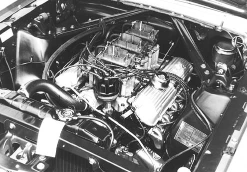

What would the engineering number be on the tri-power shown here? More to the fact, what do those numbers mean?

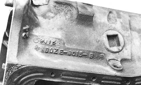

A Boss 302 block decodes as follows: D0ZE-6015-B. D is for the 1970s, 0 is 1970, Z is for Mustang, and E is for engine. The 6015 is the basic part number and the B is a suffix for alterations to the design; the alteration letters go from A to ZZ.

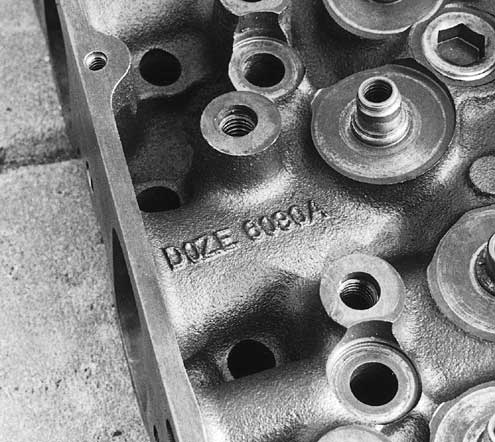

Cylinder heads have engineering numbers too. According to the part number, this head is a 1970 Boss 302 head.

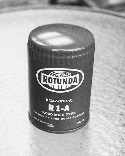

Parts Program items, such as this filter, received a part number rather than an engineering number. The part number breaks down this way: C-1960, 1-1961, A-Galaxie, Z-Ford Parts and Service.
