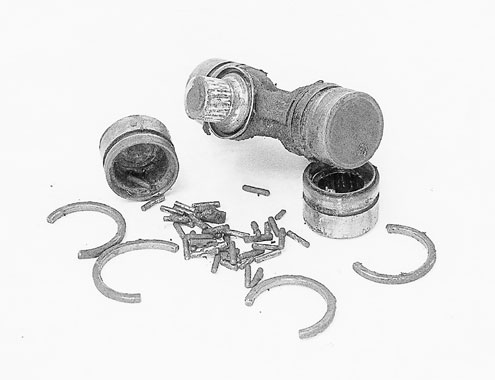

P92451_image_large
Original factory universal joints—if still on your Mustang—do not have any provisions for greasing them, but replacement joints do, and should be checked and lubricated regularly. If you have any vibrations in your driveline or hear a squeak-squeak-squeak sound that gets faster as you drive away from a dead stop, replace your universal joints before they fail and cause major problems. More than likely, if you have a vibration or squeaking sound, the joints already look like this one.

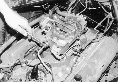

Periodically inspect all fuel hard lines and the rubber fuel hose for leaks. With engine vibrations, the hard line between the fuel pump and carburetor can loosen or crack with age. The rubber hose is susceptible to rot and grease and other corrosion-inducing chemicals, so inspect the entire length of the hose and its clamps. Don’t forget the short section of hose of the gas tank.

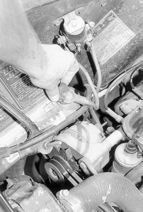

Battery cables easily corrode with the little use most vintage Mustangs see. Keep the cables and battery posts clean and tight, and we strongly urge the use of a battery terminal coating—even grease—to prevent voltage-reducing corrosion buildup. Don’t use emergency repair cable ends. Instead, purchase complete replacement cables. Lastly, if you buy auto store replacement cables, be sure to purchase your positive cable in red and your negative cable in black. Doing so will reduce confusion and increase safety in the event that you need to charge or jump-start the battery.

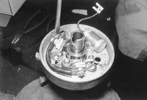

If you haven’t upgraded to an under-cap electronic ignition system—which we strongly urge for reliability—then carry an extra set of points and a condenser with you, either in your toolkit (see sidebar, on p. 69) or in your glovebox. A five-minute point replacement can make the difference between sitting on the side of the road and getting home before dark.

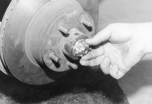

Inspect your wheel bearings twice a year to maintain proper wheel-bearing preload, which can affect handling, alignment, braking, and more. The bearings can lose their grease when a bad grease seal or loose bearing dust cap is present. Maintaining the dust cap seal is important to long bearing life, as it keeps bearing-race-killing dirt and grease-dissolving rainwater out of the bearings.

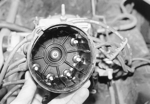

P92459_image_large
Moisture buildup from the ionization inside the distributor cap causes corrosion of the cap’s terminals. Check the cap every six months, and clean and file the terminals for a smoother running engine. You can also drill a small vent hole in the cap—similar to a late-model cap—to reduce the moisture buildup.

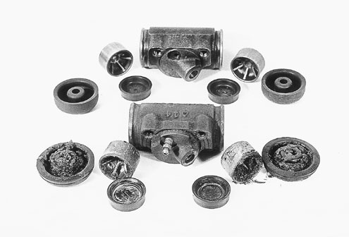

Need more proof? Flush your brake fluid annually. If you don’t, the inside of your wheel cylinders could easily look like this in a year or two. Flushing the fluid out also rinses out the dirt and broken-down rubber particles in the braking system. Stopping power is reduced and loss of fluid from the wheel cylinders is practically guaranteed if you don’t maintain the fluid quality.

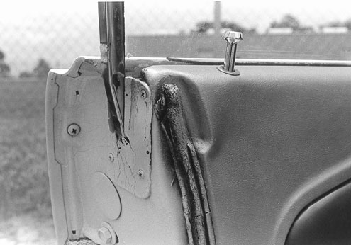

P92463_image_large
Many vintage Mustangs on the road have original or missing seals and weatherstripping. Old, hard seals do little for driving comfort by allowing road noise, dirt, and water to enter the passenger area. Installing a new seal kit around the doors, new felt window runs—to prevent rattling windows—and even front and rear window gaskets can make a big difference in the quality of your drive.
