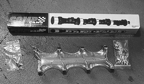

P79517_image_large

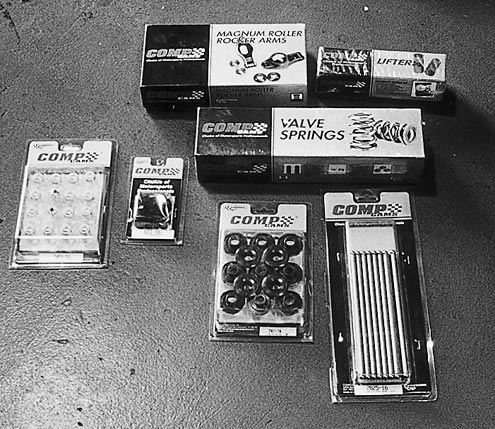

Everything you will need to install a roller cam in your Cleveland is available from Competition Cams.

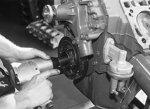

P79519_image_large
In order to correctly install the cam, we suggest you remove the engine from the engine bay. The intake, heads, oil pan, water pump, fuel pump, and balancer will have to be removed in order to facilitate the install.

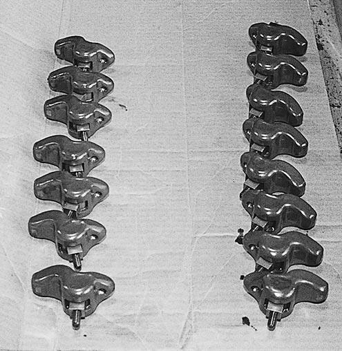

When you disassemble the engine, make sure you lay out the components that you are removing in the order in which they are in the engine. Do this with your old cam and lifters as well. Though they may not be the latest, you might be able to sell them to a fellow Cleveland owner.

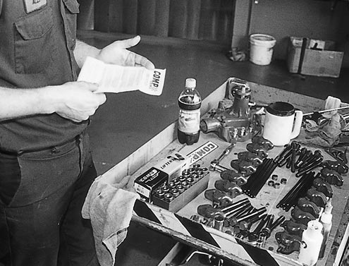

Be sure to read, follow, and understand all the safety instructions. Wait, that’s Norm Abrams’ line! Make sure you read the cam card and the instruction sheet for your cam.

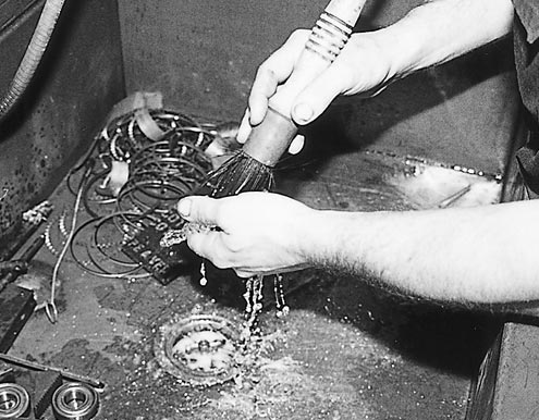

P79522_image_large
Allan West at Regional Performance Machine recommends washing the parts with carb/choke cleaner to remove the Cosmoline. This parts washer is a clean box and never sees anything but clean parts that need to be washed down. Details such as this make a shop such as Regional a comfortable place that provides excellent work.

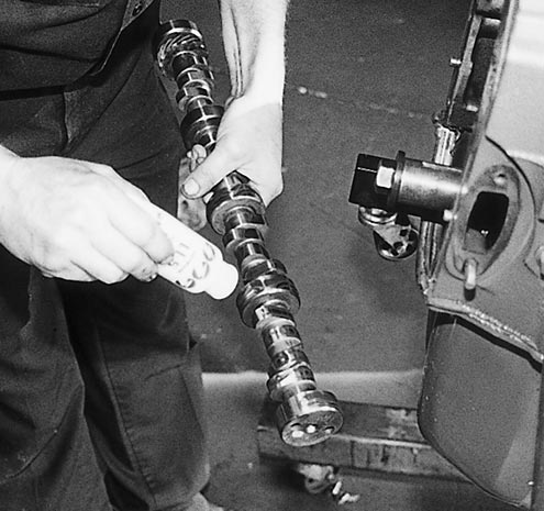

P79523_image_large
The cam is lubed and set into the block. West rotates the cam in the bearings to make sure there is no binding or problems.

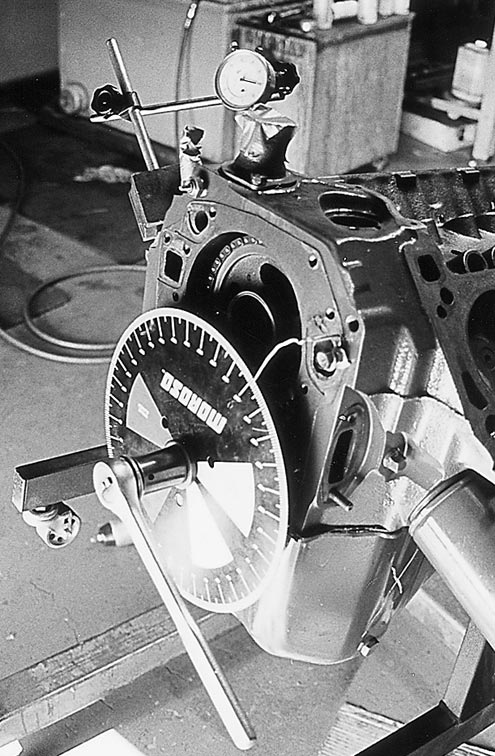

Next, West checks each lifter for correct operation and sets two in the No. 1 lifter bores. The multi-index timing chain is installed and a degree wheel is used to make sure the cam is correctly degreed in. This step is outlined in the instructions and is essential. It could make the difference between your Cleveland being a stallion or a mule.
P79527_image_large
Powerhouse Products offers a cam degree kit (PN POW101580), which includes everything you’ll need to degree your cam right down to a fixture such as this that allows you to stop the piston in the hole wherever you want.

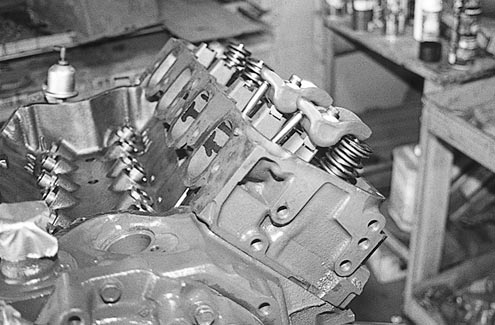

P79528_image_large

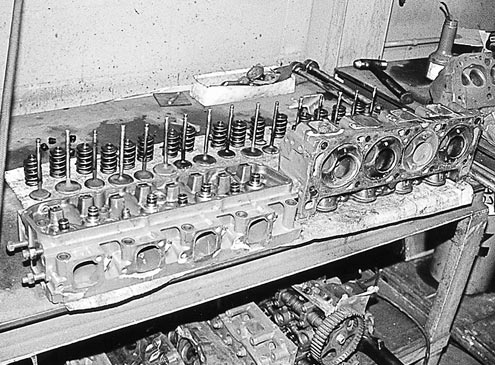

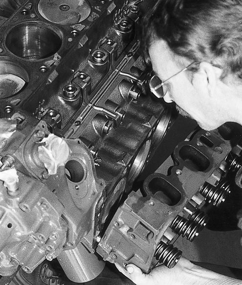

The cylinder heads are disassembled and the valves are laid out in order. The single valvespring will be discarded in favor of the dual valvesprings provided by Competition Cams.

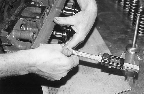

P79529_image_large

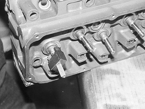

West checks all the valves for their installed height. The height can vary on different valves and should be checked with a digital or dial micrometer. For instance, a valve may sit deeper in a seat and cause the spring pressure to be different.
P79530_image_large
Since the springs should be at the same installed height across the board, shims must be used on some valves.

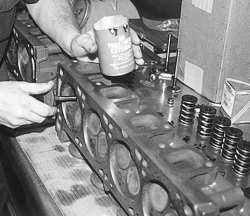

P79532_image_large
West uses oil on the stem to install the valves. Though he uses a super-slippery product, standard 40-weight motor oil will suffice.

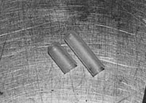

P79533_image_large

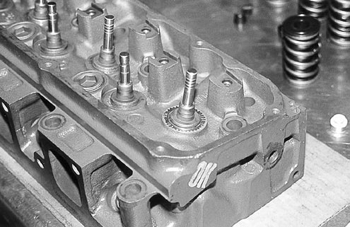

West uses these sleeves when installing the PC oil seals. They insure against gouging the seal and creating an oil-consumption problem.
P79534_image_large

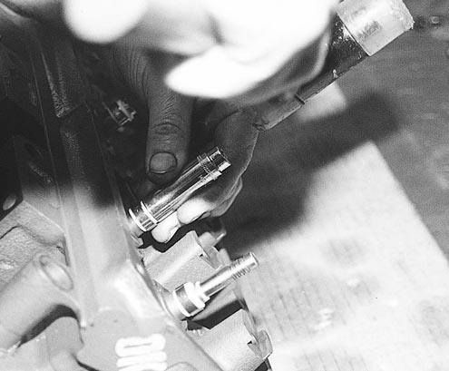

The covers are used to keep the valve from damaging the seals. These caps are available from Competition Cams. West uses a socket to tap the seal into place.

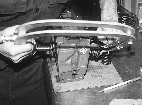

The valvesprings are placed in the head at this point. West uses a really trick air-operated spring compressor for the task. You can rent a standard one from the local parts store.

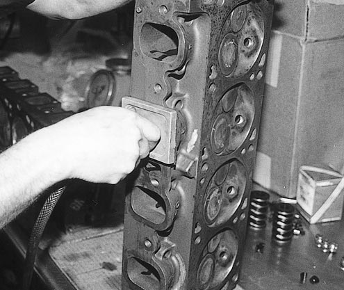

West uses a vacuum pump to check for leaks in the system. All the valves held vacuum, assuring us that the heads will seal and make good power.

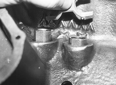

Those Xs behind the lifters in the corners of the valley are a problem with installing the roller cam conversion in the Cleveland. They interfere with the clean operation of the spider. On our engine, three out of four of these had to be ground down to make sure we had smooth function.

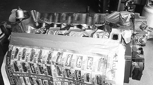

P79538_image_large
Obviously, the one thing you don’t want are metal shavings in the lifter valley. Clean out the valley with a shop towel soaked in carb/choke cleaner. Then cover every orifice on the block with duct tape. You’ll need a “nurse” using a shop vac to remove the shavings as you grind away the Xs that interfere.

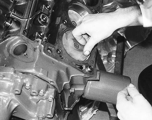

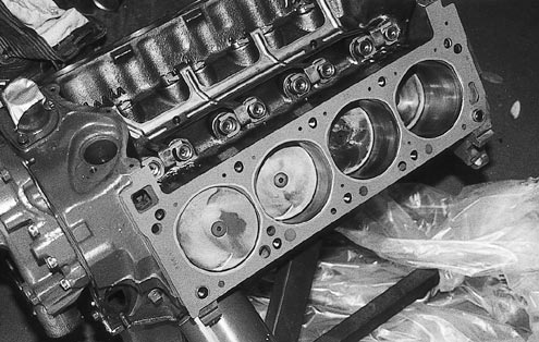

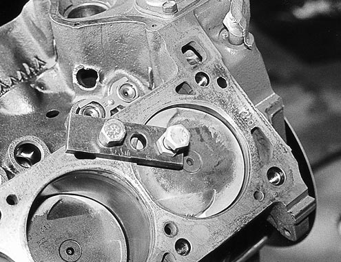

Use some Play-Doh in the valve reliefs to make sure the valves don’t kiss the piston at the top of the cam’s travel. Even with a 600-plus lift cam, we have no problems.
P79540_image_large
When doing this, don’t install the gasket. If the valve does not strike without a gasket, then it won’t with one. At this point, we installed our ROL head gaskets.
P79541_image_large
We like the ROL gaskets for good sealing and hard use. Make sure the gaskets that say “front” are facing in that direction.
