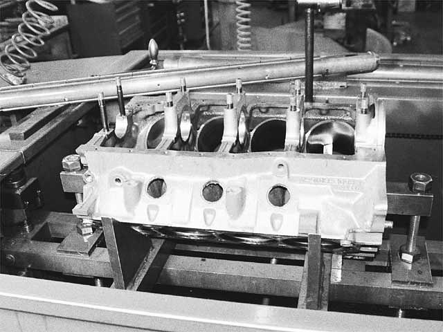

1. Our '68 vintage block received the full brace of machine work(line hone, surfaces decked, clearancing, bored .030-inch over, and soon) before it was ready for final assembly. Full balancing andblueprinting as well as ARP fasteners are included in the deal.

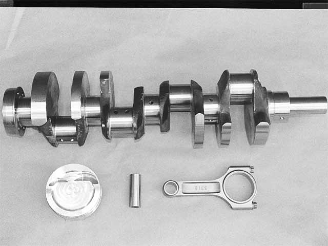

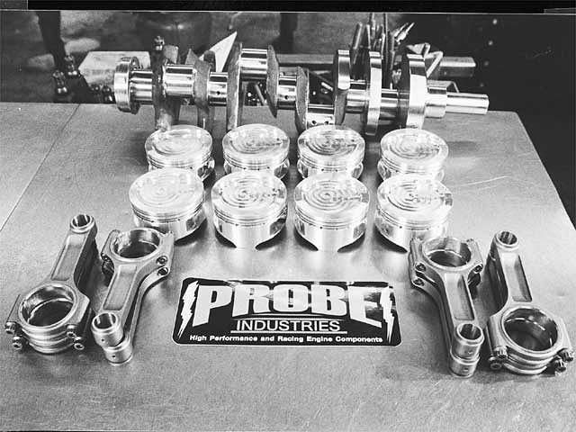

2. From Probe Industries, the long-stroke crank is a 4340forged-steel piece featuring stock journal sizes. The Probe rods arealso of 4340 steel and are 5.315 inches long.
3. Forged Probe pistons are of 2618 aluminum alloy and featurevalve reliefs for both standard or TFS Twisted Wedge heads. The pistonis a flat-top design that specs at 10:1 compression. The rings are aChilds and Albert file-fit package.

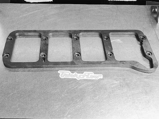

4. Paul has found the TFS girdle to be the strongest on themarket and uses it exclusively.

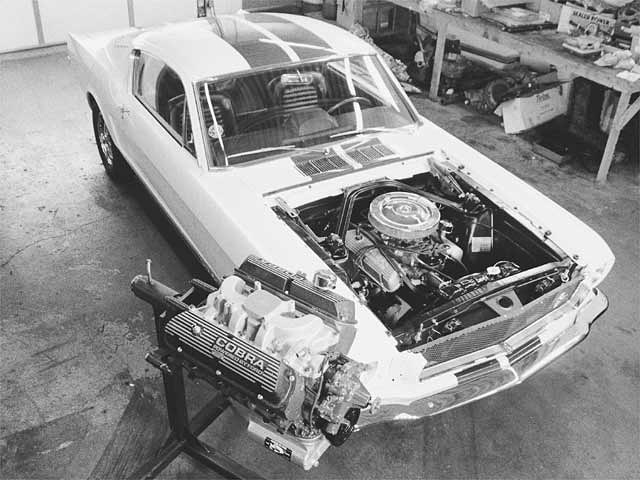

While just about every corner-store speed shop offers some form of the 347 Ford small-block, Paul's has separated itself by being a little sneaky about the appearance of the finished product. They've gone the extra mile, outfitting the engine with all of the correct 289 Hi-Po dress for a stealthy combination that will fool most car-show judges and dish out enough power to slap any late-model you might run across. These little details on the exterior can include such things as a date-coded block, painted aluminum heads in the original Ford blue, fuel pumps modified to accept the correct filter canister, intake bolts painted ala Shelby, correct 289 Hi-Po air filter, and a utilized date-coded balancer, distributor, intake, timing cover, and water pump. Put it all together and it's hard to tell if it's a 200-horse stocker or a 400-horse stroker!
