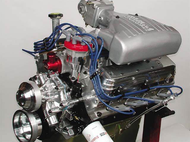

There's no law against dressing up emissions-legal engines, and CoastHigh Performance didn't spare the eye-candy when dolling up its project347-E. With a guesstimated 400 hp (we hope to have dyno numbers later),it's definitely a good-looking engine. The polishing is a $799.99 optionfrom Coast when applied to the heads, intake, water pump, andalternator.

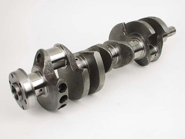

These days, maximum displacement in a small-block is as easy as reachingfor a 3.400-inch stroker crank. Coast uses a variety of these--this oneis from SCAT and will easily support 500 hp.
Otherwise, the 347-E swings the same cast-steel crankshaft and forged connecting rods in a factory new block as other Coast High Performance 347s. This gives the 347-E the same durability and muscle as Coast's other stroker-replacement short-blocks.
Of course, a short-block is just that--it's not a complete engine. What we're detailing here is Mark's idea of how a 347-E could be dressed with emissions-legal cylinder heads and induction to produce a completely emissions-legal engine. Think of it as a pile of CARB Exemption Orders stacked atop each other. Specifically, Mark is using a set of World Products Windsor Jr. castings he had on hand to top his short-block. Wanting to build as powerful an emissions-legal engine as is reasonably possible, any of the higher-achieving street-legal cylinder heads (Edelbrock Performer RPM, AFR 185s, and so on) would have worked. The World Products castings are certainly capable of supporting all the power the E-legal camshaft can dish out.
In an interesting twist, this engine will also wear the new Edelbrock Performer RPM II intake manifold (see "Biting Back," May '03, p. 52). Again, this top-end happy EFI intake ought to support all the power the cam can make.

Coast has crankshafts in either 28- or 50-ounce balances. That allowsthem to match varying parts availability, early and late Mustangdampers, and the resulting three- or four-bolt patterns for the pulleys.Drilled like Texas oil country, the project engine's crank is a 50-ounceunit.

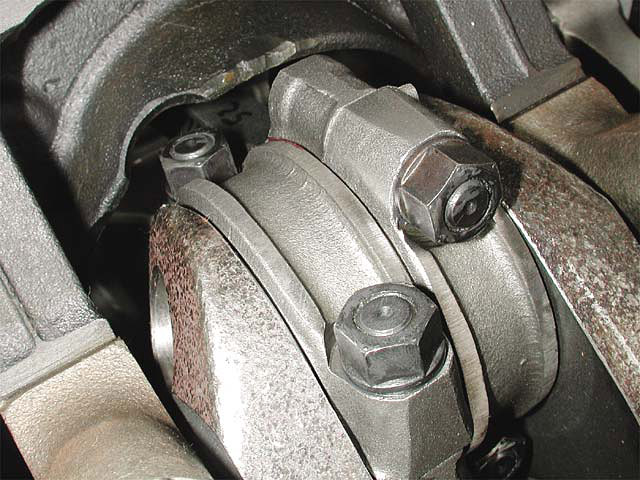

Coast's -E engines use the company's CNC beam-forged steel connectingrods. They measure 5.315 inches center-to- center and use athrough-style rod bolt. This helps hold down the cost compared tounnecessarily stronger H-beam rods. These rods have a slightly offsetpin bore to maintain rod angularity too.
