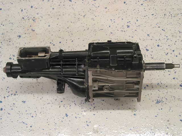

1. A freshly-rebuilt Platinum Torque T5, available from NationalDrivetrain, carries a 12-month unlimited-mileage warranty. These units,basically in new condition, come ready to go except for a T5 shifter.You can go with an aftermarket shifter or simply install a stockFox-body Mustang T5 shifter such as the one we obtained from MustangCountry International.

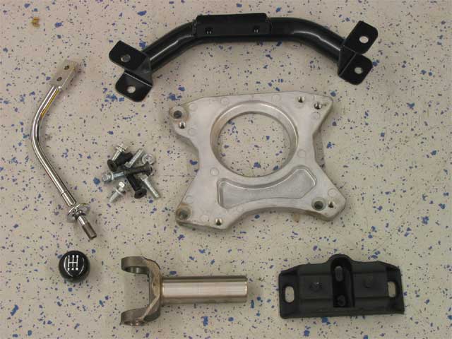

3. These are the pieces you need to install a T5 into a vintageMustang using a stock bellhousing. Available from California Pony Cars,included here from top to bottom are a T5 crossmember, an adapter plate,a T5 yoke, and a new transmission mount. Also shown at left are avintage-style shift handle that bolts right up to a T5 shifter, and avintage-style shift knob with a five-speed shift pattern embossed on it.To complete the puzzle, the yoke is installed on the existingdriveshaft, the driveshaft is shortened one inch, and two holes aredrilled into an existing Top Loader bellhousing--all of which can beaccomplished by a reputable automotive machine shop. We were able tohave the yoke installed, the driveshaft shortened, and the bellhousingmodified by a local shop in one day. California Pony Cars can alsosupply a modified Top Loader bellhousing.
