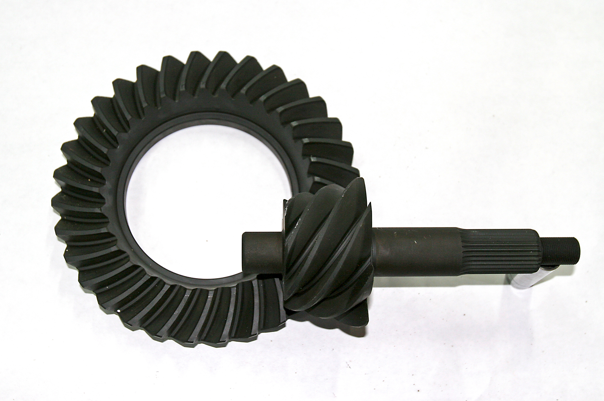

So you’ve got a sweet late-model Mustang that you’ve dumped a few mods into, but now you want to make it fly a little faster, right? One of the easiest ways to give your pony more pep in its step is to upgrade to a lower gearset out back. Typically, most 1994-present Mustangs are equipped with 3.27-3.55 gears from the factory, while Fox-bodies tend to have either 3.08 gears or, worse yet, the 2.73 gears that would be perfect for a NASCAR Super Speedway but are just about useless on the street. While these gears are fine for a stock car, a lower gearset will allow your Mustang to accelerate quicker into its powerband.
As you can probably guess, the higher the number, the faster the car will accelerate down the road. Numerically higher ratios are what we call lower ratio gears. For example, a 4.10 gear would make the pinion gear rotate four full turns as well as another tenth of a turn before the ring gear cycled through one full turn. The gears are able to take advantage of more engine power to get the car tracking faster on the blacktop. A numerically lower gearset, by comparison, will not accelerate quite as fast but will have more top-end speed.
