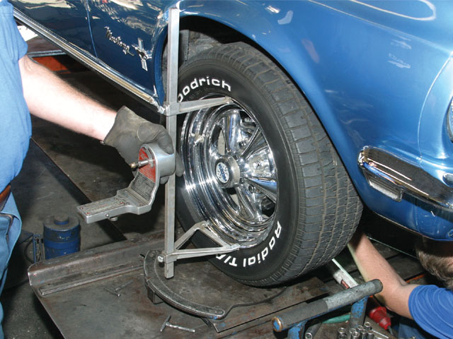

0610_mump_01z Ford_mustang_alignment Measure_wheel0610_mump_02z Ford_mustang_alignment Negative_camber

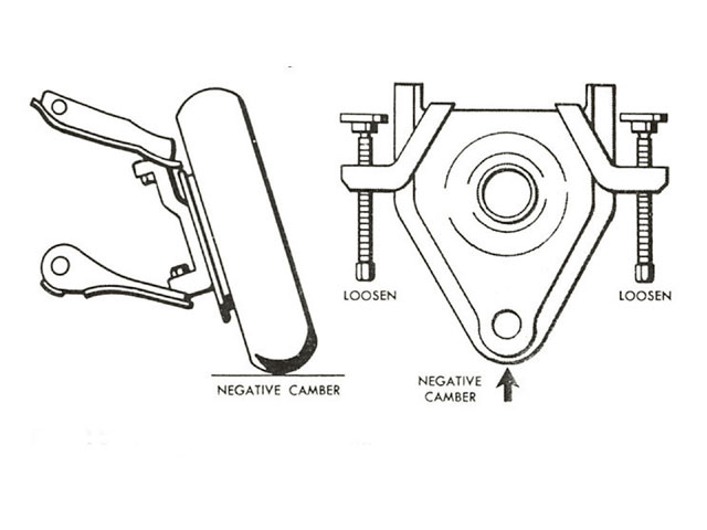

Camber is the angle that both front wheels are tilted at the top and bottom as they roll down the road. This is negative camber, measured in degrees. The top of the tire is pointed in and the bottom is pointed out. Negative camber keeps good tire contact patch on the road in turns. Mustangs do well with 1/4-degree to 1-1/4-degrees. For street use, 1/4 degree of negative camber is best. For road racing, you may want a pinch more negative camber.

It's easy to write off front-end alignment as something best left to professionals. But did you know you can do front-end alignment yourself? And did you know you can converse intelligently with your front-end alignment professional, assuming you can find one that still aligns vintage cars such as '65-'73 Mustangs?

Camber is the angle of the tire/wheel as it relates to the road. Think of the front wheels as your own legs. Positive camber makes you bow-legged. Negative camber makes you walk pigeon-toed, on the insides of your feet. So how does camber affect your Mustang? When you have positive camber, your Mustang won't corner well because each turn runs the front tires onto their sidewalls, which is why you'll never see positive camber in a front-end alignment-specs chart. When a Mustang corners, negative camber keeps more tire contact patch (tread) in contact with the pavement. Negative camber, with the vehicle at rest, assures some negative camber in a turn. Mustangs need 1/4-degree negative camber minimum, and 1-1/4-degrees maximum if you're going canyon chasing.
