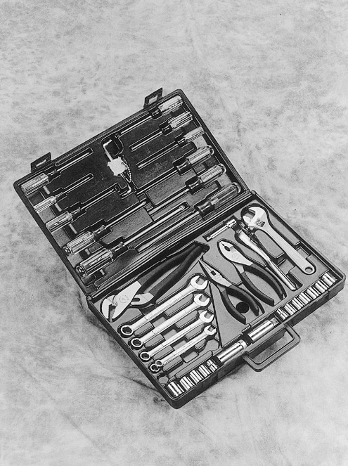

A small toolkit such as the one shown will be a big help for your day or night at the track. From minor adjustments to emergency repairs, you can never be too prepared.

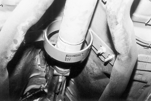

Even if you don’t have a fast car, you might want to look into installing a driveshaft safety loop. These devices prevent the driveshaft from flipping or pole-vaulting your Mustang if the front universal joint breaks. Age and driveline abuse can make a U-joint the weak link, and a loop will contain the driveshaft.

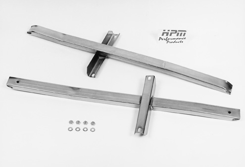

Subframe connectors can help your Mustang in more ways than one at the dragstrip. They prevent chassis-flex—which reduces weight transfer and traction—and they prevent the body from receiving permanent damage by the twisting motion of a hard launch.

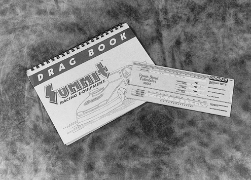

Two items that can help you become a better racer are the Moroso Power Speed Calculator and the Summit Racing Drag Book, both of which are available through Summit Racing. The calculator will help you determine your maximum e.t. for your mph and also has horsepower-to-weight ratio, gear ratio, and tire diameter calculations. The Drag Book is a logbook to help you record temperature, e.t., mph, and several other types of data for each run.

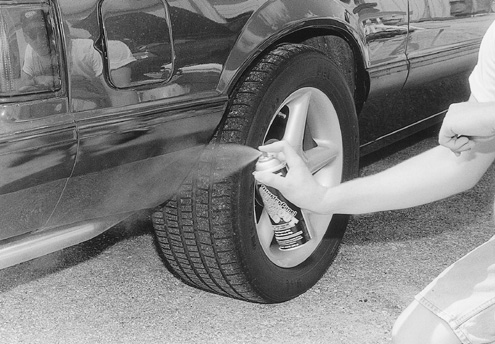

P142252_image_large
Geddex also makes another great product—especially for show people—called Burnout Guard. This product is biodegradable and washes off with plain water. Spray Burnout Guard on your quarter panels before racing, and the rubber bits from burnouts and track use that usually are difficult to clean off will easily wash away.

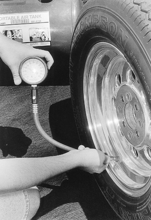

P142253_image_large
An accurate tire-pressure gauge is a must if you plan to run DOT-approved racing tires or slicks. One psi difference in tires can mean a lot as to how a car handles going down the track and how the car leaves the starting line. If you can swing it, a small air tank, such as the one in the background, is great to bring along.

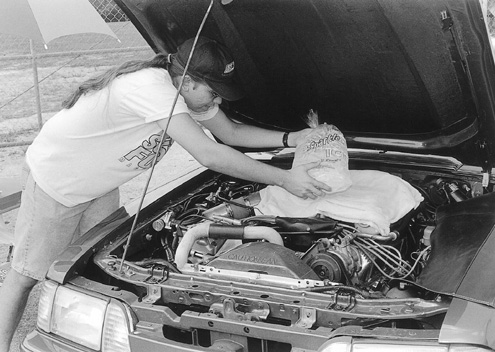

The 5.0 Mustangs love a cool air charge. Icing down the intake is a popular way to cool off everything. Using a towel under the ice to catch the ice water will prevent water puddling on the engine, which could get on the track, thereby causing you to lose traction.

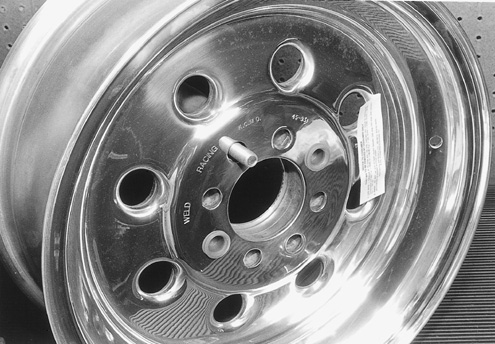

P142255_image_large
Many Mustang enthusiasts purchase lightweight street/strip racing wheels, with the Weld Draglite being the most popular. The Weld Draglites are great wheels, and they take off a lot of weight of the suspension (especially skinny fronts), but the stock-length wheel studs are barely long enough to keep them on the car. A safer bet is extra-long wheel studs. Available from most parts stores and performance shops, these studs have the extra length to secure these types of wheels with their correct long-shank lug nuts.

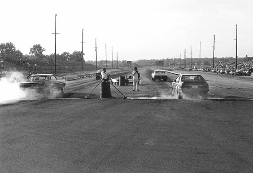

As stated in the text, if you’re using slicks, then by all means get them wet and smoke ’em up. Do not attempt to do your burnout in the water box. Wet the tires and then pull forward 1 or 2 feet. If you don’t have a spotter, then the starter will usually signal to you when the tires are clean and sticky. At that point, you can pull forward.

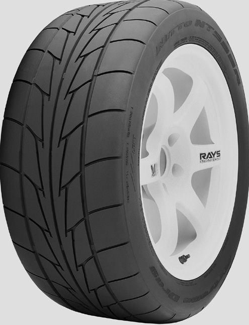

P142257_image_large

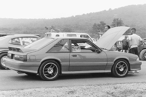

While your street radials will suffice for basic dragstrip use, if you want to really hook and get some good e.t.’s, then try using either a drag-type radial or a full-drag slick.
P142259_image_large
Both tires offer a softer compound for more bite and less tread lugs (or none at all) for more traction and a bigger contact patch.

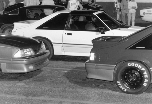

P142260_image_large

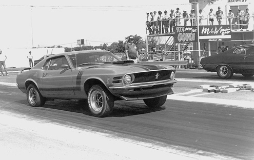

Vintage Mustangs can get in on the fun too. This ’70 Boss 302 has a set of slicks (Magnum 500s, no less—what a sleeper), and is trying to gun down the Torino in the next lane. Late-model versus vintage drag racing is popular at many Ford events.

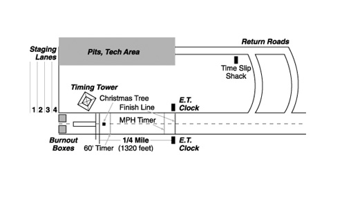

Now that you have a place in the pits and your tech card is filled out, take a good look around the track. Learn the location of the staging lanes (and how they are numbered), the racing surface turnoffs, and the return road. The timeslip receiving areas should be located as well. Knowing where these venues are and the path from the beginning to the end of a race will help everything go smoother and prevent any problems.

On most test-and-tune nights, they have a preset lane number for certain cars. Lane No. 1 might be for street-tire cars, lane No. 2 might be for cars with slicks, lane No. 3 could be for motorcycles, and so on. Listen to the announcer and get in the correct lane for your Mustang. If you aren’t sure, don’t be afraid to ask. Stay with your car, even if the lanes are long. You never know when things will pick up and you’ll be blocking all the racers behind you, which is most uncool. When you get toward the front of the line, stay in your car with your belt fastened and your helmet on (if one is needed).

Once the starter waves you into the staging area, proceed slowly. If you have street tires, then there is no need to go through the water box—simply drive around it. If you are running slicks, then by all means idle through the water to get the slicks wet. While a separate article could be (and has been) written about burnout techniques, if you talk to other racers, they can help you dial-in what you need to do for your Mustang’s power and weight. Proceed to do your burnout by either dumping the clutch (manual trans) to shock the suspension or by power-braking (auto trans). Listen for the tires to bite on the pavement, and then ease out of the throttle. Next is getting up close and personal with the staging beams.

After you leave the starting line, you will pass the 60-foot timer, and then travel the measured quarter-mile. Knowing when to shift your Mustang to the next gear will come only with practice. Keep good notes, and you can see what rpm for launching and shifting, tire pressures, and other items do for your e.t.’s. The finish line and the mph timer will be at the end of the measured quarter. Don’t let off the gas until you have gone through the finish line area. Otherwise, your mph will suffer.
Once you’re through the finish line area, you can safely begin your deceleration. Evenly bring down your Mustang’s speed, and look for the return road (usually on the right side of the track). Most tracks have more than one return road, so if you’re going too fast or miss the first turn, then you can use the second return road. Be on the lookout for the other racer if you have to cross into his lane to reach the return road.
The Tale of the Tape
Once you’re on the return road, keep your speed to a safe level (about the speed of a parking lot cruise), and follow the road to the small shed or shack where you will receive your timeslip. Don’t read the slip there, as other racers are directly behind you. Take the slip from the person manning the shack, and proceed to your pit location where you can read your timeslip. If you’re keeping track, log your e.t. into your timeslip book.
