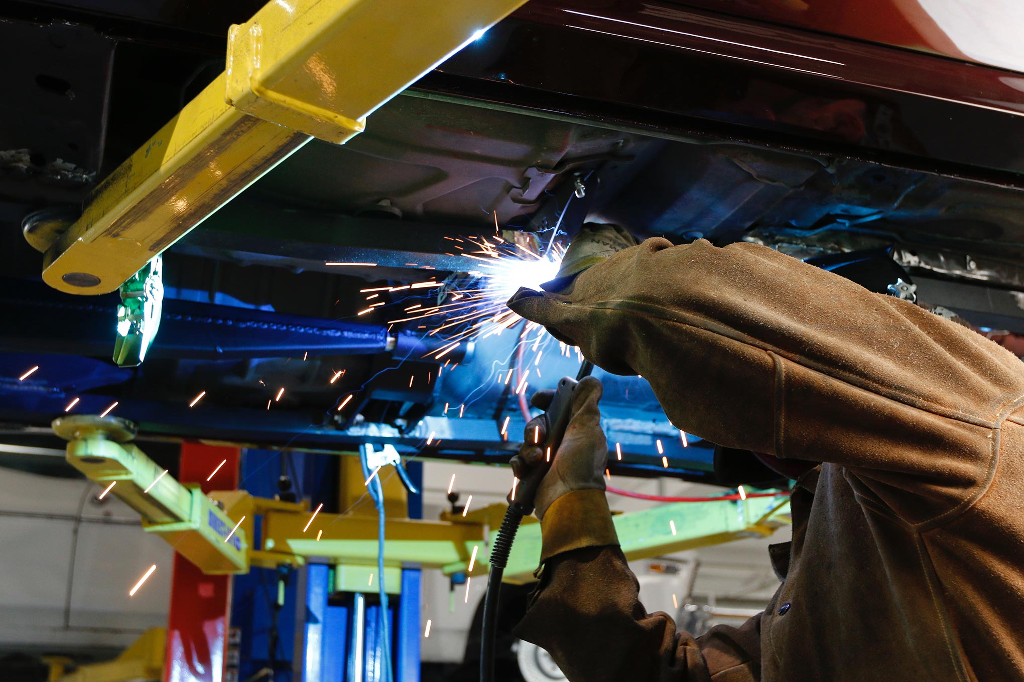

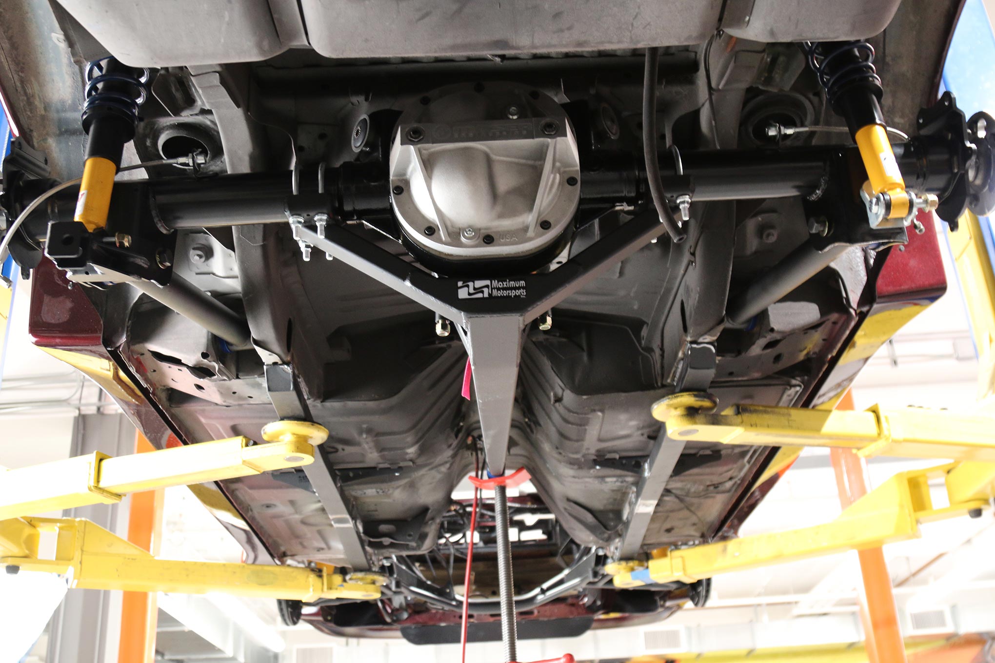

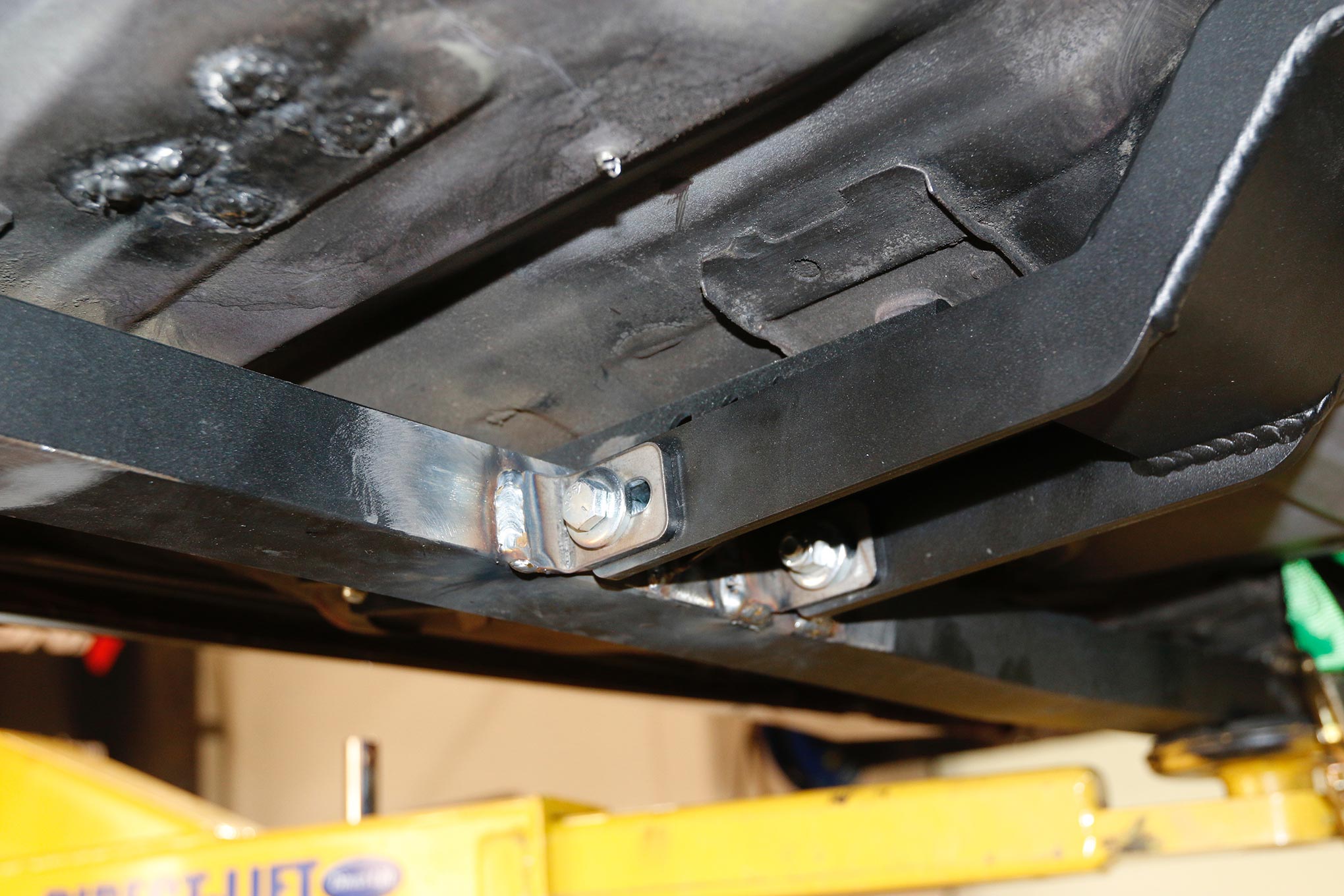

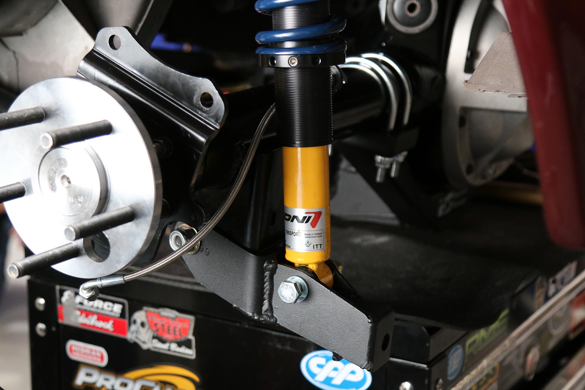

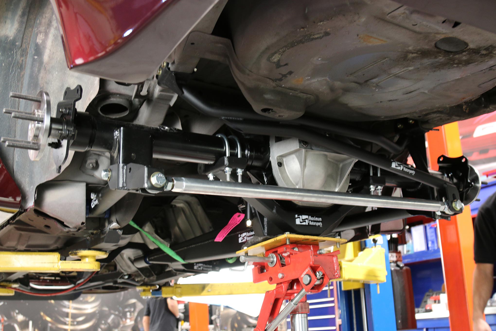

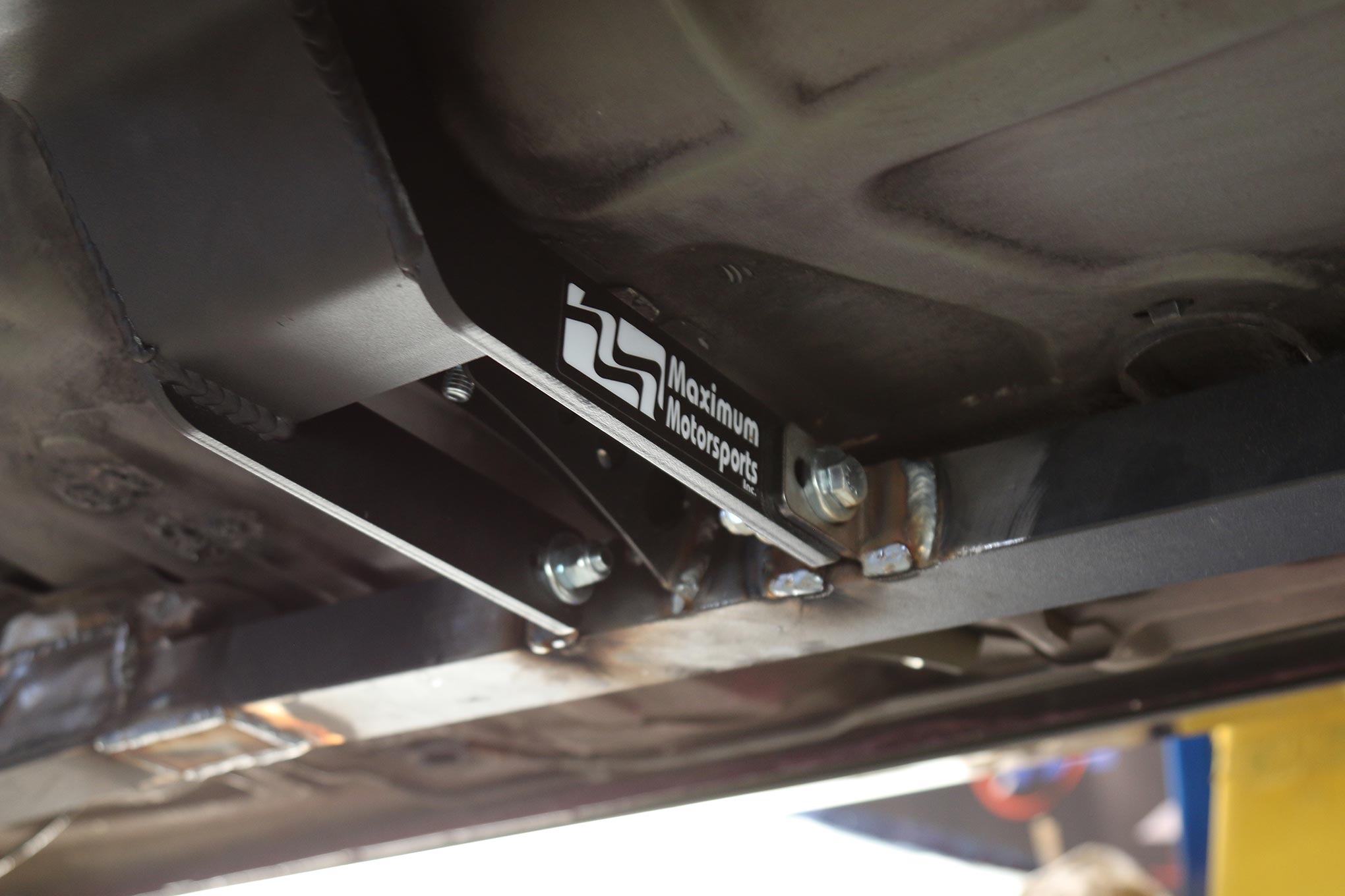

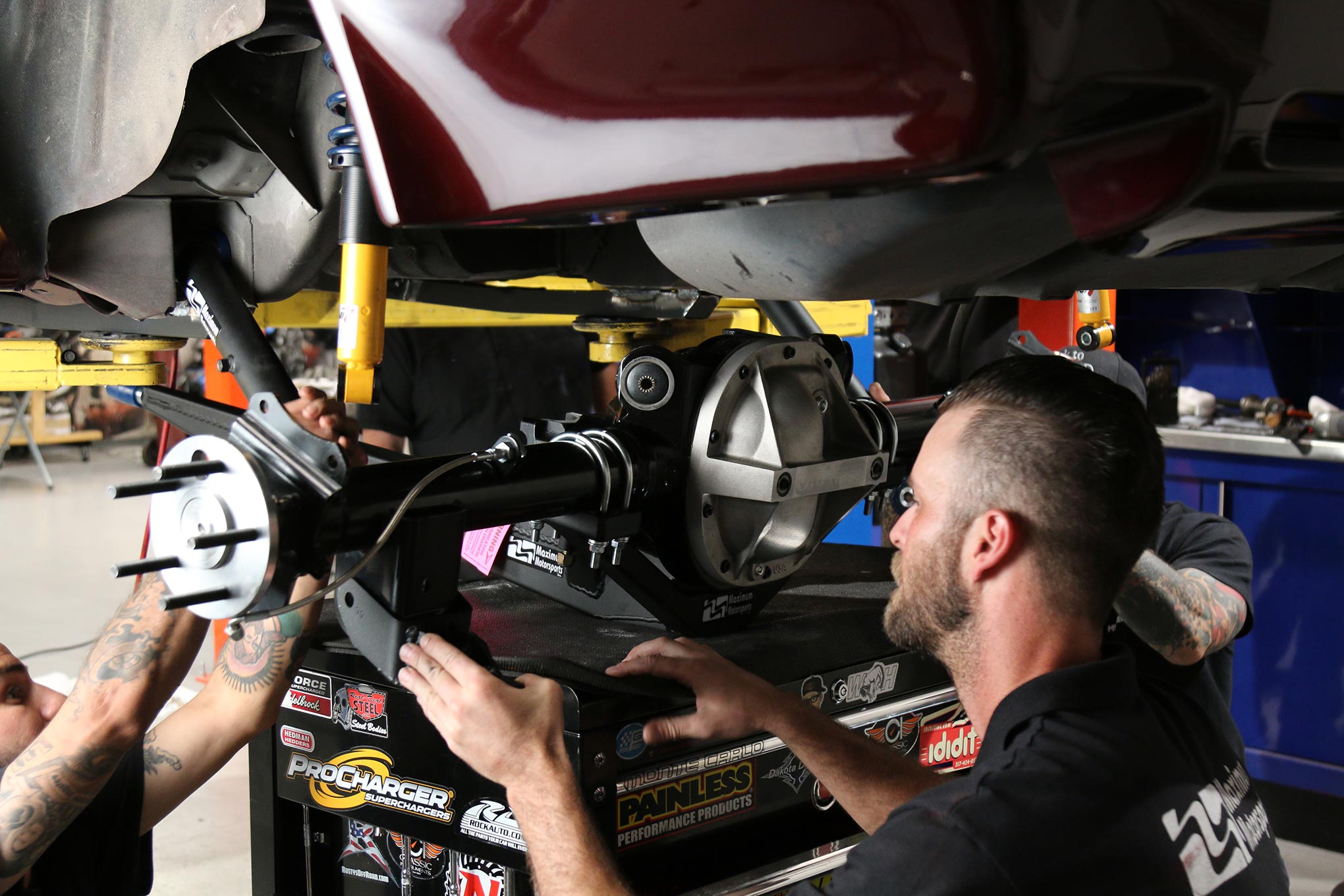

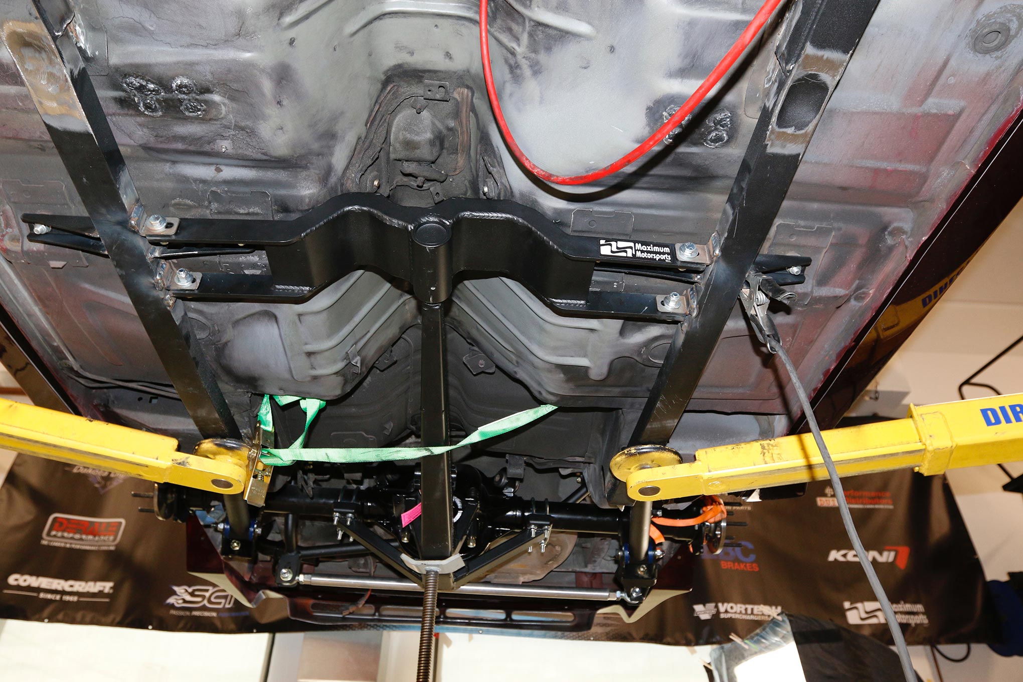

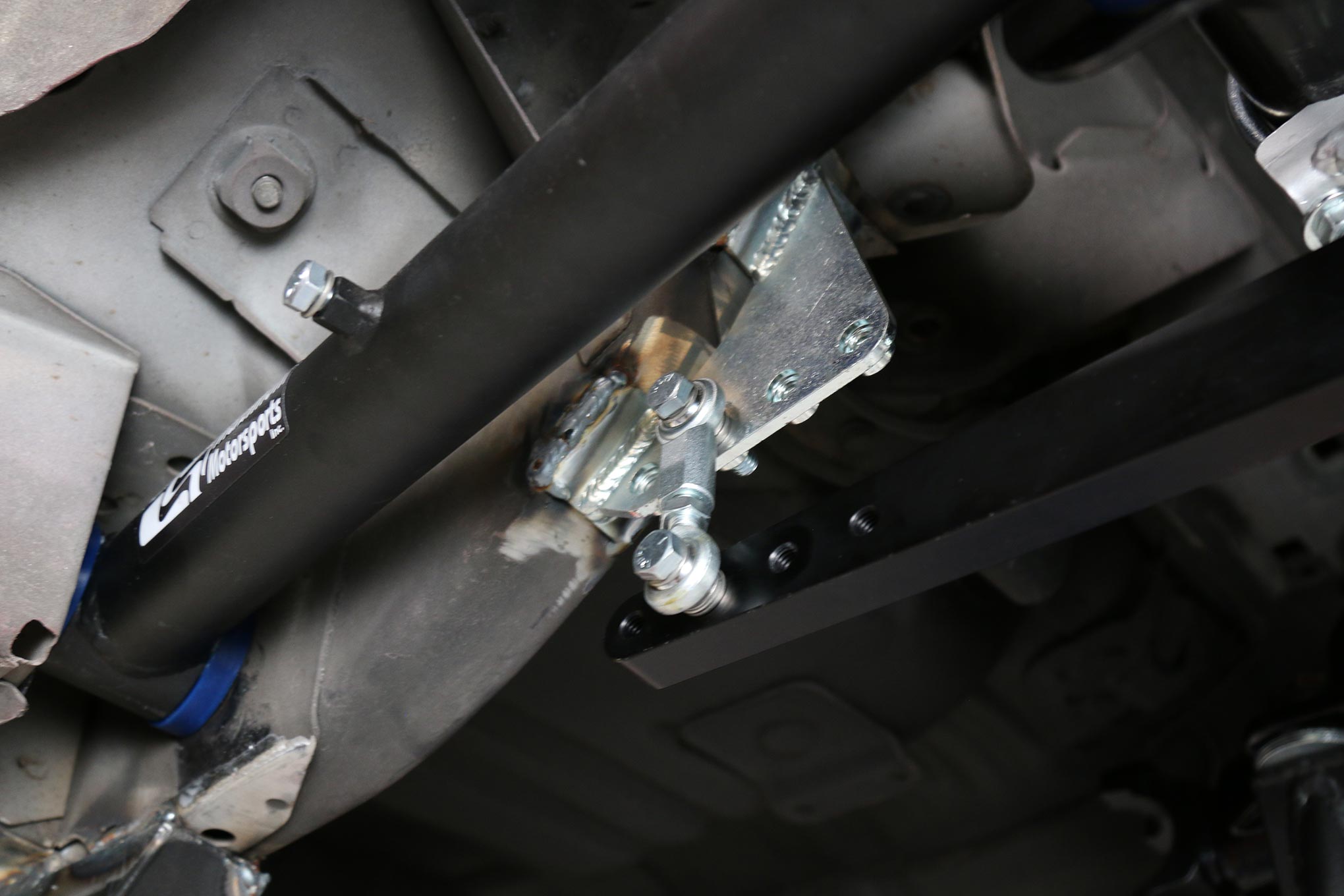

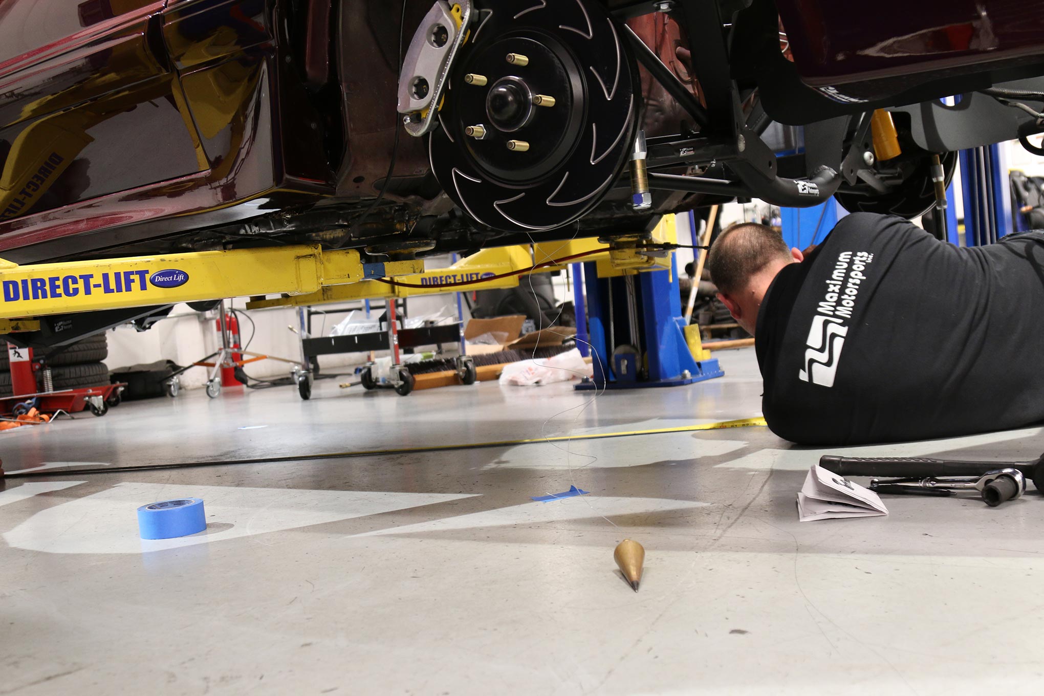

When we left off last night in our Week To Wicked 1990 Mustang LX Sport project, we had just removed the stock engine and transmission and installed most of the Maximum Motorsports suspension. After dinner and a night's sleep, we came back to the shop today to finish installing the rear suspension. Last night, we got the Moser rearend (with an Eaton Performance Truetrac and 3.73:1 Street Series ring and pinion) "staged" in place with the torque arm attached, so this morning was dominated with the completion of the rear suspension. The torque arm is bolted to the rearend housing at the back and a crossmember welded to the subframe connectors up front. Because not everyone that installs the subframe connectors opts for the torque arm, the front arm mounting brackets are not pre-welded to the connectors, so once the rear is in place and the torque arm is located, mounting tabs are welded to the subframe connectors for the torque arm crossmember. The panhard bar and sway bar were also installed in the rear.

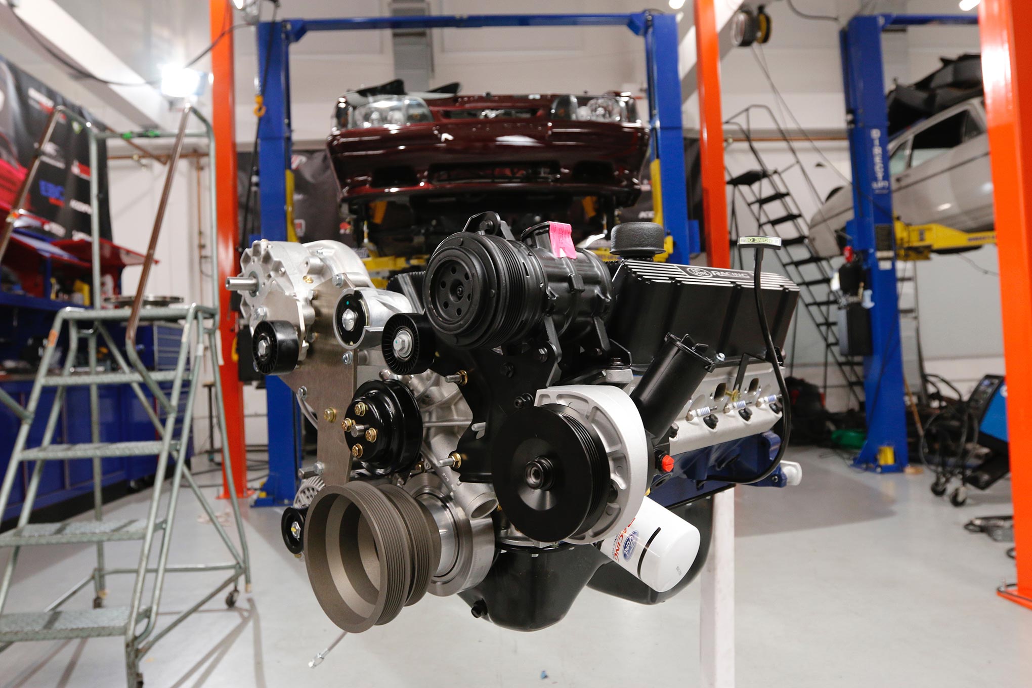

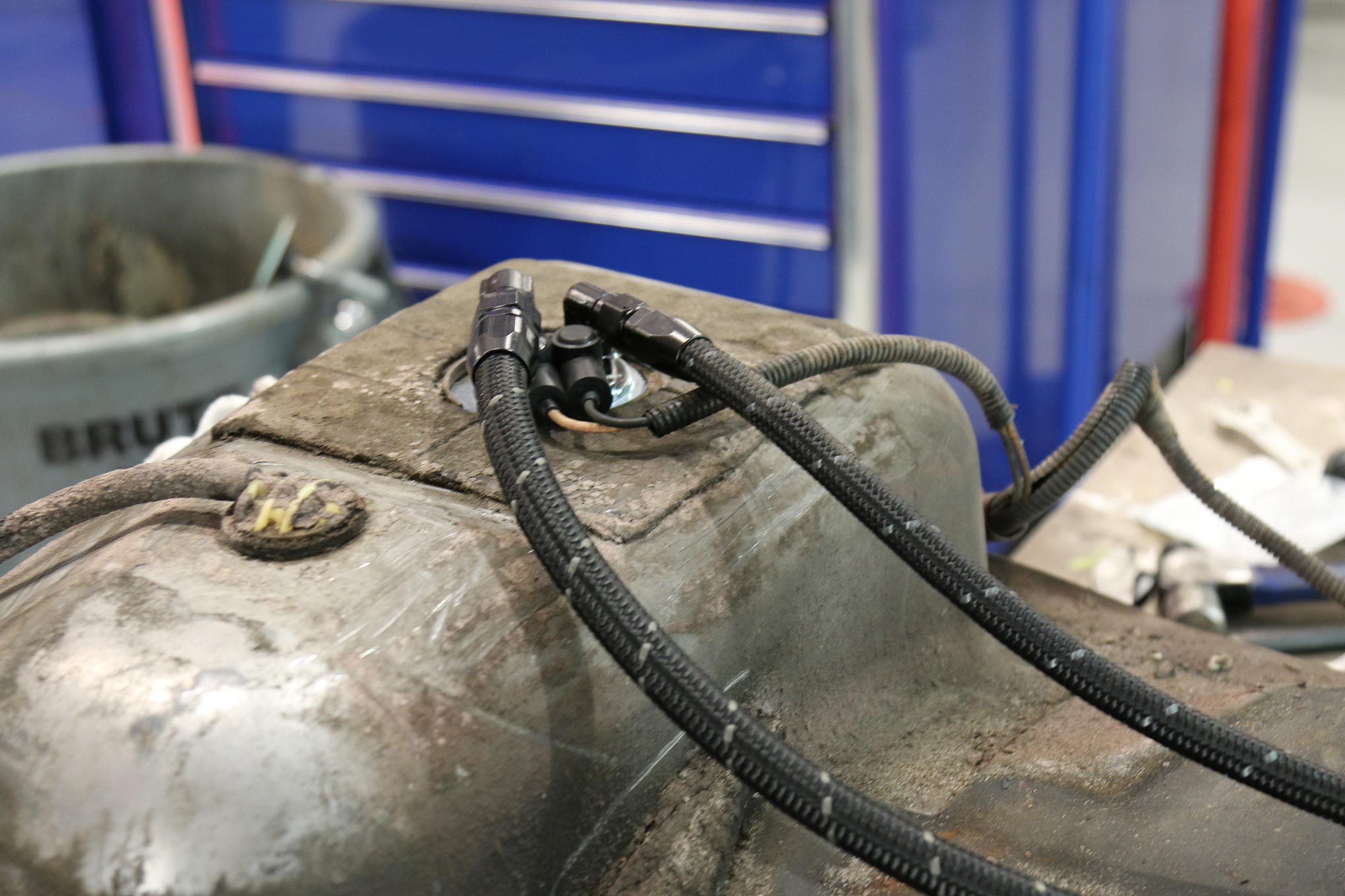

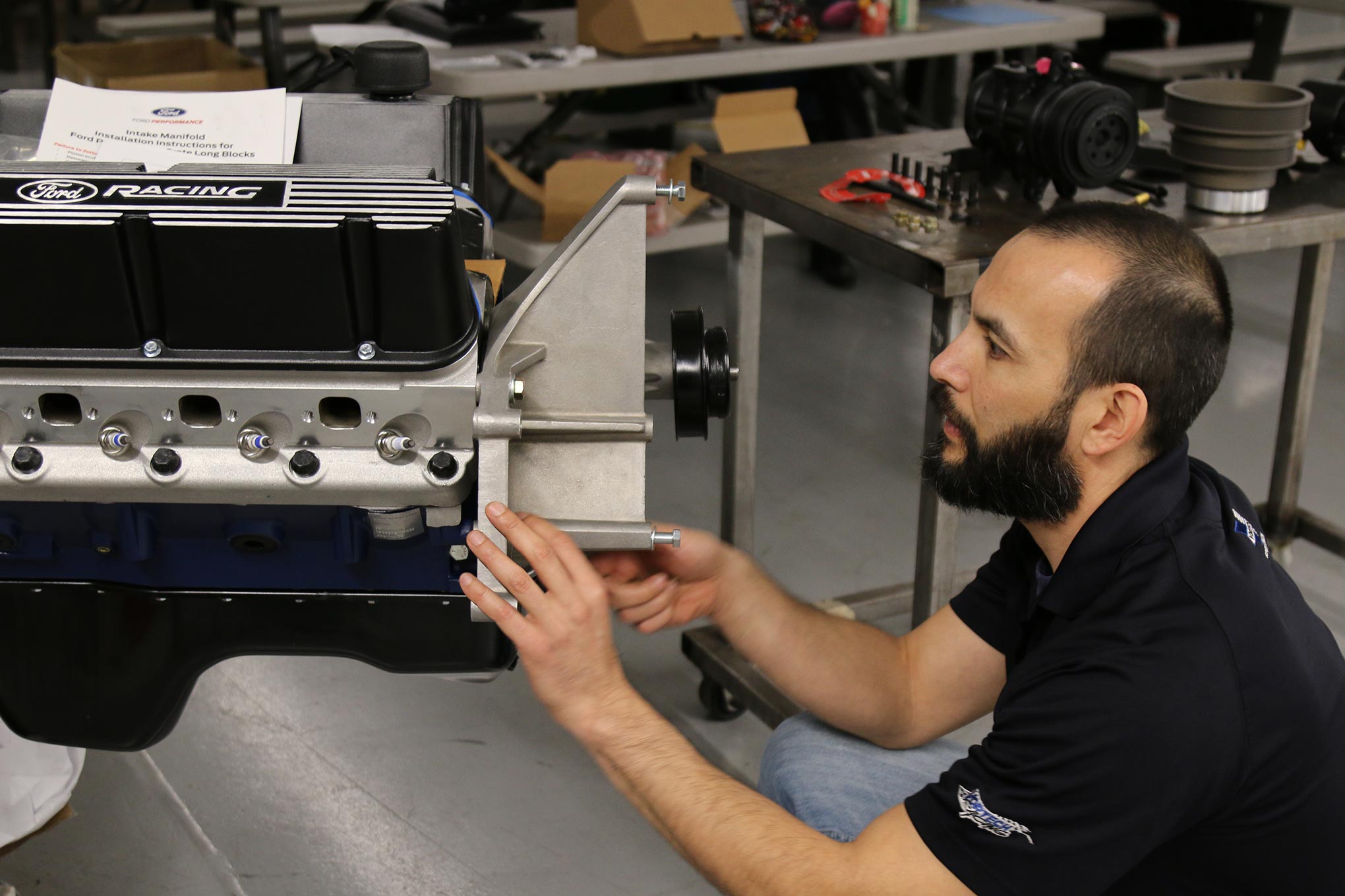

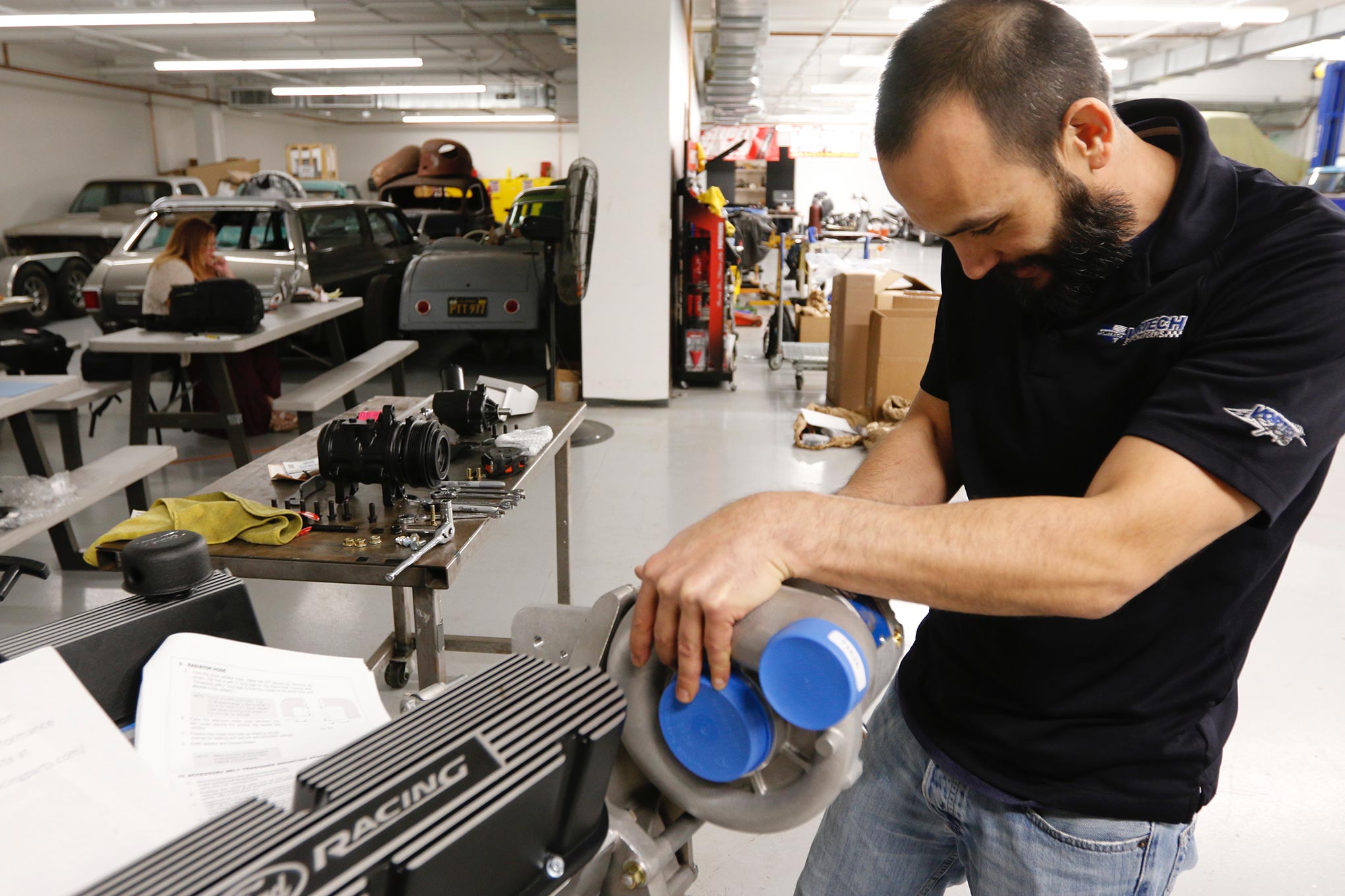

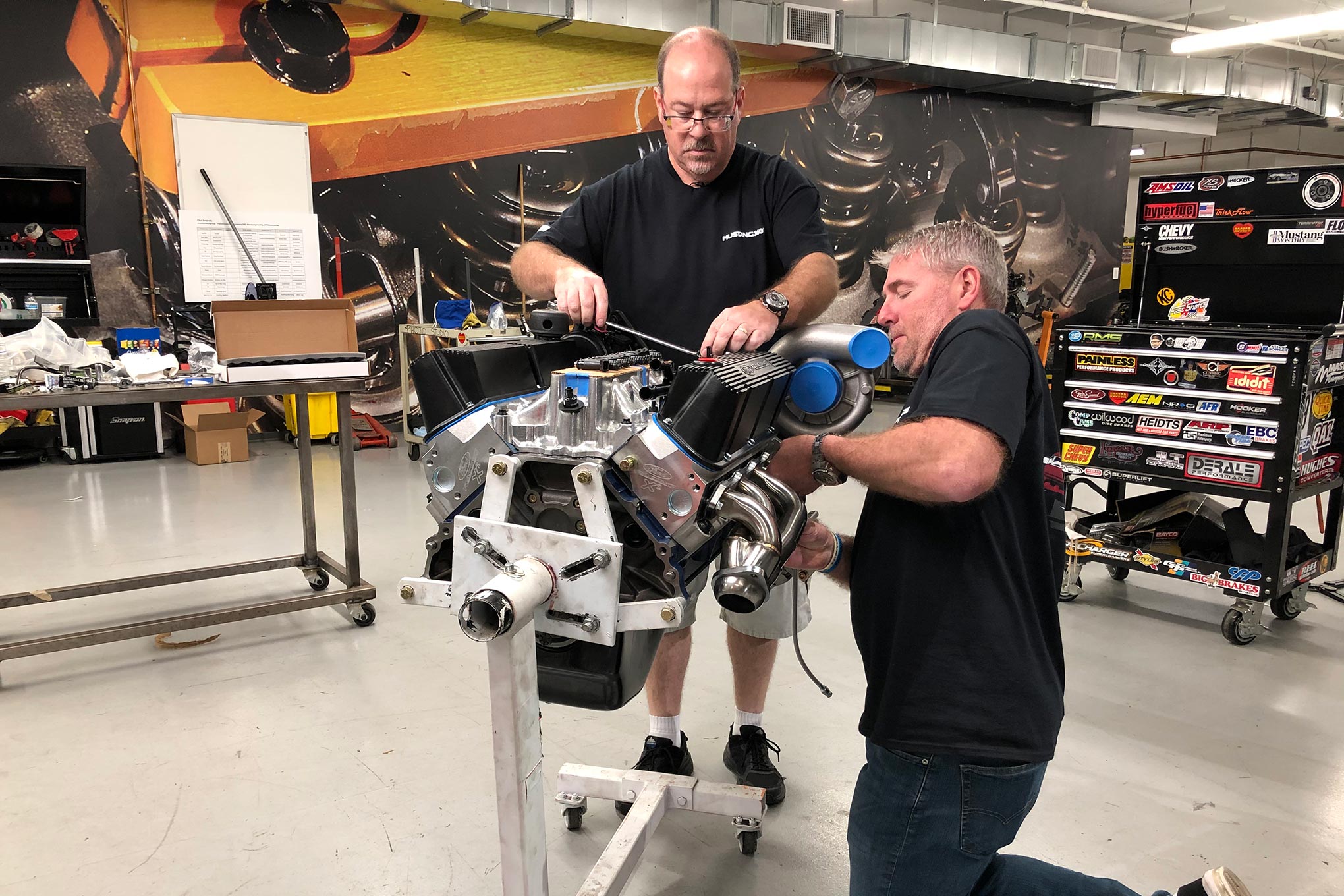

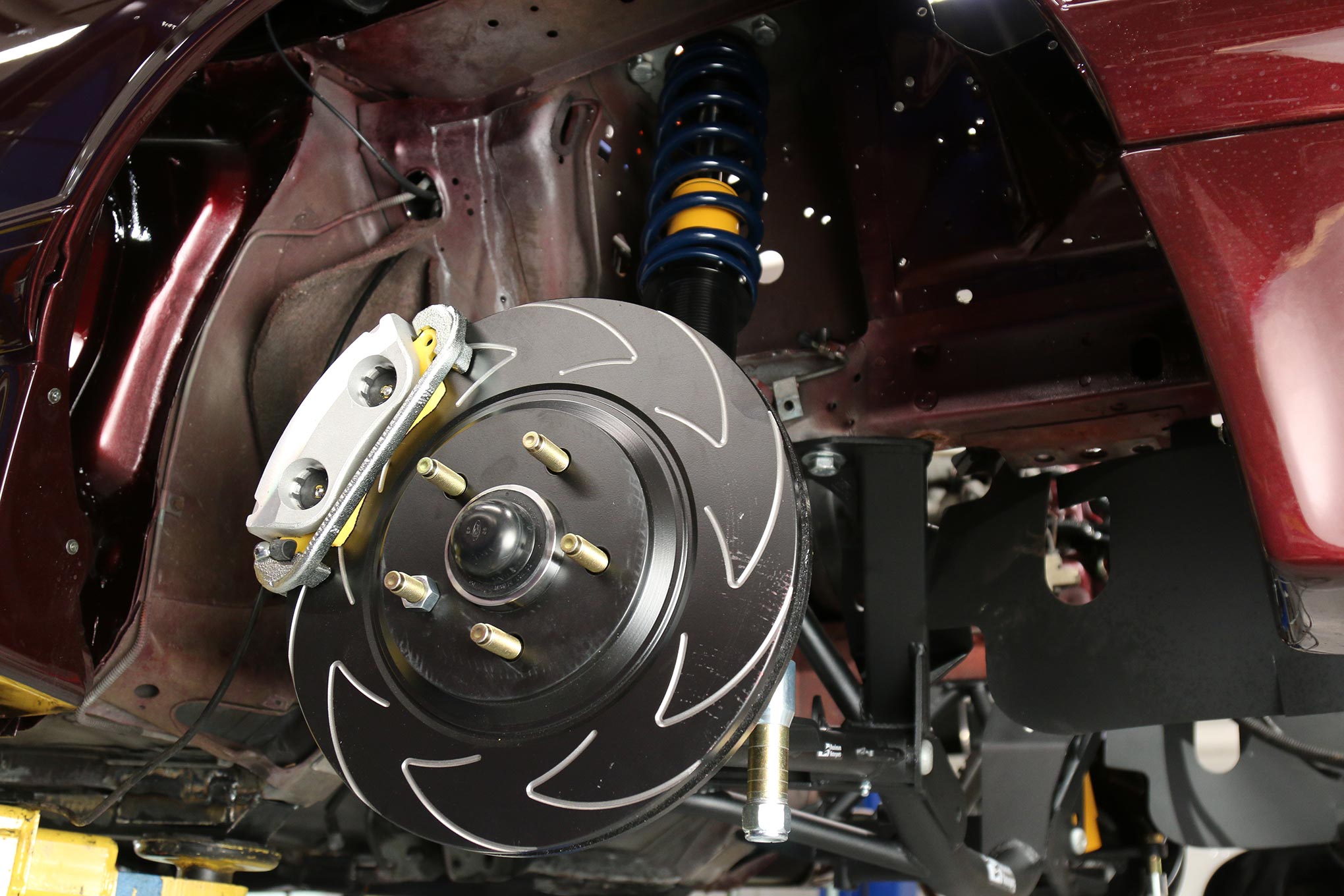

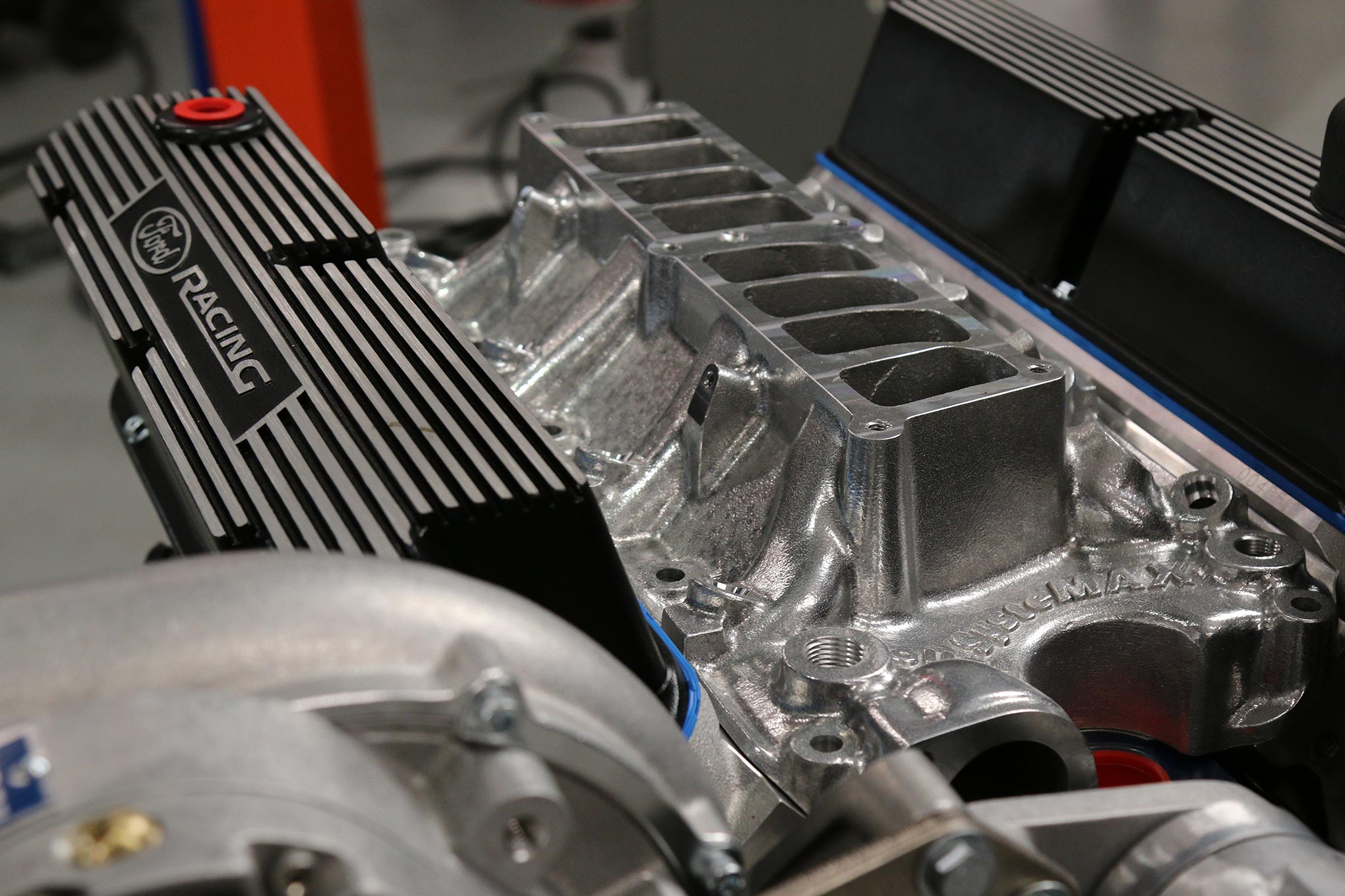

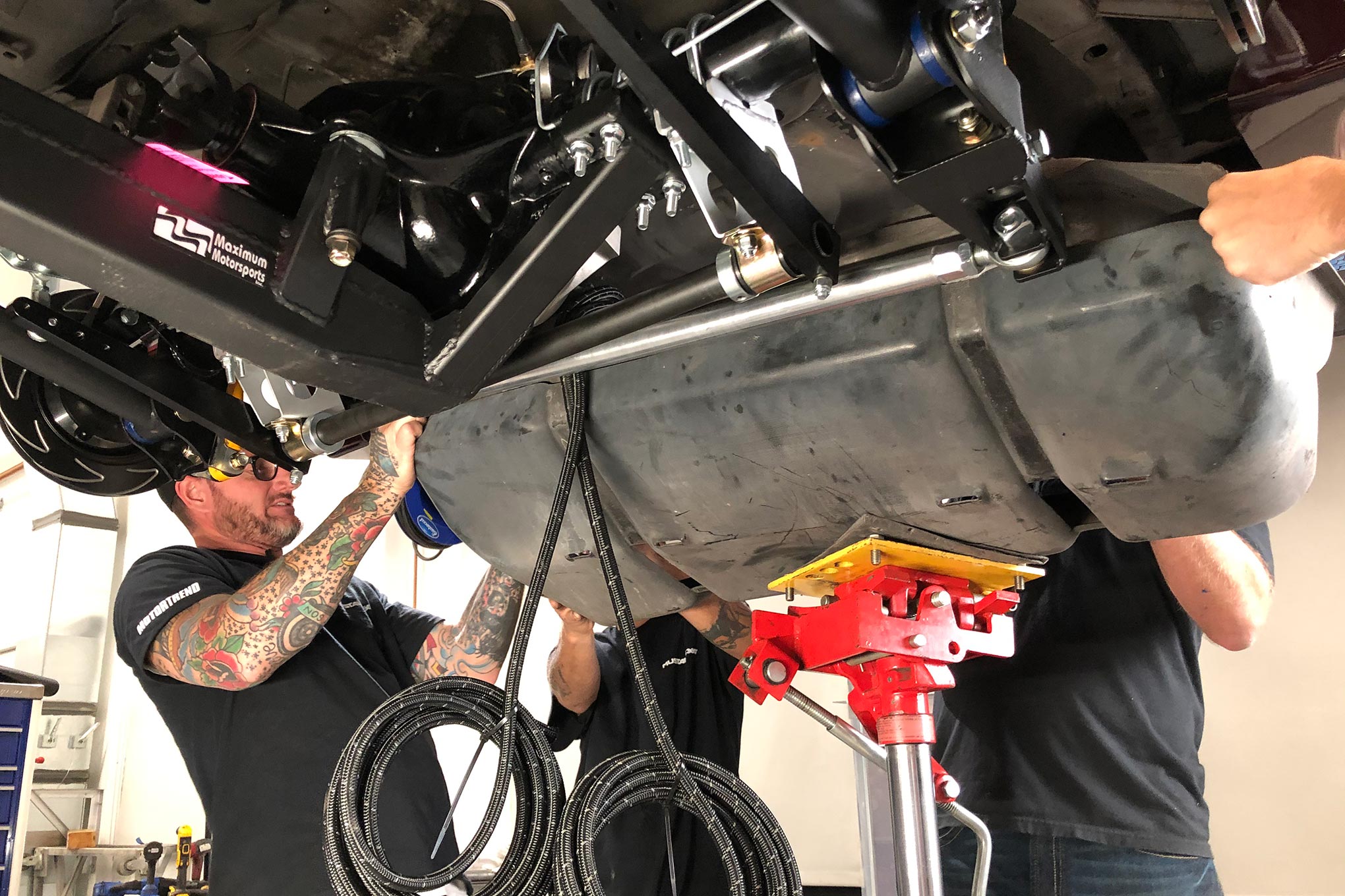

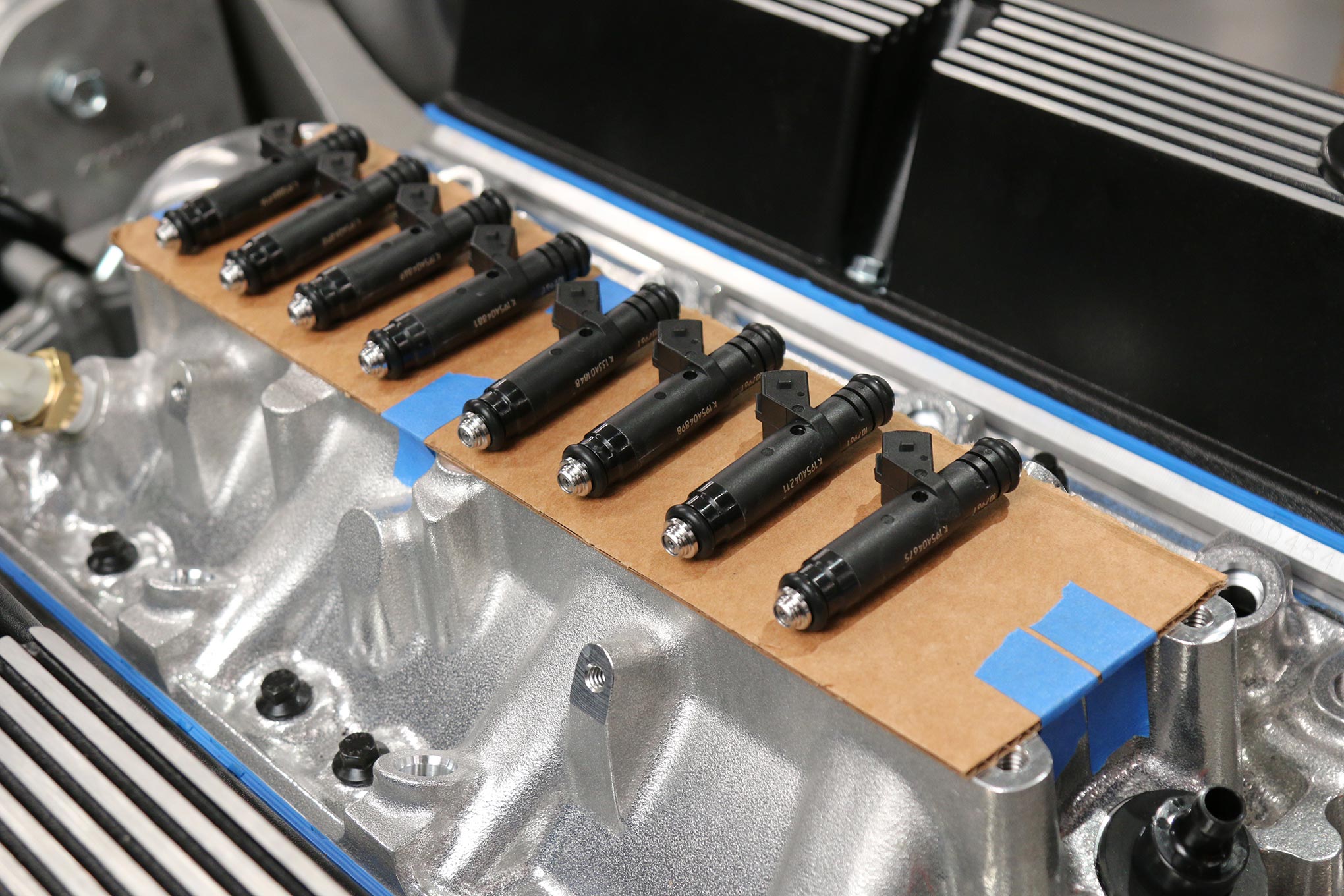

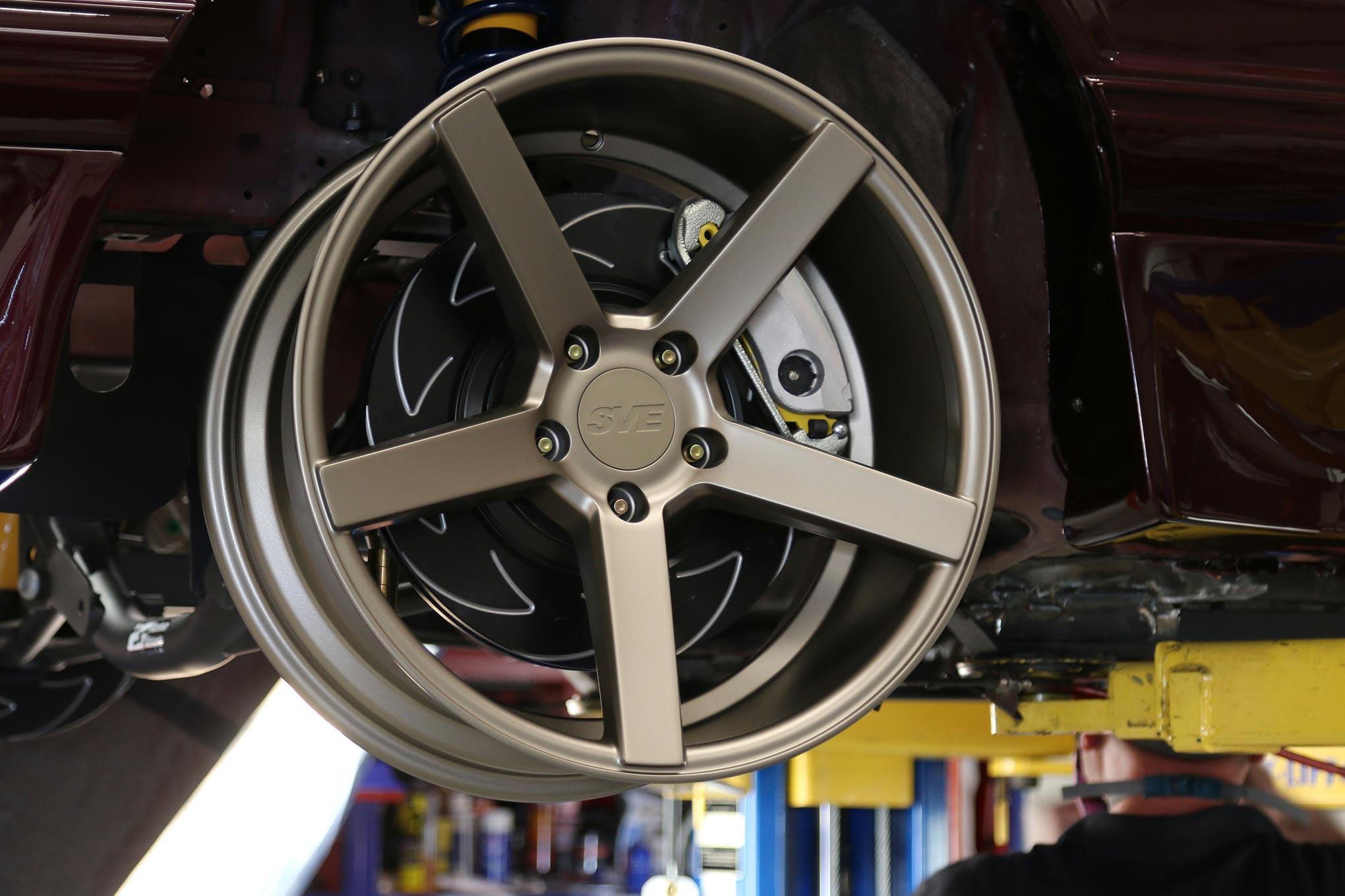

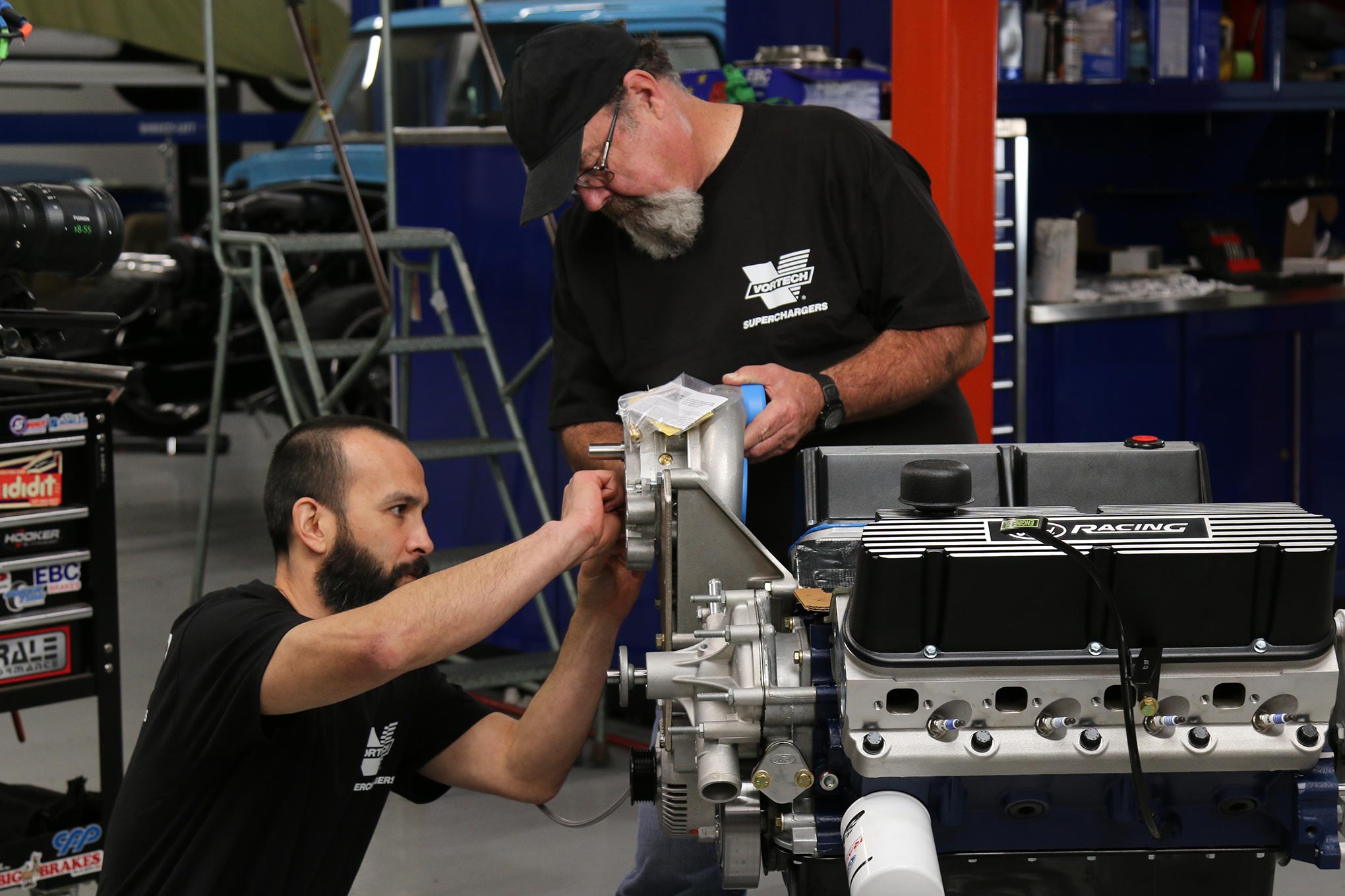

Maximum is providing the complete front and rear suspension setup, which includes a front K-member, control arms, sway bar, and Koni coilover struts, with EBC brake rotor and pads, and North Race Cars calipers, and at the close of Day 2 everything was installed and ready to go. While work under the car was progressing, the Ford Performance Parts crate motor was being dressed with accessories, Vortech V-3 Si supercharger, lower intake manifold, and injectors with fuel rails. The evening of Day 2 ended when Jason and Christian lifted the stock fuel tank back into place after installing and plumbing the new Aeromotive 340 in-tank pump.

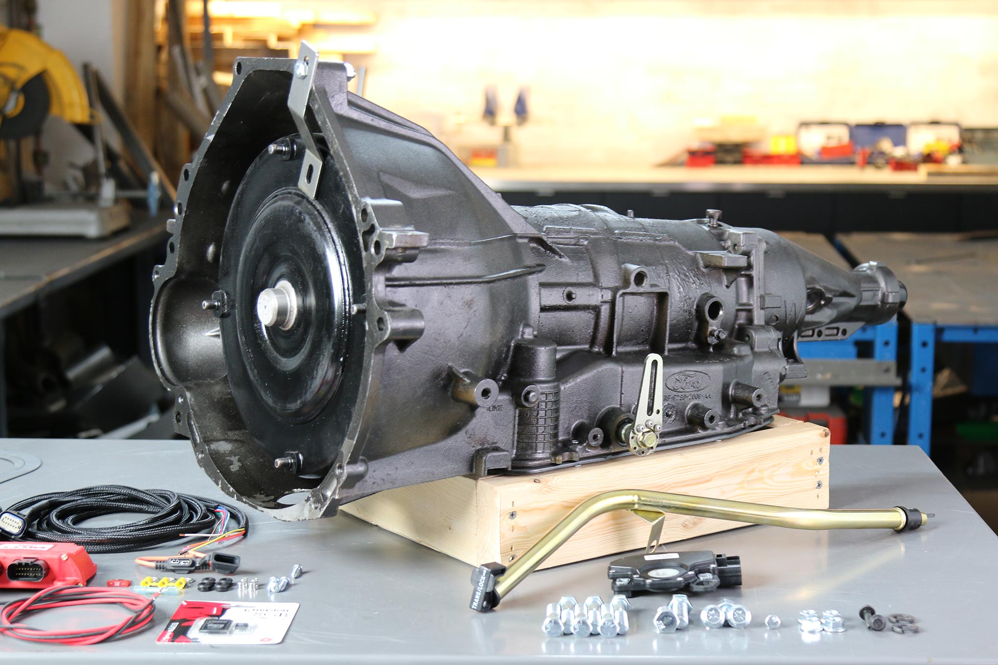

When we return tomorrow, it's time to stab in the Ford Performance Parts engine and Performance Automatic 4R70W transmission, at which point the Mustang will start looking like a complete car again. Thursday will see us turn our attention to the interior, and Friday will be spent finishing up loose ends, adding fluids, and firing the beast back to life. Keep coming back and see how we do!
