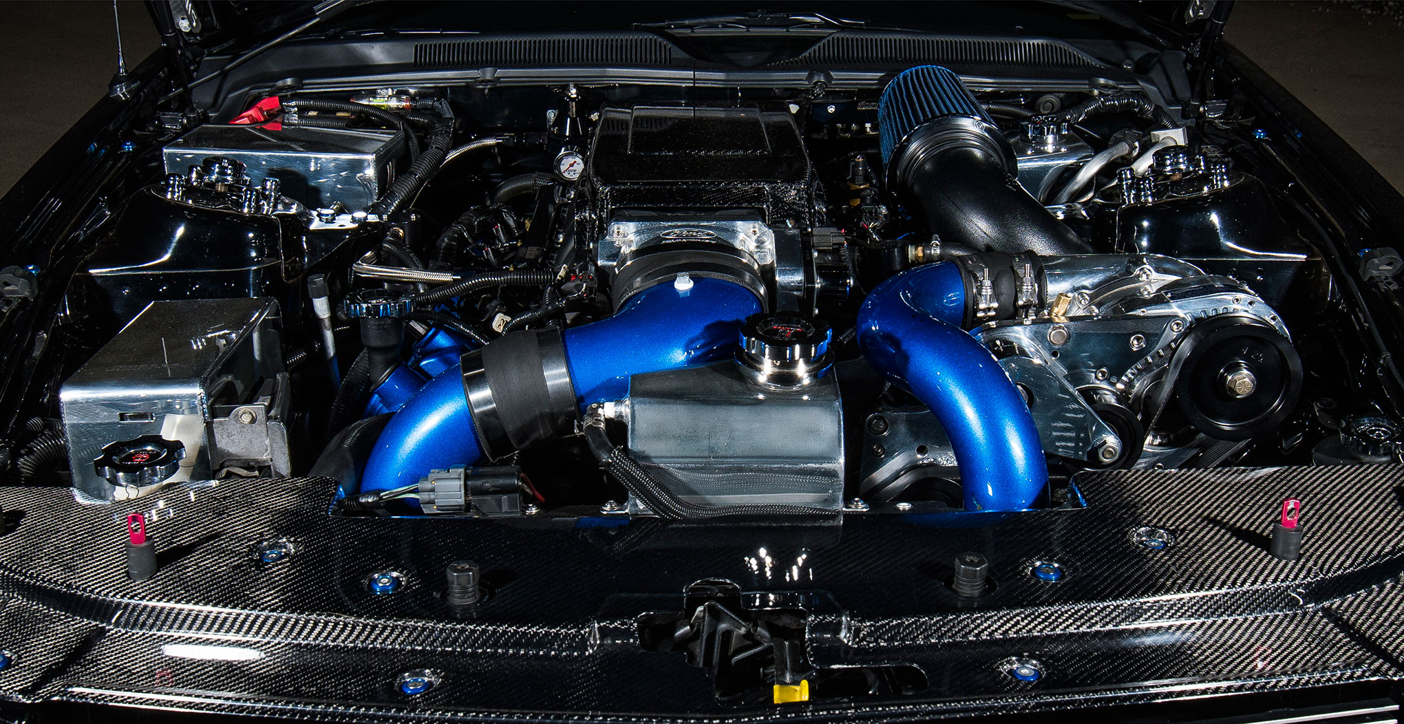

Under the hood you quickly see the business end of this Pony. A built Three-Valve 4.6L lives between the frame rails and is fed compressed air from an F1A centrifugal supercharger from ProCharger making 21 pounds of boost.
Gordon's build plan was centered around boost, but that meant the Three-Valve 4.6L needed some upgrades. For this, he turned to the experts at DSS Racing in St. Charles, Illinois. The factory Three-Valve block was filled with a forged Kellogg crankshaft, Manley Performance connecting rods, and DSS Racing pistons. The short-block was then stout enough to handle forced induction, but with the engine apart, the cylinder heads were in need of an upgrade as well. Gordon ditched the factory castings in favor of a set of CNC-ported Three-Valve heads from Ford Racing. The heads were finished off with a set of Comp Cams camshafts, measuring 0.549-inch lift on the intake side, and 0.546-inch lift on the exhaust. Duration at 0.050-inch life measured 238/246 respectively, with a 115 LSA.
Extra oxygen is force-fed into the engine by ProCharger's F1A centrifugal supercharger. The air charge goes through a custom intercooler before the 21 pounds of boost enters the intake manifold. With all the added air, the fuel supply needed to be upgraded to allow the engine to make all that extra power. Twin Walbro 465 fuel pumps supply fuel to a set of Injector Dynamics ID1000 fuel injectors, and fuel pressure is controlled by a Fore Innovations fuel pressure regulator. Once the air and fuel is mixed and the combustion process happens, exhaust gasses exit through a set of JBA 1 5/8-inch long-tube headers into a 2 -inch X-style mid-pipe. A set of Flowmaster Delta mufflers gave the S197 a super aggressive tone to match its equally impressive power output.

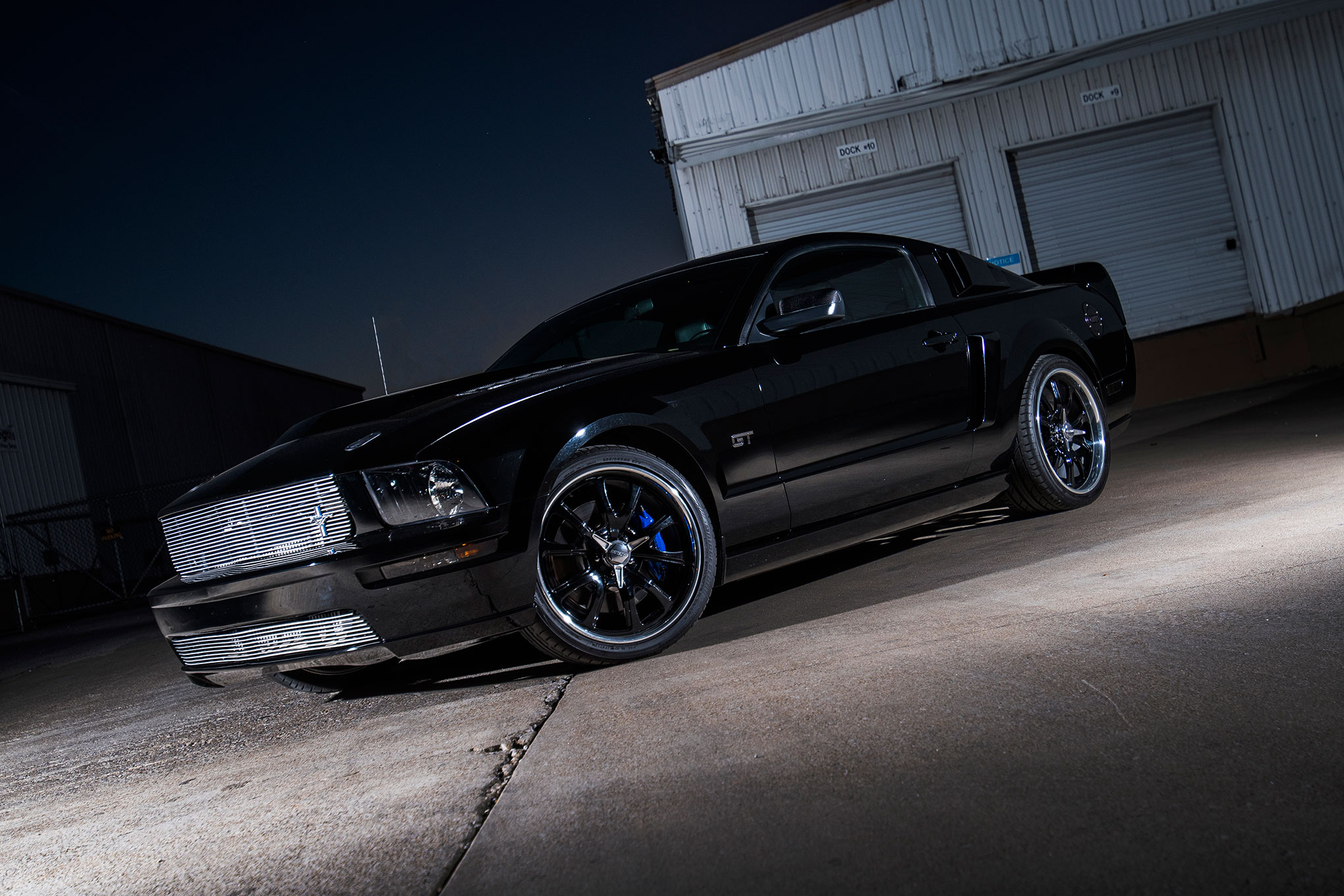

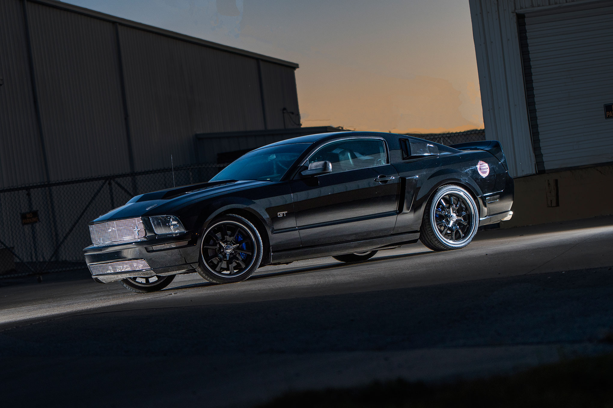

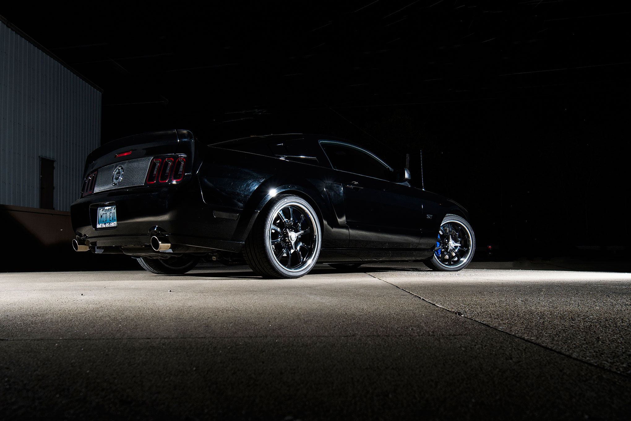

In a world of highly modified Mustangs, it's difficult to truly have a car that stands out in the crowd. Gordon's mix of classic good looks with modern touches works perfectly. The stance comes from a set of JDM Engineering drag springs and 20-inch Raceline wheels.
The factory ECU was remote tuned by John Lund of Lund Racing, all while the car was on the rollers at Finishline Performance in Milford, Ohio. The end result of this awesome combination was a stout 757 rear-wheel horsepower and 590 lb-ft of torque.

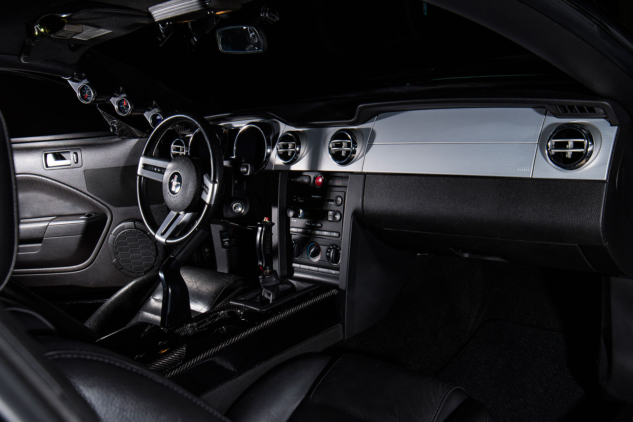

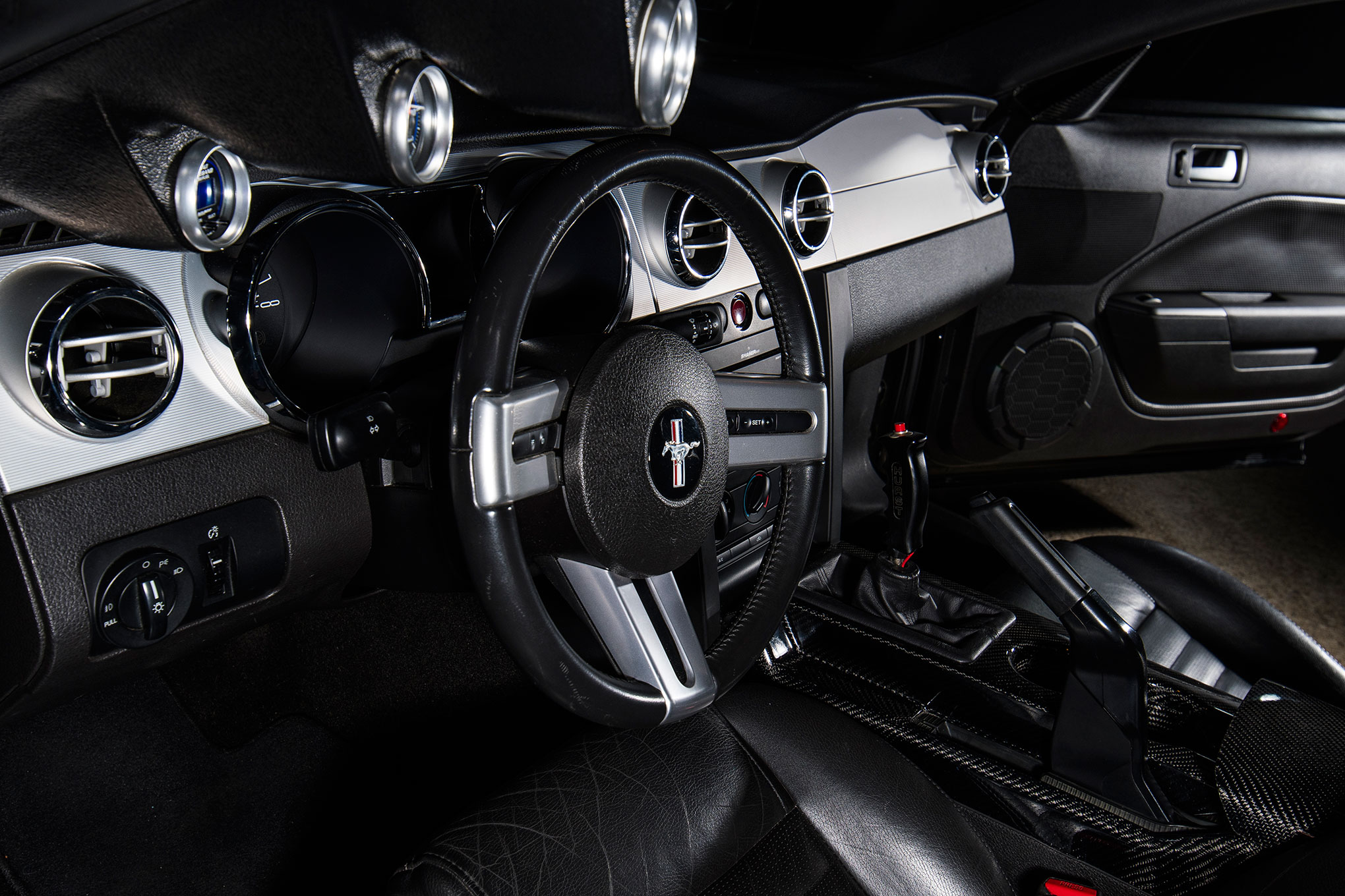

The driver's compartment is strictly business. The black leather interior is accented with carbon fiber touches. The Hurst short-throw shifter is the only hint that this is more than a mild-mannered Mustang.
Getting the power to the ground is a huge part of going fast. The car sits on a set of drag race springs from JDM Engineering, with a set of Tokico D-Spec adjustable shocks and struts. Twenty-inch Raceline GT wheels sit in all four corners with Bridgestone Potenza rubber connecting the car to the road. A set of GT500 front brakes help control speed and put the reins on this Pony when needed.

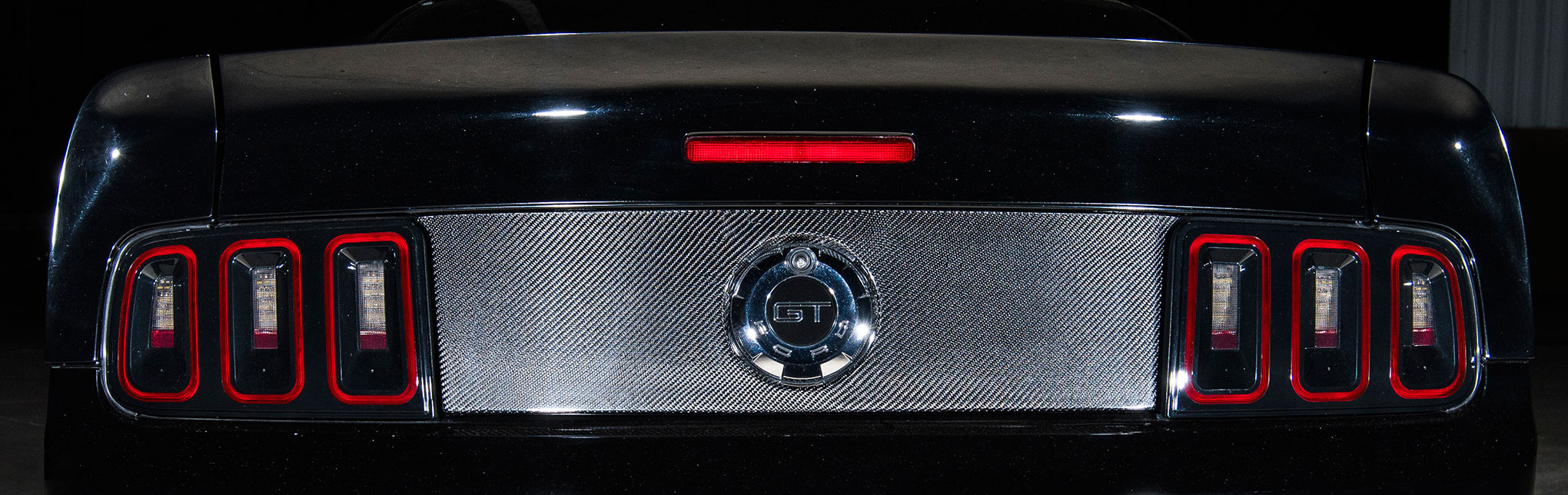

For Gordon, making power wasn't enough. The car needed to look the part as well. The exterior was upgraded with a Cervini's Eleanor hood with 2013-style TruFiber carbon hood vents. Gordon even fabbed his own aluminum surrounds on bottom side of hood to add an extra custom touch. Aerocatch flush mounted hood pins keep the hood secure at speed, and Cervini's upper and lower side scoops and ducktail spoiler complete the look.
The interior is by-and-large in stock form. Gordon added some tasteful carbon fiber accents to add a racy look that complements the Hurst short-throw shifter.
