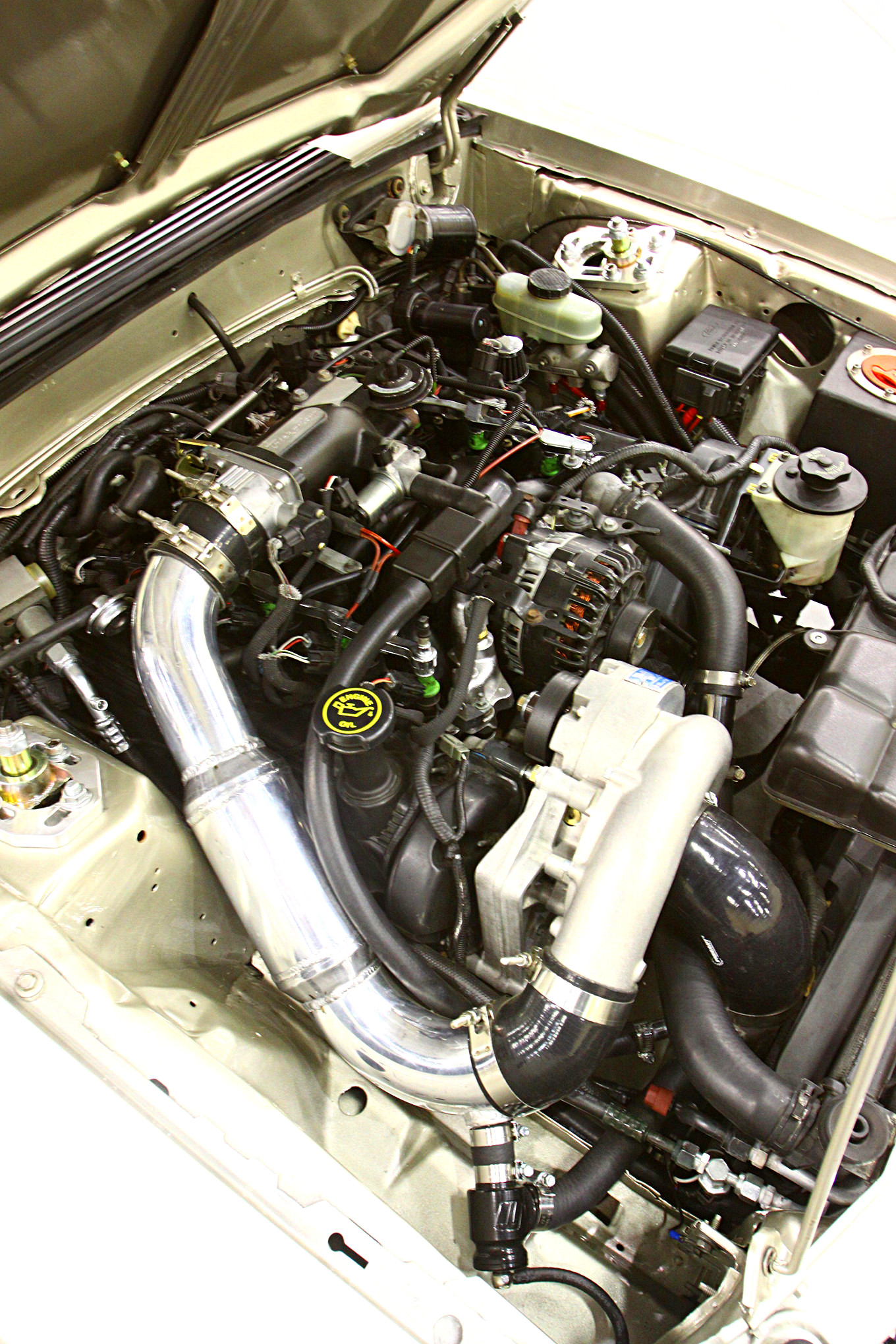

The basically stock Two-Valve 4.6-liter was dropped into the Pace Car's engine bay with its original T45 five-speed transmission still attached. The engine is held in place with the K-member from the 2001 Mustang. Extra power came from a Vortech supercharger that pumped 11 pounds of boost into the factory 281. During the swap, the clutch was replaced, and aftermarket exhaust was installed to complete the swap.

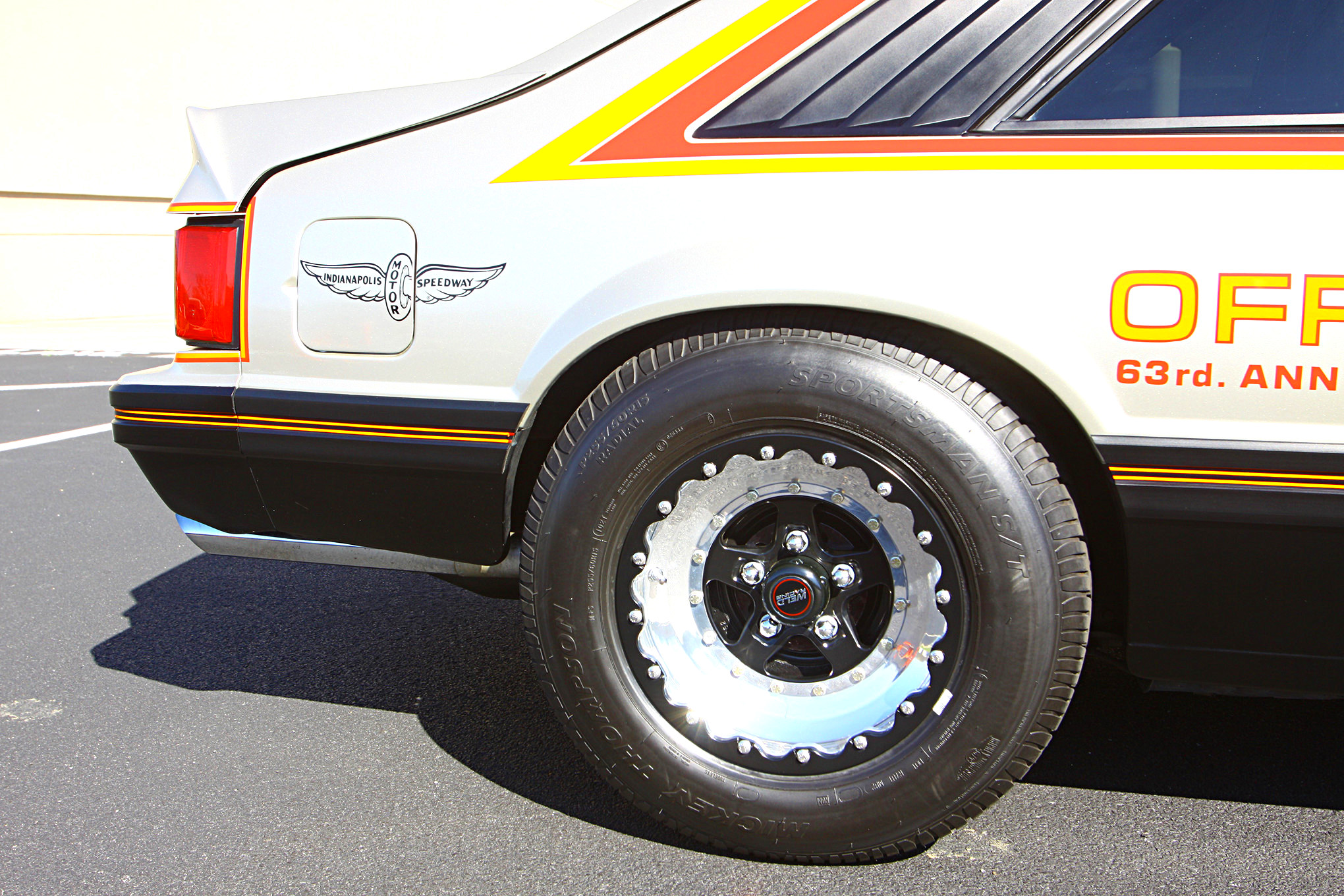

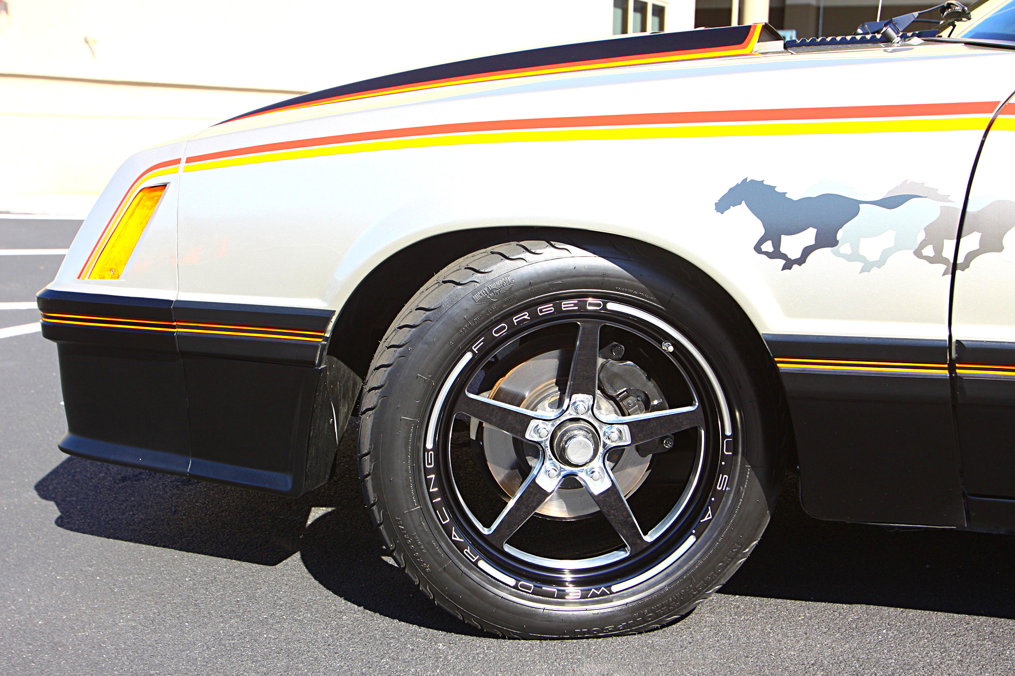

"We got the car on November 29th, 2017," explains Dylan Neuenschwander. "We got the car with the intention of racing it, so the first thing we did was prepare it. We took out the stock [7.5-inch] rearend and replaced it with a built 8.8-inch housing." The new rearend was packed with Strange Engineering axles and spool. The four-lug setup was ditched in favor of stronger five-lug axles. The drum brakes were also replaced new disk brakes from Aerospace Components. Adjustable upper and lower control arms replaced the factory links, and a driveshaft loop was installed to add a bit of extra safety. The initial race prep was completed with a set of drag radials, a Hurst line lock, and a short-throw shifter. In this configuration, the car went a best e.t. of 11.95 at 116 mph.
"We recently removed the intercooler blower pipe and replaced it with a non-intercooled pipe for more air flow," Dylan tells us. "We also put a G-Force Transmissions' G101 transmission with a Long shifter, a QuickTime bell housing, Spec clutch in the car. With this setup we've run a best of 11.56 at 123 mph.
