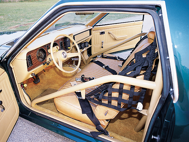

For three years Sharer dealt with the faded factory paint, but he straightened the lines and sprayed the tired body with three coats of factory Jade Green Metallic followed by three coats of clear. Wanting to fly under the radar, the Fairmont retains a stock profile--including the bench seat and flat hood (which is fiberglass). In the name of strength and safety, Mike Duffy Race Cars of Moore, Oklahoma, added frame connectors, a rollcage (color coated of course), and a bevy of Auto Meter gauges, some of which are hidden in the glovebox.

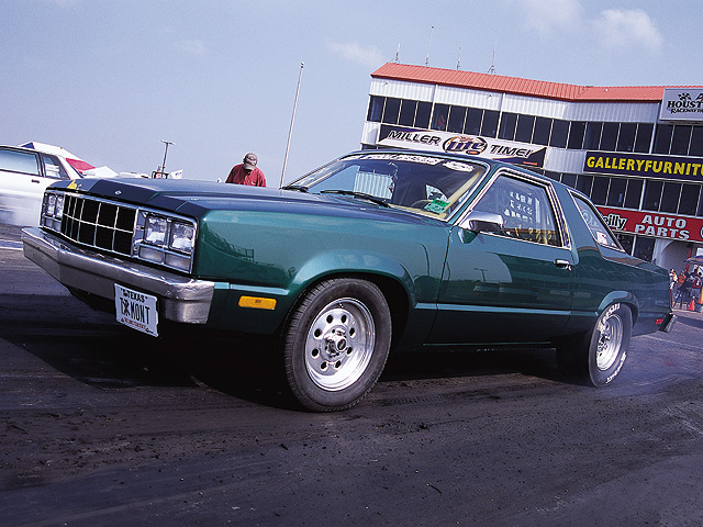

With Sharer strapped tightly in place, the Fairmont weighs 3,175 pounds and has been clocked at 9.86 at 138 mph. However, Sharer is in the process of swapping out the 2,300-rpm torque converter for a looser 3,200 model in search of quicker times.

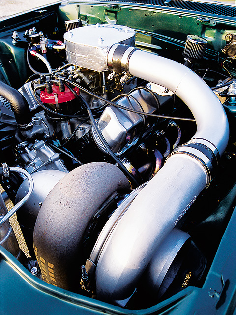

"I wanted a cheap and unique car that was quick and would turn some heads. I got bored with the twin setup so I switched to the 83mm turbo and a larger down pipe. More recently, though, I went with a Majestic Turbo T-76 compressor and a 5-inch down pipe. And when I get the converter sorted out it should make 15 psi and run 9.50s at 140 mph."

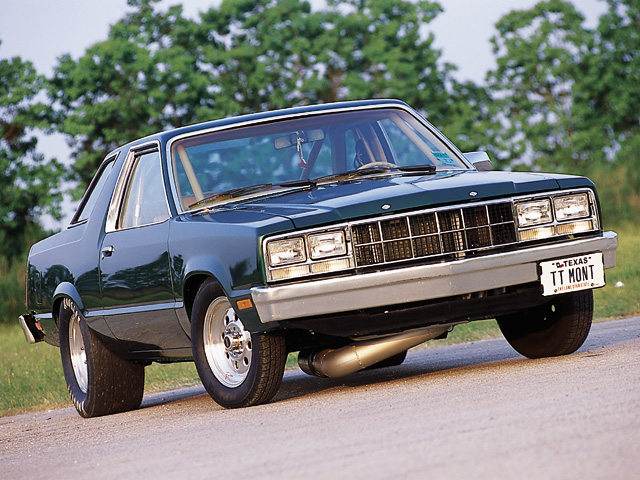

Bryan Sharer's '78 Fairmont Futura has a cool stance, but it doesn't necessarily look like a 9-second player. Nevertheless, some may question the monster 5-inch down pipe hanging under the nose.

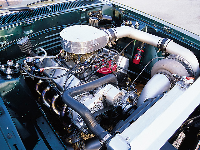

Stock-block 302 sports 9:1 pistons, E-303 cam, and is topped with World Products' Windsor Sr. heads along with a Weiand X-CELerator intake and a Holley 600 Double-Pumper. During this photo shoot the Ford wore an AiResearch 83mm turbo and homemade inlet system, but that was recently swapped for a Majestic Turbo T-76 compressor that makes 15 psi.
Bryan Sharer stands tall in front of his 9-second Fairmont Futura.

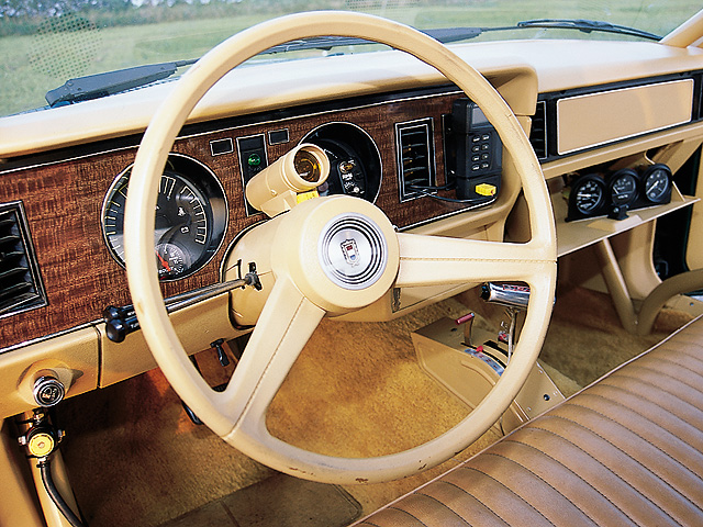

An Auto Meter tach hides in the stock speedo pod while a boost gauge was stuffed on the opposite side.

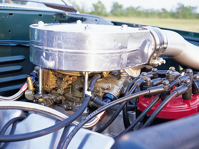

A custom aluminum carb bonnet seals to the top of the Holley carb. Fuel is fed by a Mallory pump at 7 psi, is regulated by a Mallory regulator, and is bumped up 1 pound per every pound of boost.

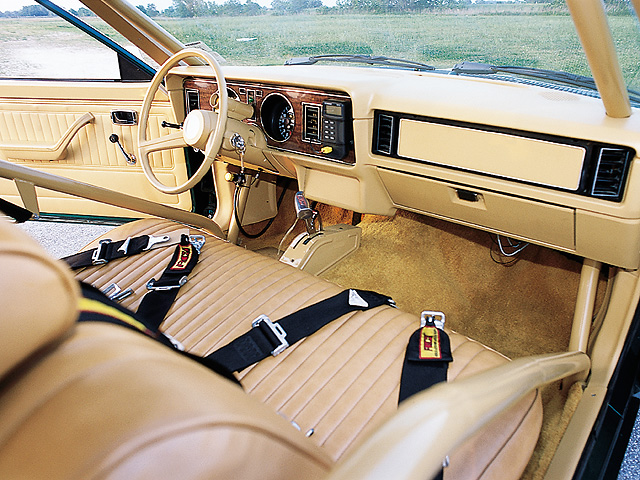

Staying true to the sleeper theme, Sharer painted the rollcage to blend with the tan bench seat, dash and carpet.
A new ACC carpet was laid into place and then Sharer handled the small details like painting the shift light and shifter housing to blend in.
Upwards of 15-psi is pumped through the Holley 600 DP carburetor that's been modified with a milled choke horn, jet extensions, and solid floats. In addition, Sharer applied epoxy to the choke linkage hole. Ignition is from MSD and fires the Autolite #23 plugs, which are gapped to .030 inch.

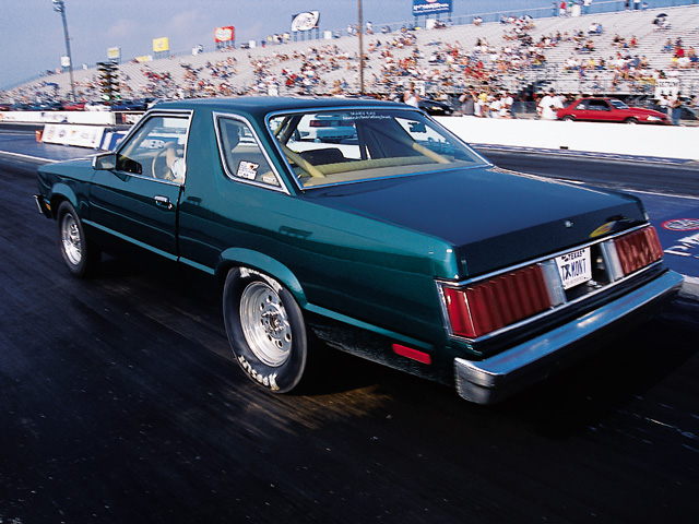

Sleeper Ford rides on Hoosier Quick Time Pro tires wrapped around Weld rims.
