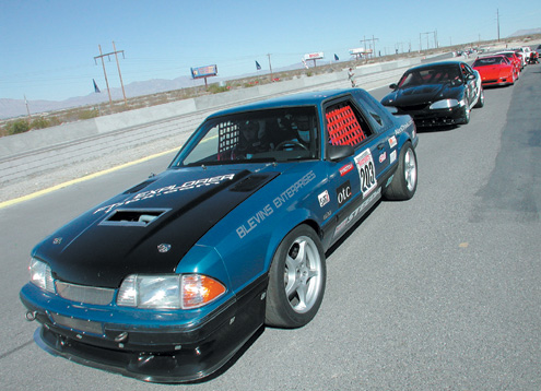

P175553_large Ford_Mustang_GT Front_Driver_Side
Old Fords never die. Befitting their status as inexpensive project machines, the Mustangs that showed at OTC tended to be heavily modified Fox-chassis’d track cars. All ran in the Unlimited classes, including this clean coupe of Jonathan Blevins and Alan Chavez, which finished 18th overall (combined Unlimited and Touring scoring). Behind it is the ex–World Challenge Howe chassis tube-frame “Mustang” campaigned by Monroe Roden, Wayne Manor, and Mark Bettin. Their week was marred by numerous mechanical issues, but things were better by Las Vegas.

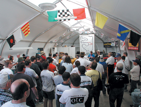

P175570_image_large
Each day began with a drivers’ meeting so everyone would be driving in the same direction, know where the pits were, and all that. We particularly enjoyed the way NASA handled the often-troublesome open-track passing situation. Instead of setting up elaborate passing and no-passing zones, the rule was simply no passing under braking, and it worked beautifully. On-track courtesy was excellent, and balking by slower cars simply wasn’t an issue.

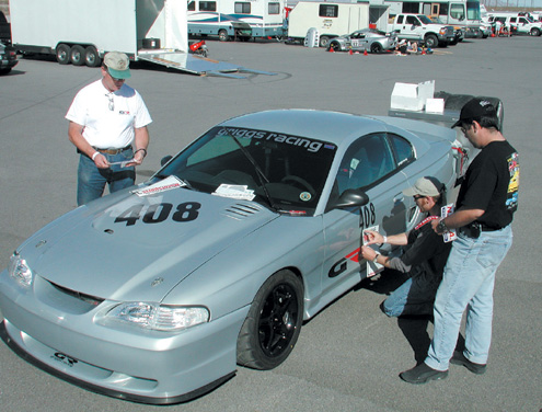

P175571_large 1994_Ford_Mustang_GT Front_Driver_Side
The only other car besides our own in American GT was this positively thumping ’94 GT prepped by Bruce Griggs for owner/driver Paul Mashouf. The 408 number denotes the displacement of the full-house 13:1 compression 351W underhood. The car also carried a coilover GT-40 suspension, massive brakes, a Griggs front bumper cap/air dam and rear spoiler, a T56 gearbox, and an “itty-bitty clutch,” as Bruce put it. Turns out Paul was packing a super-light, three-plate clutch that allowed the big Windsor to rev like a sprint car but gave the team the jitters about driving in traffic as wheelspin was required to get moving from a dead stop. Some street car! Bruce rode shotgun for the entire event, the pair pulling a tiny trailer with spare tires and a few tools. About 8 seconds a lap faster than our barely warmed-up 4.6 Two-Valve, Paul handily walked off with American GT and really scared the trailered cars. He finished 10th overall against slick-shod Vipers and full-race Porsches. It was the third fastest of all Touring cars.

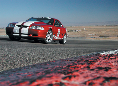

P175572_large 1996_Ford_Mustang_GT Passenger_Side
We enjoyed the new Spring Mountain track at Pahrump. Used mainly as a school track by Rupert Bragg-Smith’s driving school, it’s a bit tight and relatively flat, but the combination of large and small curves against the relatively featureless background made judging braking and turn-in points a challenge. The track is a couple miles south of town and right by the highway.

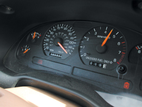

P175573_large 1996_Ford_Mustang_GT Dash_Gauges
Thanks to 3.73 gears, the speedo is a bit optimistic in our open tracker. Still, there was plenty of this sort of Fifth-gear action during OTC week.

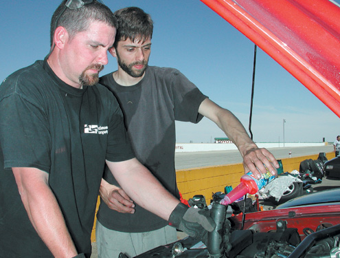

P175597_image_large
Another hot-weather trick is to add Redline Water Wetter, as Paul and Ehren Van Schmus are doing here. Nothing really seemed to move the 4.6’s water temp down, though, and we finally concluded it was simply hot at around 100 degrees F ambient. The engine didn’t seem to mind either, as its power output and smoothness didn’t change with the heat.

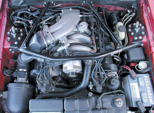

P175600_large 1996_Ford_Mustang_GT Engine_Bay
When something is shiny on a daily driver engine, it’s usually new. Our alternator was quickly new twice toward the end of the OTC as it came apart under the high-rpm running. This would have been a great time for some underdrive pulleys.

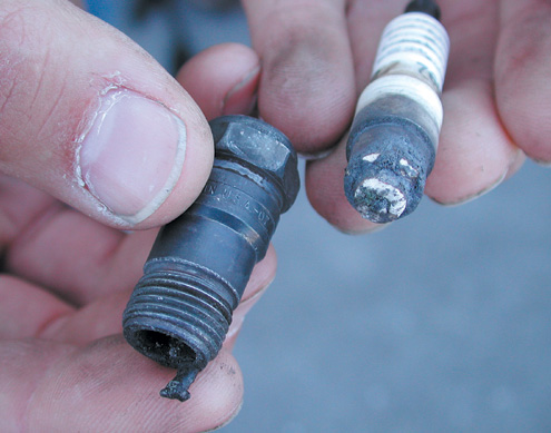

P175611_image_large
This rather tired, two-piece spark plug was a real surprise. To make a long story short, we discovered the FRPP heads on our 4.6 use a fully threaded spark plug, unlike the half-threaded stock 4.6 plugs that someone put in our engine. Once we got that little number figured out after the OTC, our 4.6 ran considerably better!

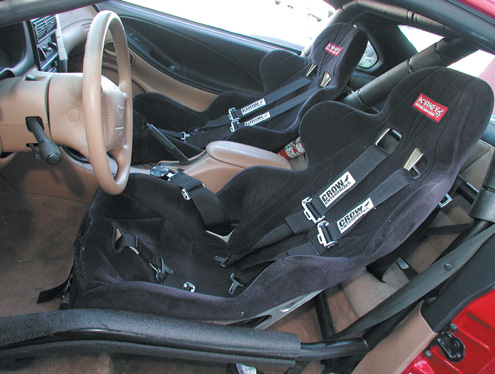

P175613_large 1996_Ford_Mustang_GT Racing_Seats
Going into the OTC, we knew our deep Kirkey aluminum seats would be superb at the racetrack, but could we spend 2,000 miles in them on the long freeway hauls? Turns out we easily could, the seats proving surprisingly comfortable. The extended lower-leg support means you can’t sprawl as in a conventional seat, but the stout support in the seat and lower back proved more comfortable than the compressible cushions in a regular Mustang seat. They’re definitely cumbersome around town when getting in and out at the gas station, then the ATM machine, followed by the market for food and ice, but on the long hauls they’re great.
